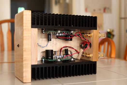

Amp Camp in our house
Some time ago, my daughter was working on her "circuits" unit in science class. She was telling me about the fun she and her friends had making light bulbs light up, etc with a small battery circuit. So, I got out my my Snap Circuits kit and we played around for the afternoon making all kinds of circuits. The one that she thought was the most fun was the radio that we built.
Seeing all of the fun she had building some circuits, I spent the next few weeks gathering all of the parts necessary for an Amp Camp Amp and and a small pair of speakers. I also spent a few days cutting and finishing a nice piece of hard maple for the chassis and drilling holes (I used the 2U sinks from the DIYAudio store) and routing holes in the speaker cabinets.
Fast forward a few weeks to her birthday. She was thrilled to unwrap a box full of little electronic parts and pieces. This past weekend, we spent the afternoon putting it all together. She bent all of the resistor legs, populated both boards, and helped me solder everything in place. After each part was in place, she clipped the legs off. We mounted the boards to the sinks and then attached the sinks to the wooden pieces for the chassis. We did a quick adjust to the pot (man, that is a REALLY sensitive adjustment) and then moved on to the speakers. I got her a pair of Mark Audio CHR-70 drivers (thanks to Planet10 for the suggestion!) and we put them in the Parts Express 0.25 cu ft cabinets. Finally, it was time for a listen. What a GREAT sounding little system for her iPod and MP3 player!
It's too bad we couldn't travel to California for Amp Camp to be with everyone, especially the master himself! But we brought a little bit of amp camp to our house for my daughter's birthday! Thank you, Nelson, for sharing another great design with all of us!
We had a great time working together and she has the satisfaction of knowing that she helped build her new stereo. It is the perfect size and power for her bedroom. I told her to be sure to keep an eye on it - I think it sounds so nice that I might just take it to work with me
Pics are below.
