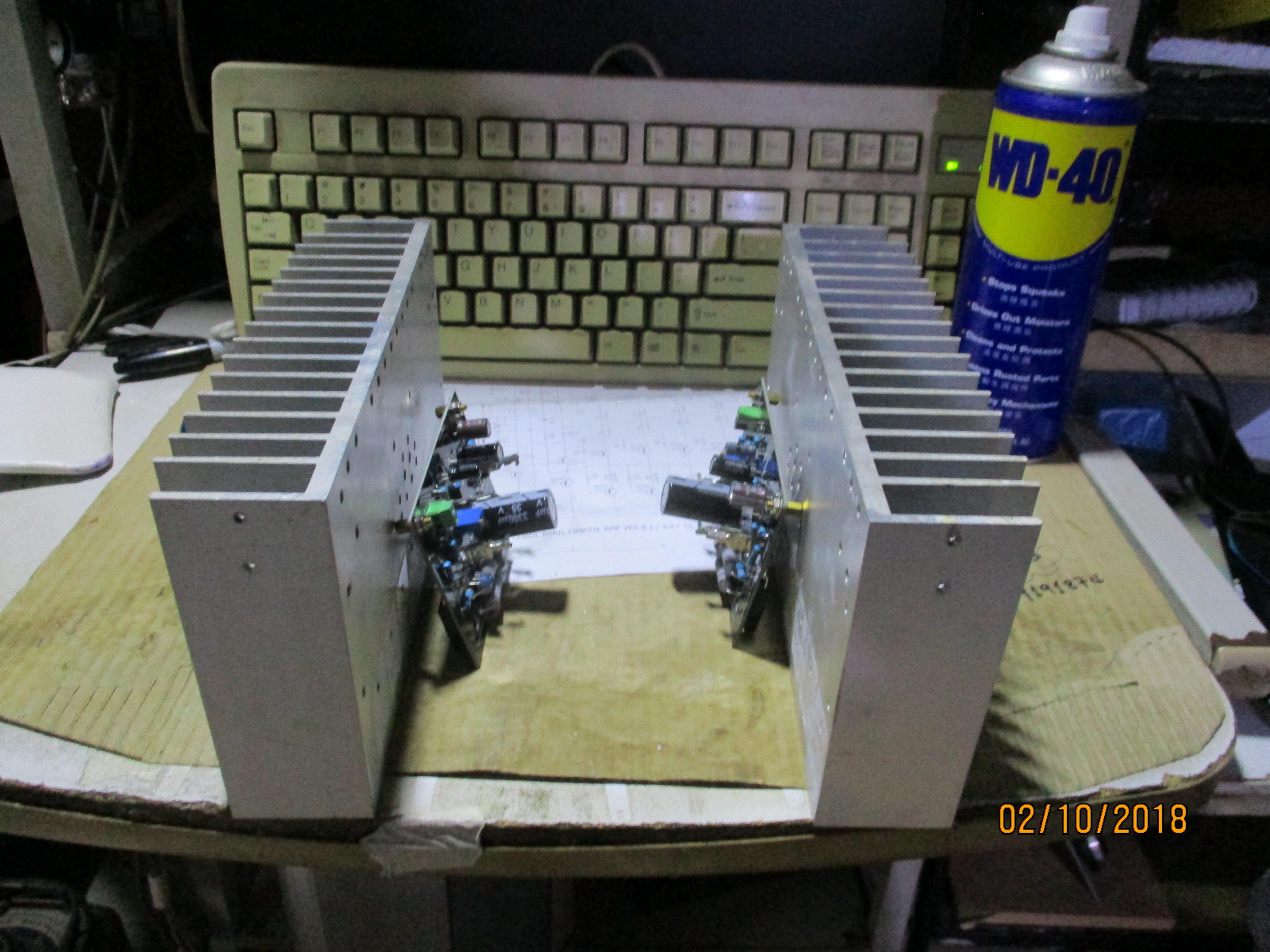

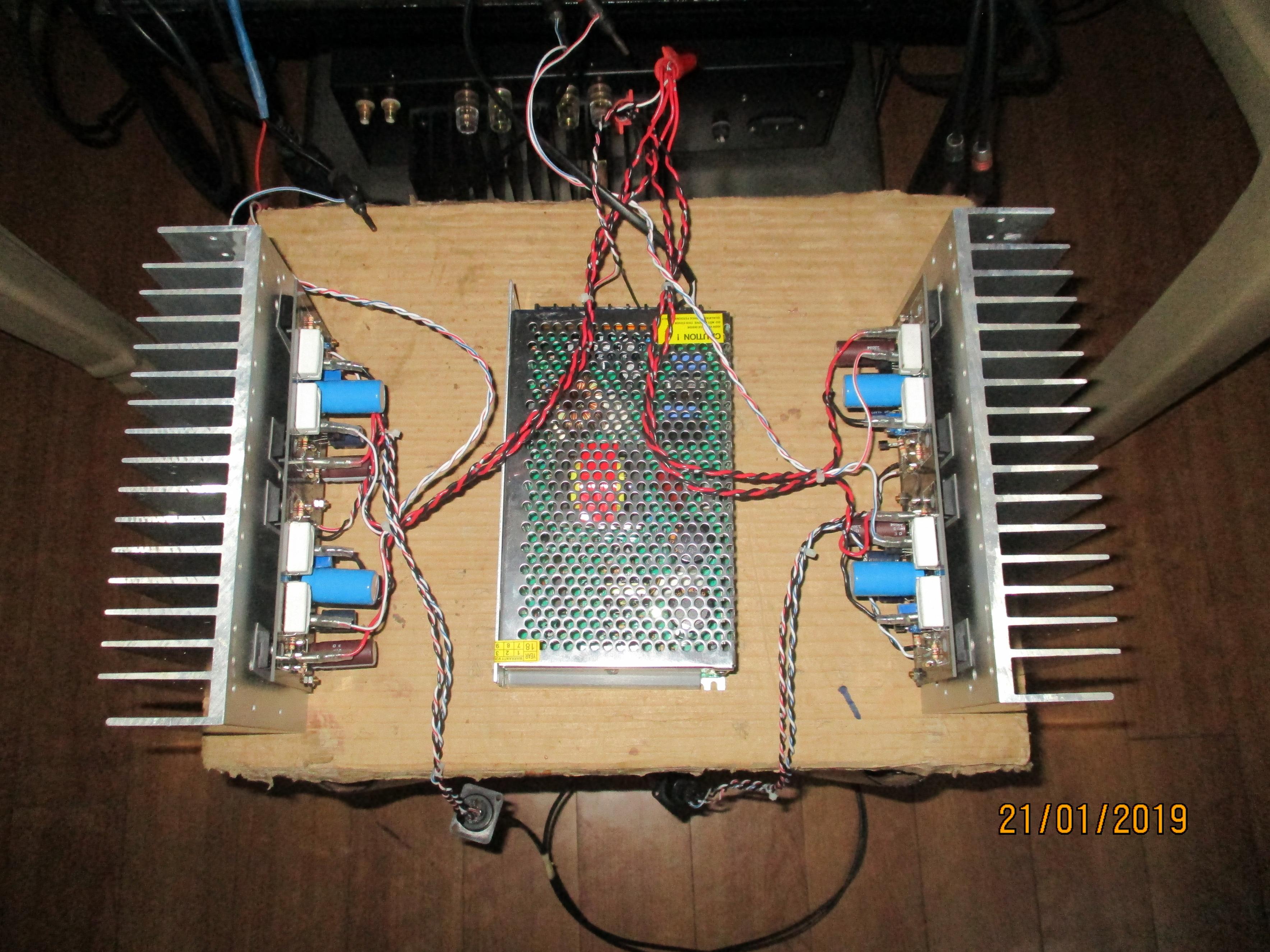

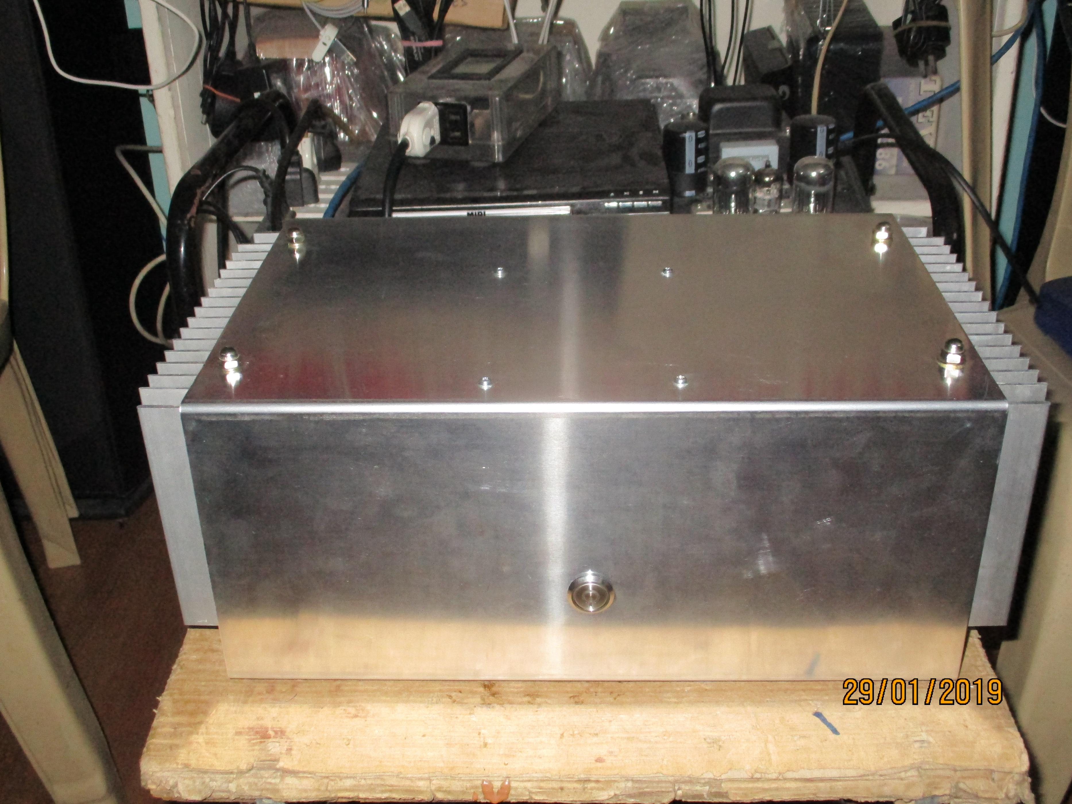

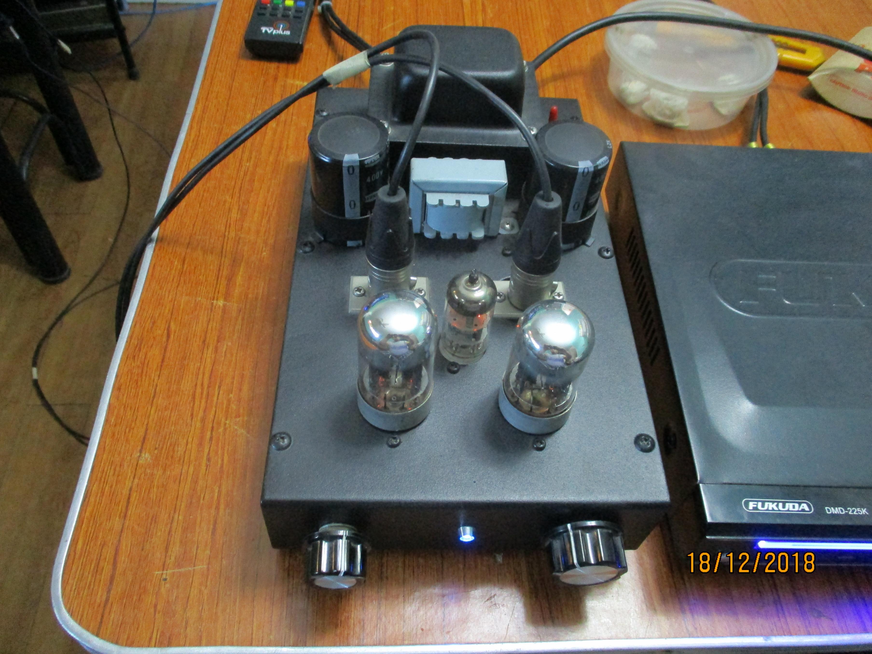

as a matter of fact i did that, with an Impasse wannabe preamp with XLR outputs...
