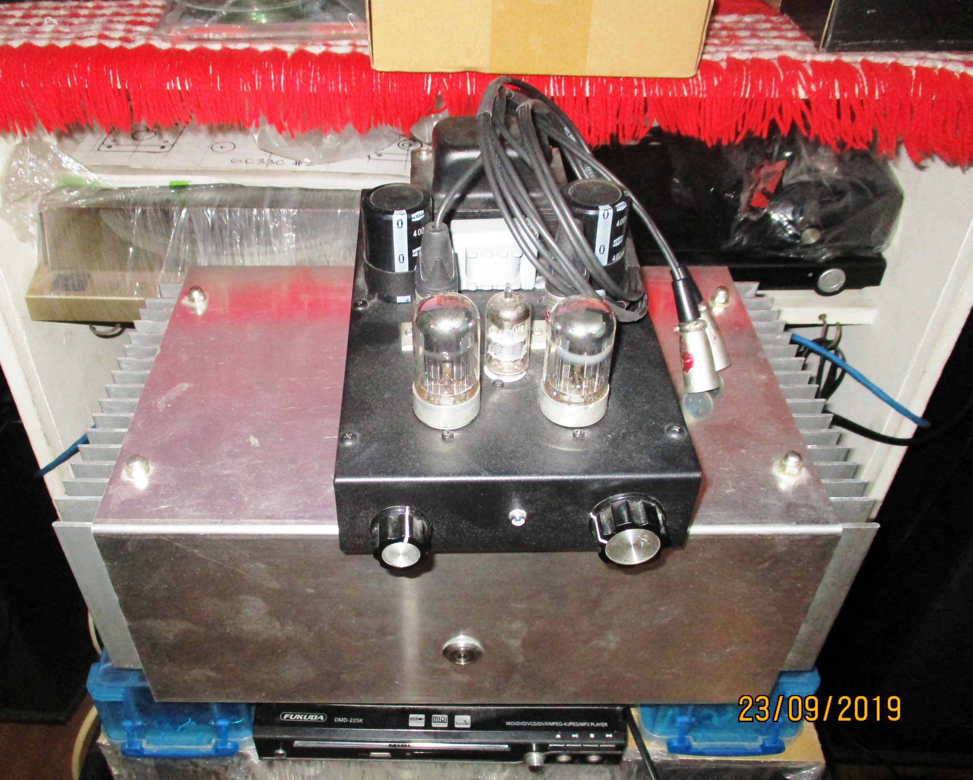

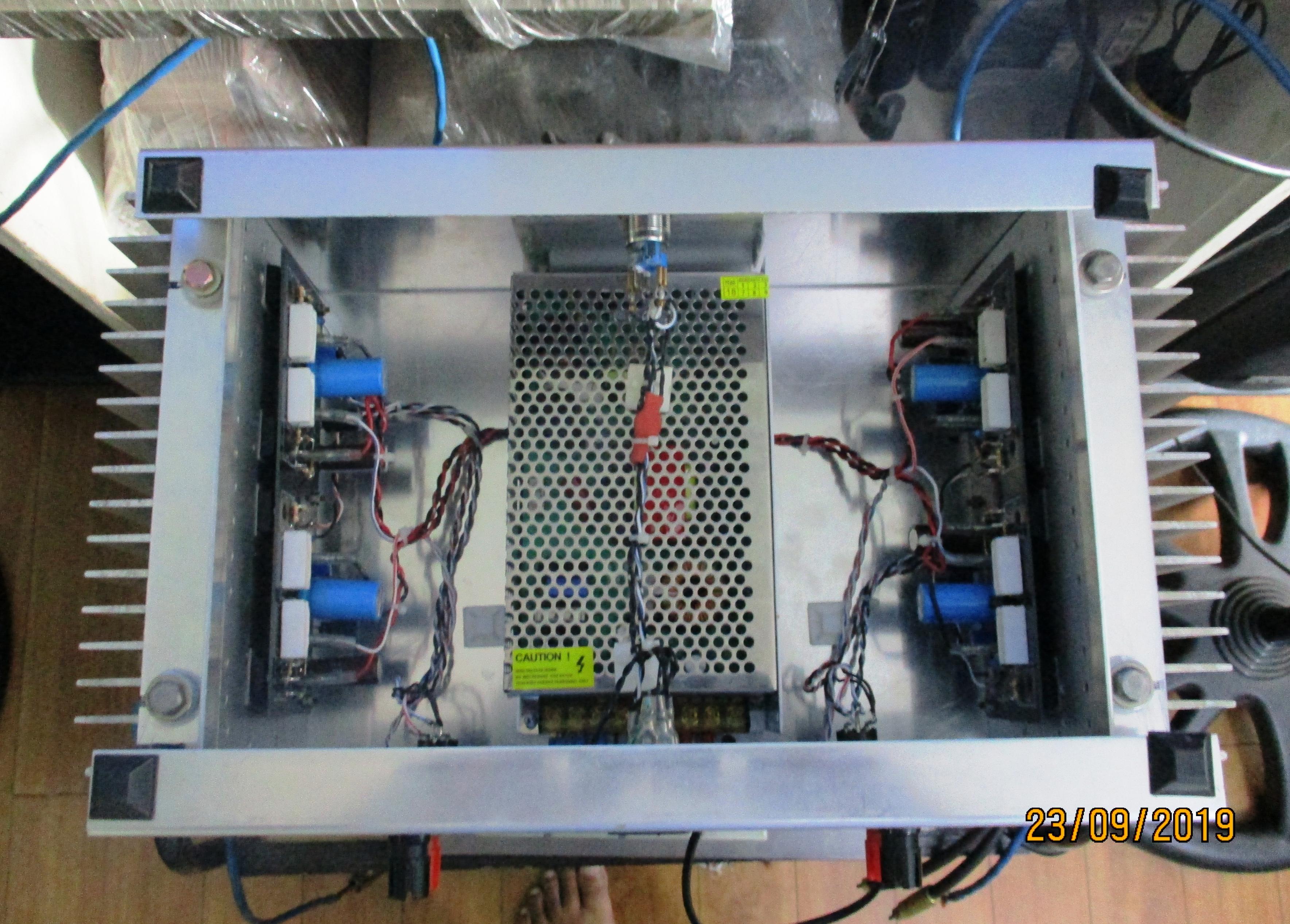

^yes, and the output to speakers then is derived from the pos "hot" leads of speaker terminals, the negative is unused...
this is my balanced ACA, aka Kampana amp locally, in manila....tube preamp is a SY impasse wannabe....
