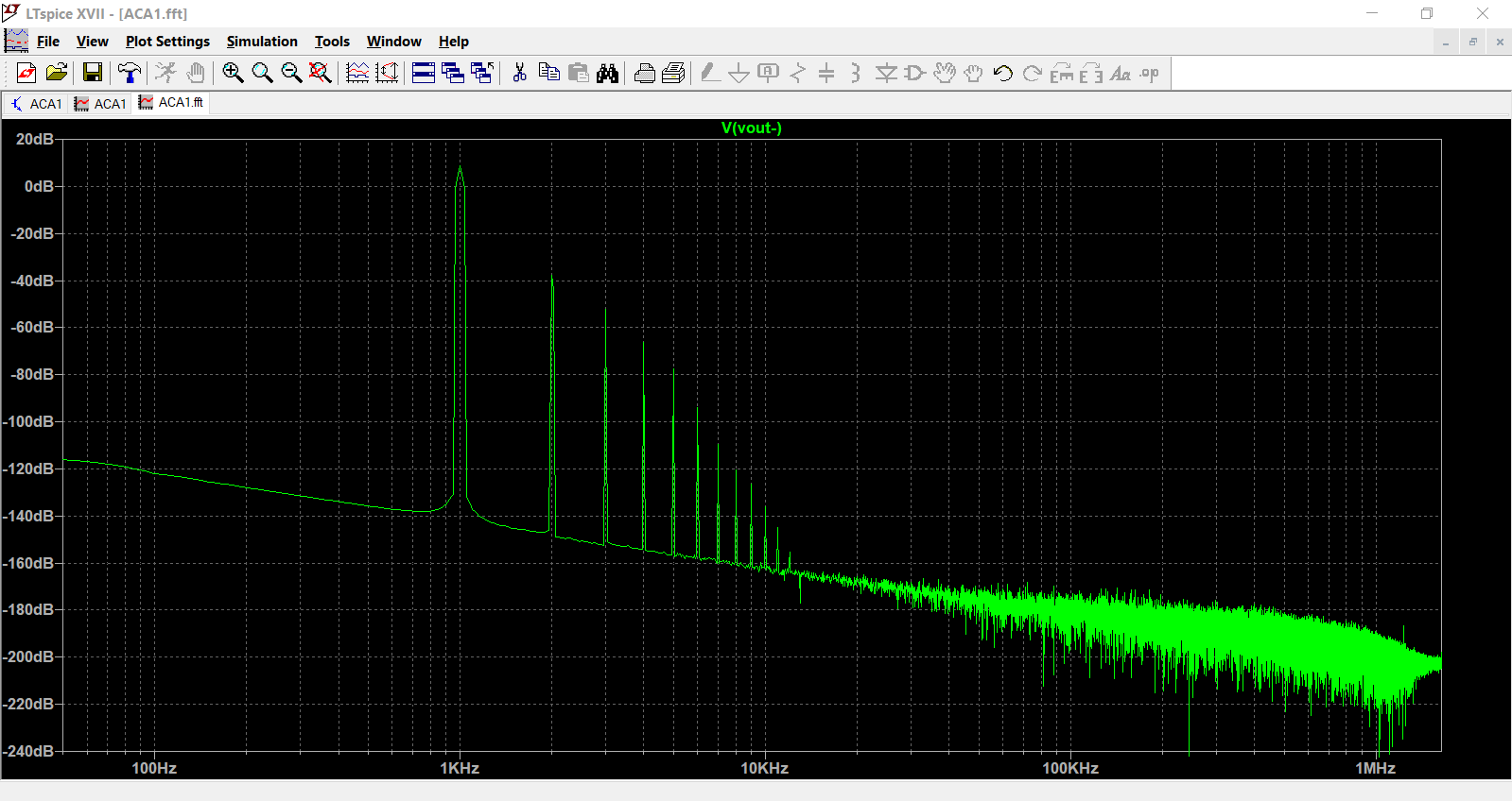

I've just re-attached better images in the post above with the scales set the same for both versions.

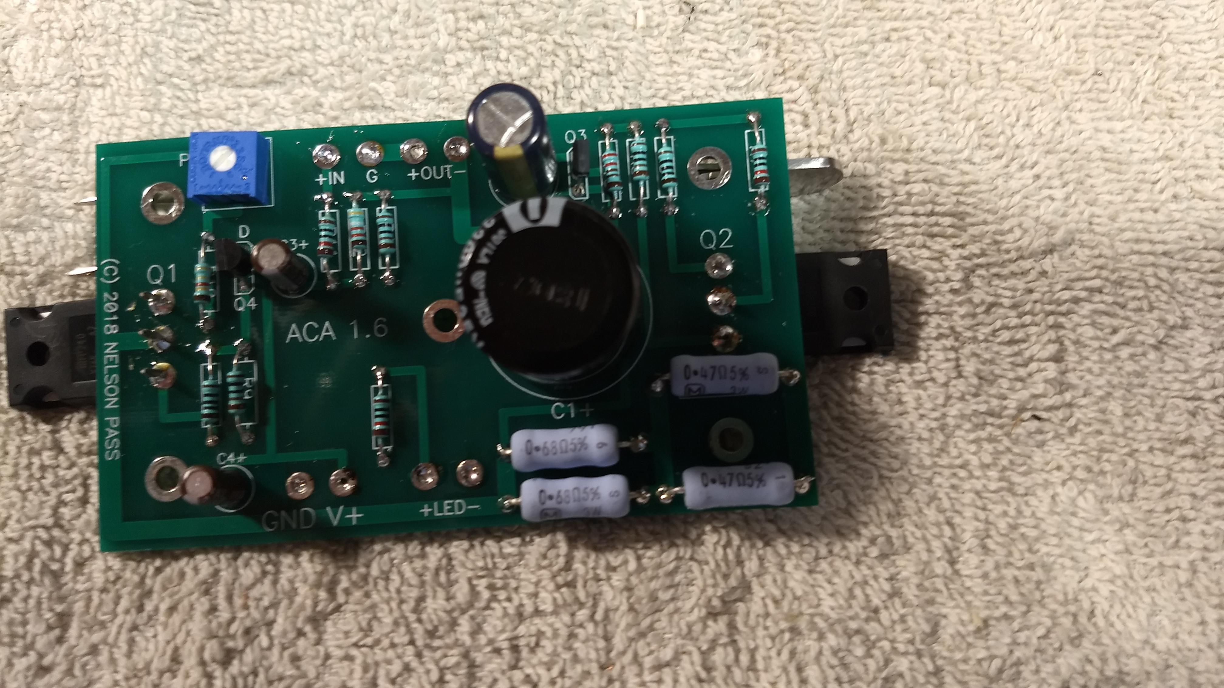

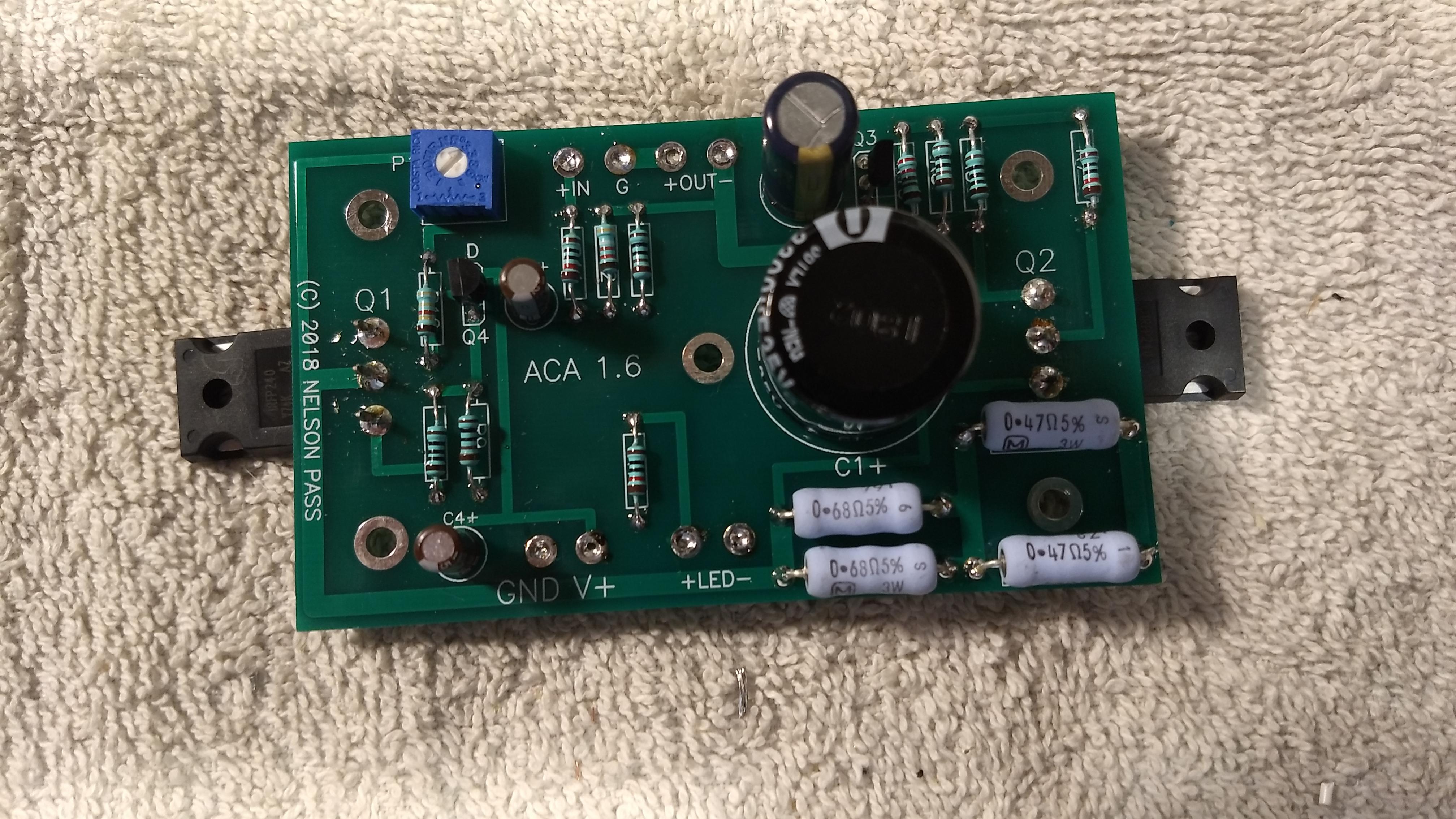

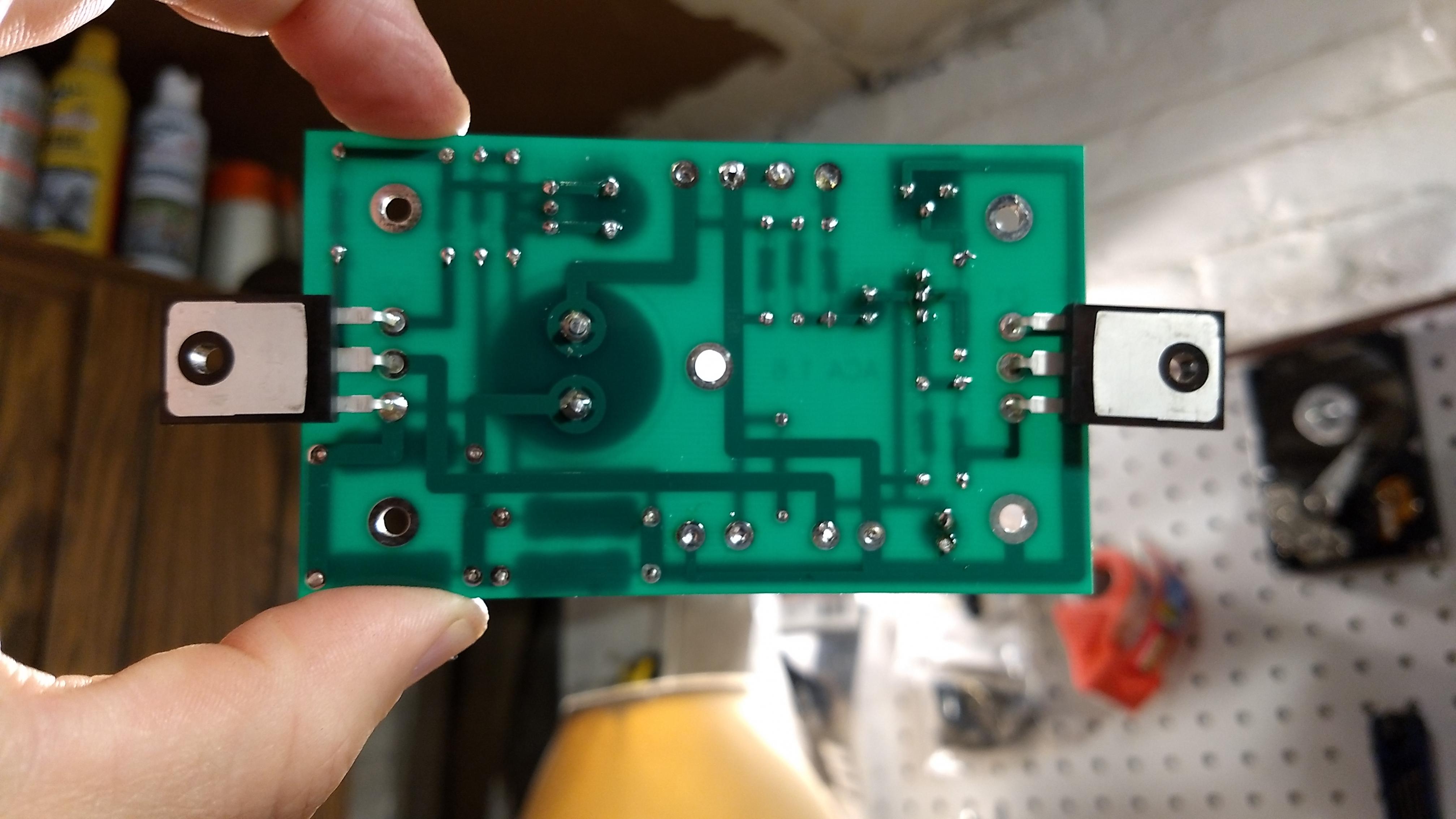

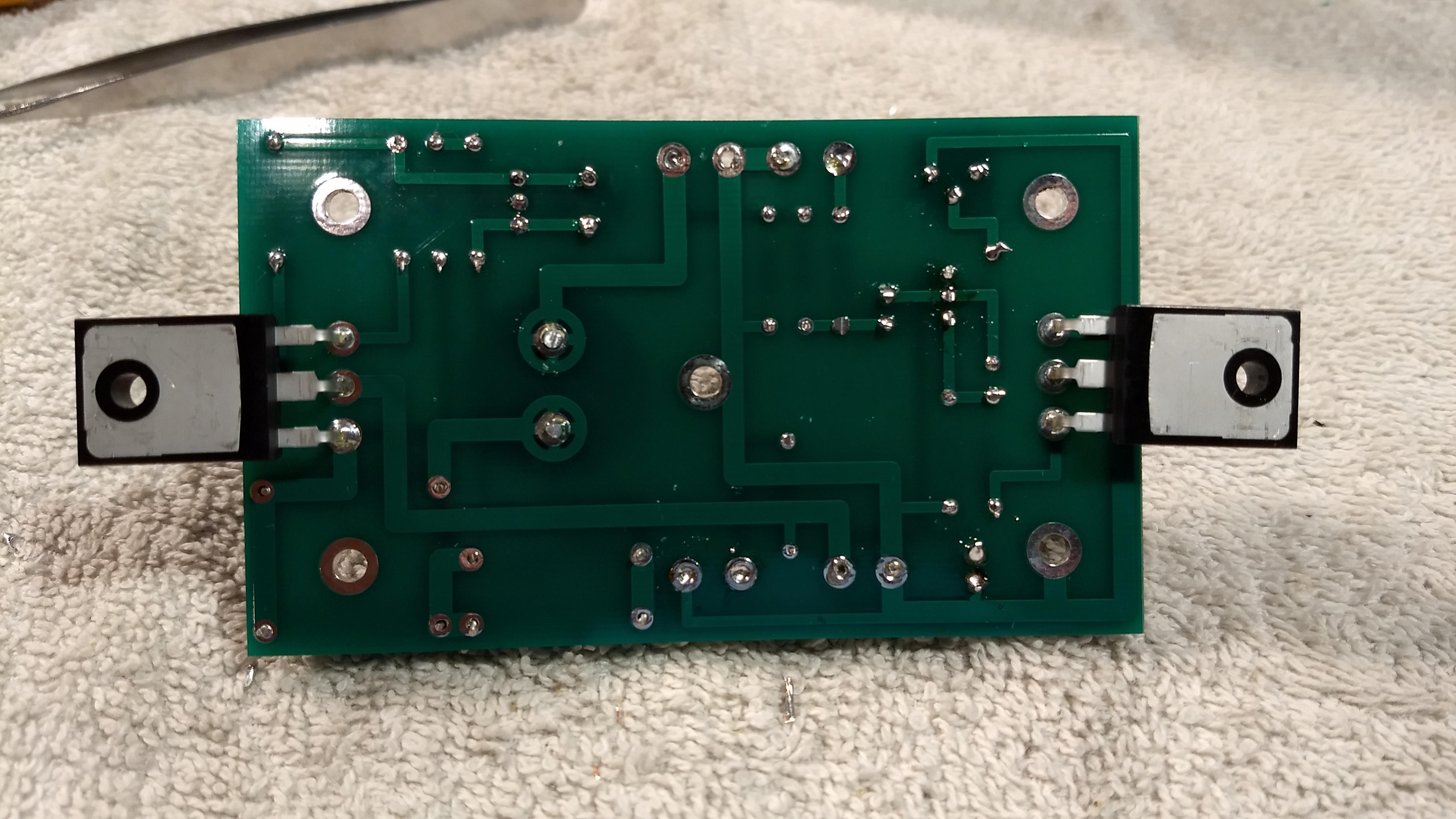

I need help. Just finished the 1.6 kit.
Left channel works fine. Right channel does not.
Both were biased to 12v.
Wiring was quintuple checked as ok.
Right heatsinks get hot just as the left do.
LED lights up on Right channel.
So, from what I can gather, there is power to the board and it goes where it should.
I checked the Voltage measurements with power on and they were spot on.
I checked resistance, and they were spot on, except some 1k readings were coming in at 1.5k.
This was the second of the two boards I stuffed and soldered, so it was a smoother and neater (don't judge my inability to get the resistors centered) process.
I can't figure out what is going on. Q3 or Q4 not working perhaps?
Please help.

If the DC conditions are correct (biases OK and runs hot) then the most likely cause is a problem with the input wiring, or less likely, no continuity to the speaker output.
If you hear the usual noises at power on and off via the speaker then the output wiring is OK.
Measure and test for continuity from the RCA input all the way to R11. Also make sure that the RCA doesn't read short circuit from inner to outer connections.

I would start simple - on the non-working board, retouch / reflow all of the solder joints.
Then check wiring. Reassemble to chassis.
As Mooly also suggested, input shorts / output wiring continuity.
Then, with everything plugged in, check the voltages ala Step 56 of the build guide

While I agree with the idea of 'starting simple', I would hardly say reflowing all solder joints qualifies as 'simple', when it can be an simple input cable issue.
I'd first do as Mooly suggests. After checking that, maybe start refilling stuff.

thanks.
I figure a reflow isn't that big of a deal - I love to solder and it will take very little time with the board out.
I'll check the potential continuity issues first though.
I'll report back.
OH, no turn on noise for this channel.

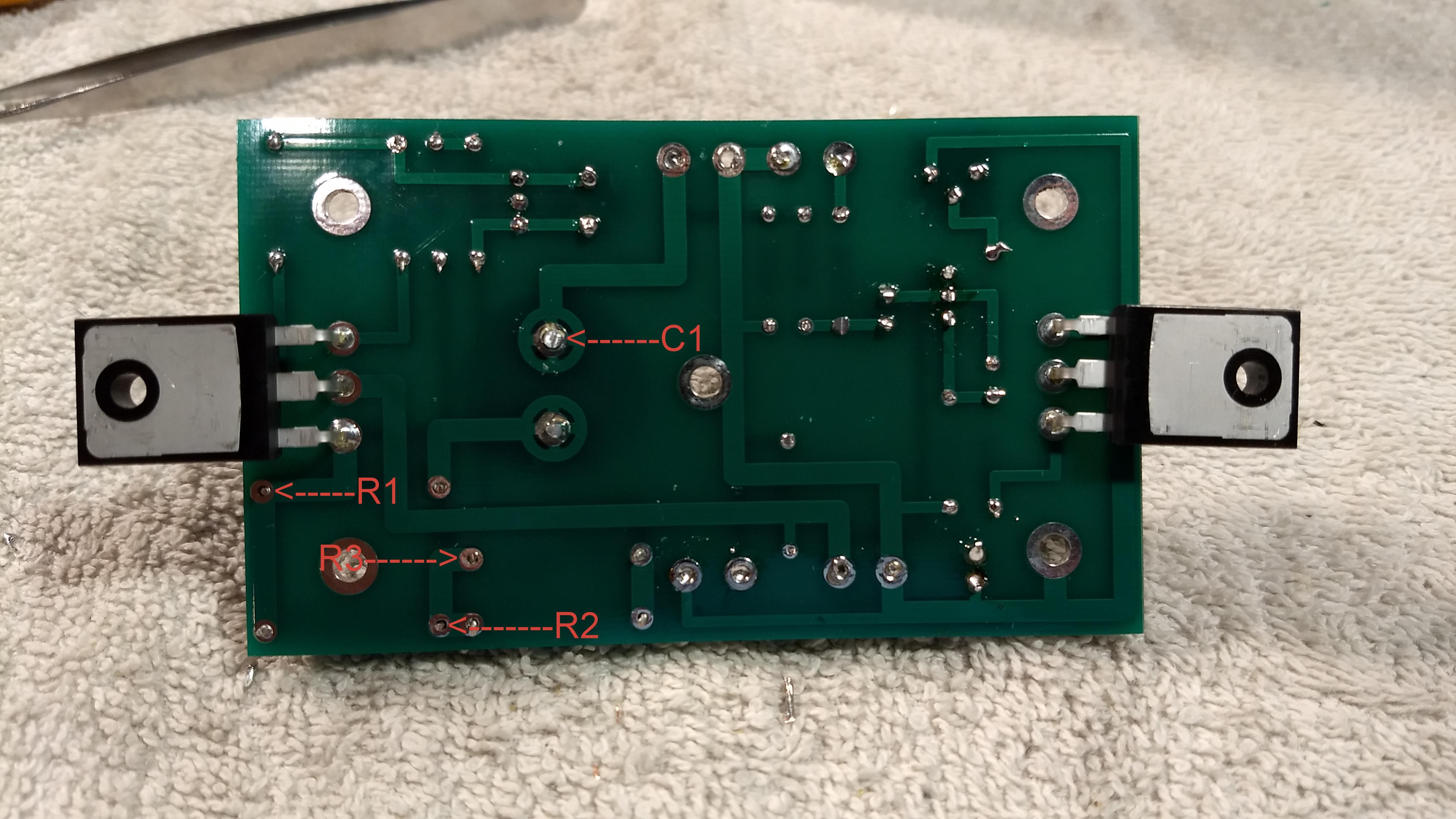

If you measure the resistance across the input RCA socket, ring to inner part, it should be around 50k ohms (use the 2 meg range). The output terminals Red to Black should read around 1k ohms (on the 20k range). Wait a few seconds for the meter to 'climb'.
Looking at the picture, the top solder joint on the large capacitor (C1) and R1, R2 and R3 do not look good, but it might be a trick of the light. But touch them all up anyway.
