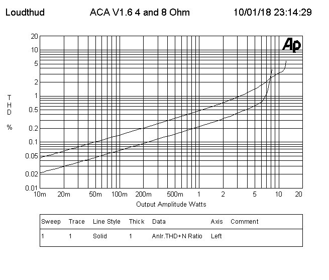

Below is a graph comparing ACA V1.6 with 24V rail THD with 4 and 8 Ohm loads. The AP analyzer doesn't want to do this, when you change the load impedance for the power calculation, (so it displays Watts on the horizontal axis) it clears the previous graph. You have to capture two graphs and overlay them in Paint. Sorry, I only have one channel at the moment so I can't do balanced or bridge configuration.
