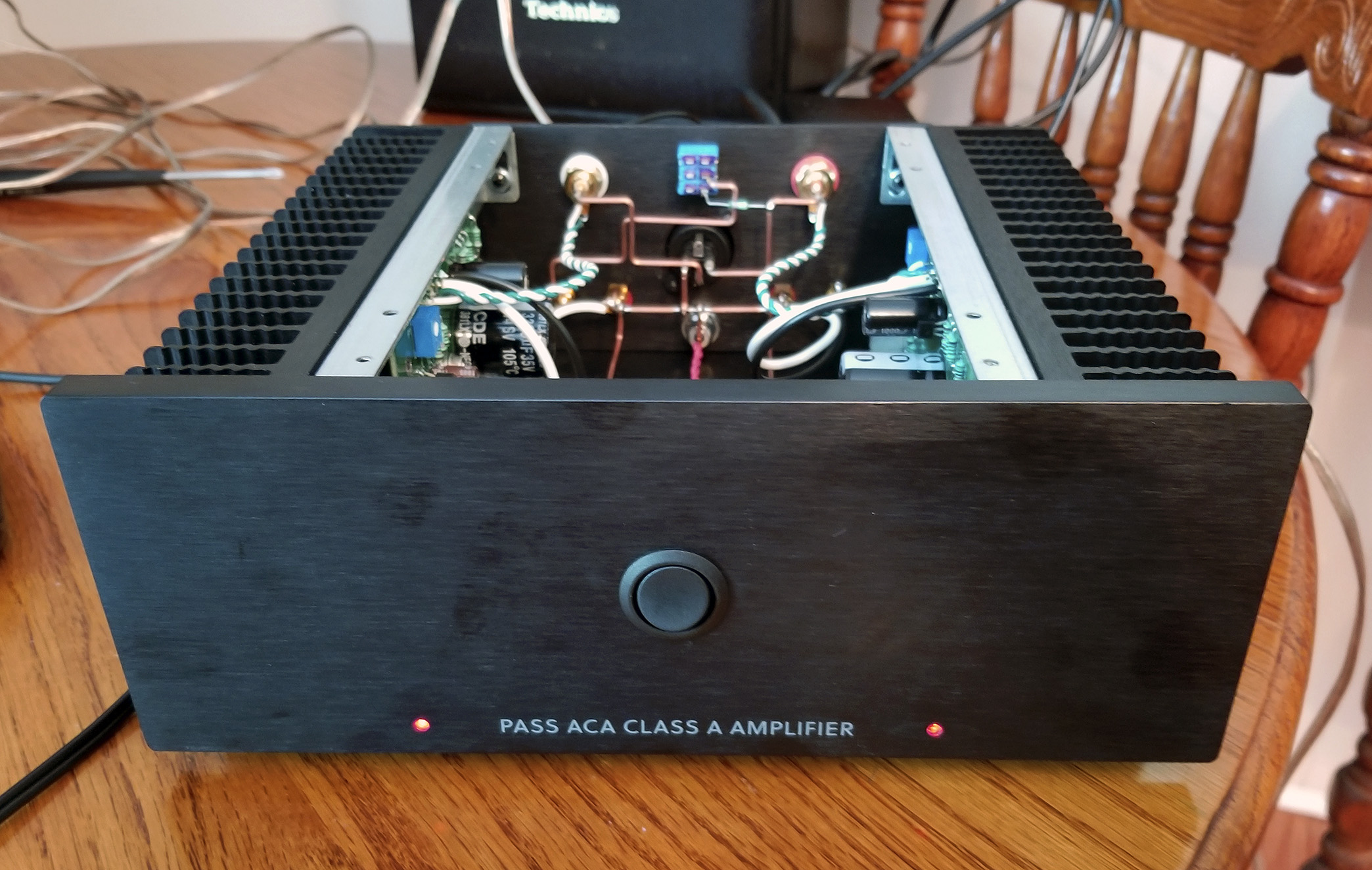

Just completed my ACA build a few minutes ago. With the exception of an Elecraft K2 Ham transciever, this is my first venture into the solid state world after two decades of building tube circuits. I used a combination of the ACA 1.5 guide and the pics 6L6 posted earlier in this thread (#5075, if memory serves), guessing that the rear panel wiring is switchable between stereo and bridged mono; so far so good... nothing's burning yet. I had some exotic, oxygen-free copper 14 gauge bus wire (read: straightened THHN house wire :D) left over from a previous tube amp project, so I put it to use here for a 1920's "breadboard" effect.
To say I'm quite pleased is an understatement. My test setup does have some, er, shortcomings; I'm using my laptop as a source (may not be capable of 2 V output), and my speakers are a pair of Technics SB-LX10 bookshelf jobs rated - and I suspect generously - at 89 dB. I'm getting some lovely sounds out of this despite all that, however. I can't quite put my finger on it, but the sound is very smooth and detailed without being "sterile". Highs are very crisp, and there's plenty of relatively well-controlled bass (well, as far as I can tell anyway given the limits of these speakers). Can't wait to plug this into my main setup for sure.
Thanks again to all on the forum who worked so hard to make this possible! :)

Nice build!

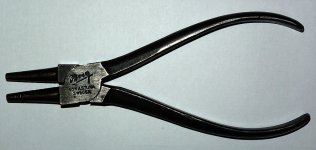

Did you use a tool like the attached image to bend the copper wires so it gets a round bend?

Thanks, Mrshazbot. That bus wiring is a PITA, but it makes for a cool effect - and it's rigid. My experience building tube circuits makes me a bit hesitant to leave wires flopping about, although I doubt it makes much difference here with the low voltages involved. Old habits die hard I suppose. One additional benefit of this scheme is that it can provide the builder with additional points for attaching other wires or components, hence the rather odd positioning of the output wires seen in the pictures above.
I wouldn't be so quick to diss your build, though. I'll bet it looks at least as good as any other shown here, and it most certainly sounds as good I'm sure. Besides, you built the thing. Most others are happy to buy some POS from a big box chain. You should be proud! :)
Hi MEPER. Oddly enough, I used a pair of smooth-jawed (i.e. non-serrated) needlenose pliers for bending the bus wire. It (it being the wire) is sufficiently stiff so that it naturally takes a round bend just past the sharp edge of the jaws without leaving much of a nick. The trick is that you have to plan ahead for each bend.
I did use a pair of conical-jawed looping pliers (normally used for jewelry) for bending the leads of those parts on the PC board. They make smooth, even curves possible without stressing the parts themselves.
