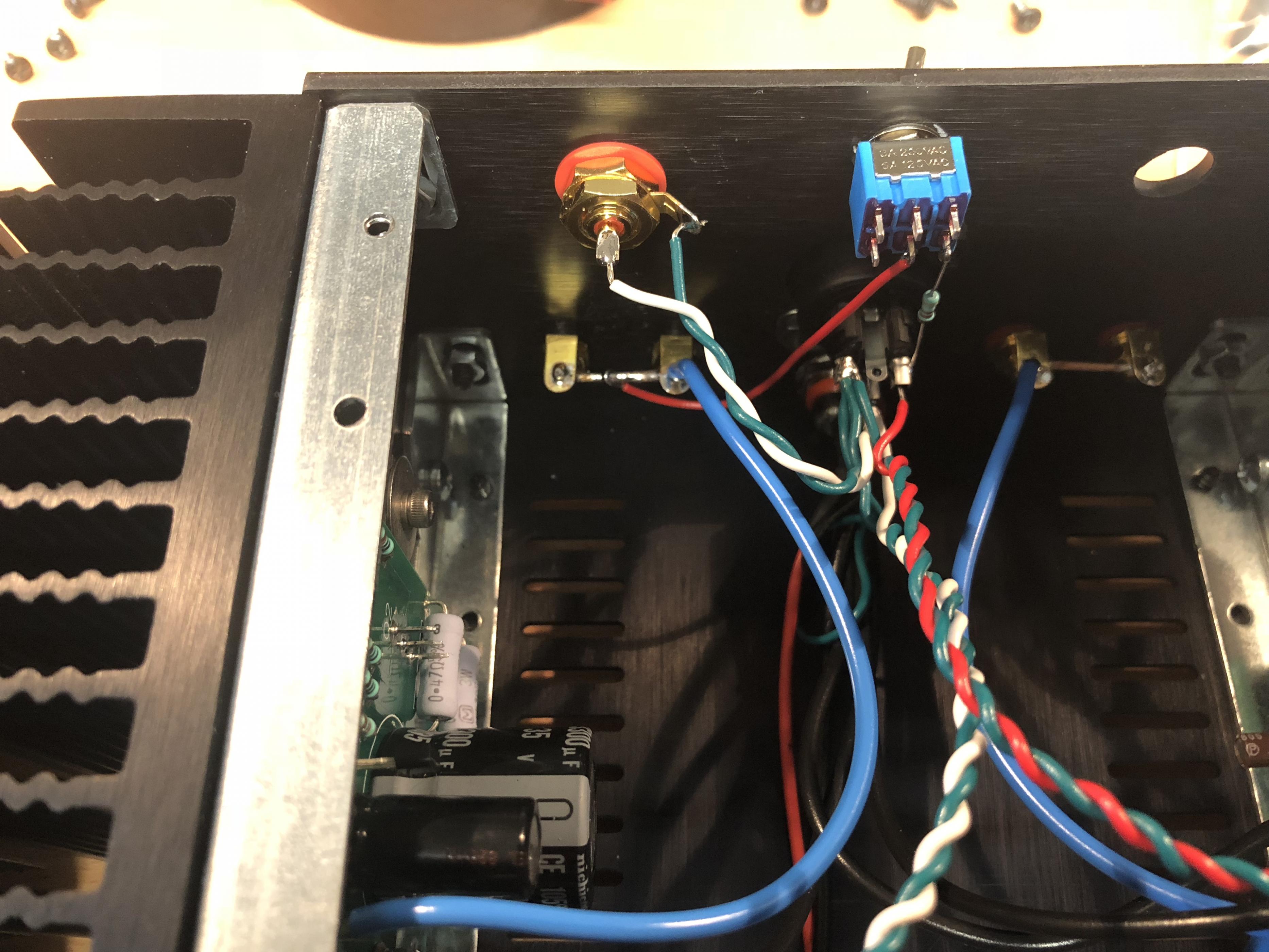

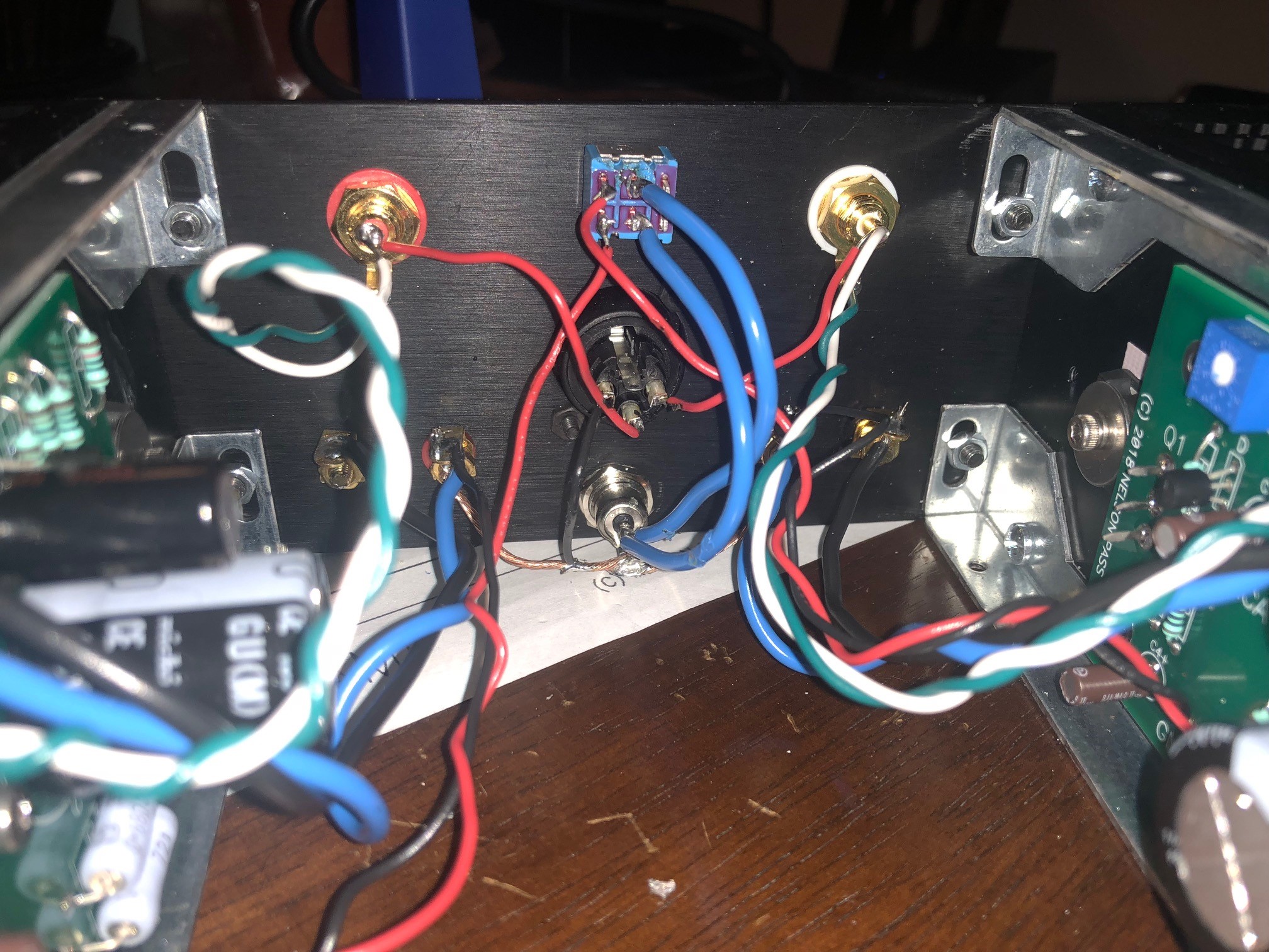

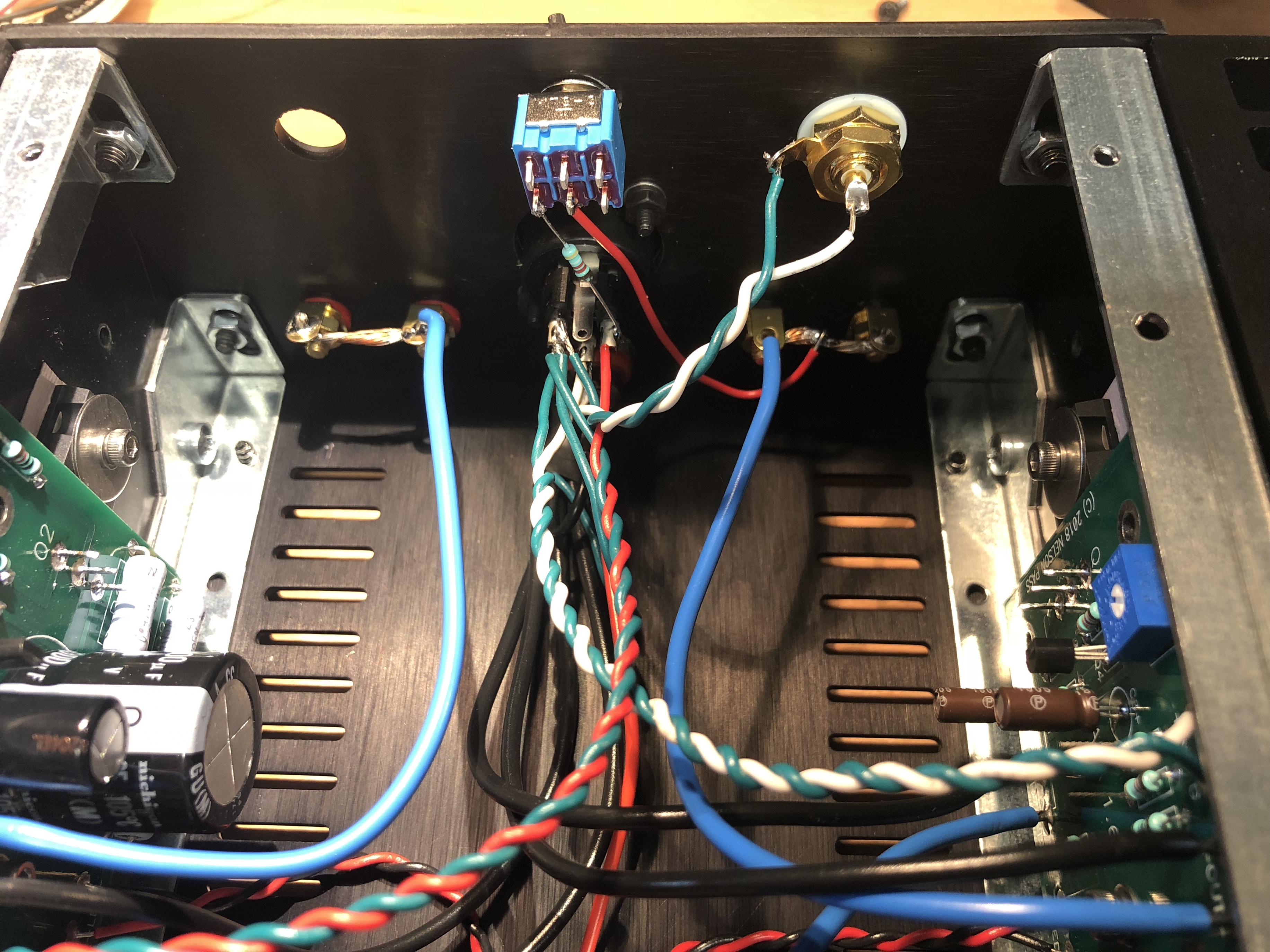

Here are some ACA 1.6 wiring photos -
Note that the biggest difference is wiring the PSU to accommodate the front panel power switch. Only the V+ is switched, the pin of the barrel connector is attached via the doubled up wire and goes to the power switch, and the other pin of the power switch connects to each of the amp PCB.
The tab of the barrel connector connects to the ground pad of the amp PCB.
Instead of twisting the two positive DC power wires from the back panel to the front power switch, and running the positives separately from the front power switch to each board, and the grounds from the back panel to the boards, would it make any improvement to twist the positive and ground all the way from the back panel to the front power switch, and also from the front power switch to the boards? Obviously, the ground would be a continuous wire, but you'd have it twisted with the positive on its journey to the front power switch and then back to the PCB.
I noticed that positive and ground were twisted in the 1.5 build, and from a layperson's perspective, I would think that you'd get some noise rejection by twisting the positive and ground the entire length - would it really matter?

@JP14 twisting the power cable is unnecessary. The amp has an extremely low noise floor and the power cable doesn’t contribute to much noise, at least in my case. The power cable + feed is doubled up for increased gauge and twisted for aesthetics. I just used larger (lower gauge) copper cables for main power to the switch and the included thicker cables for amp power inputs and speaker level wiring.
