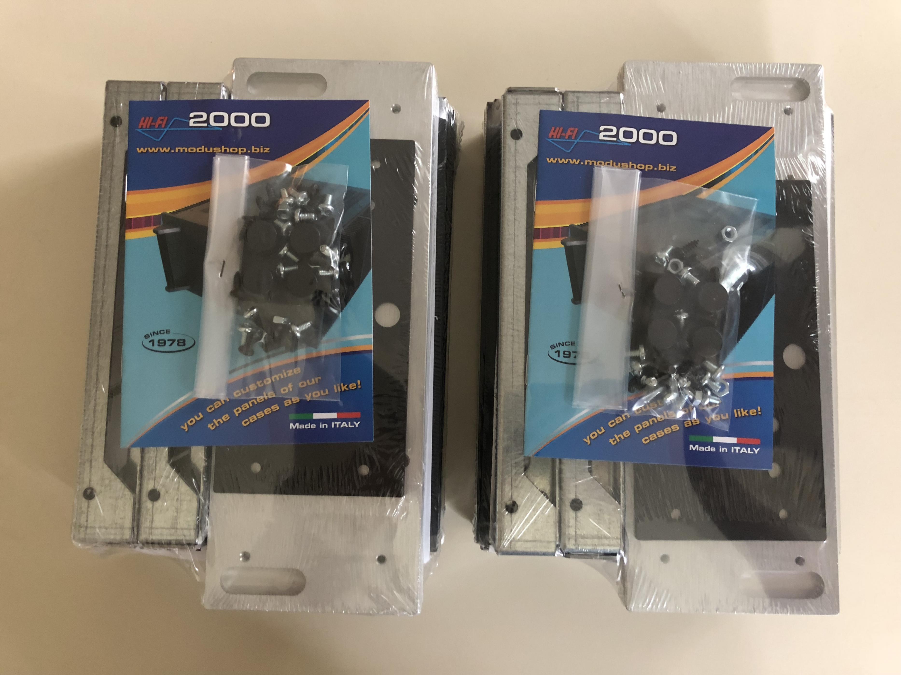

I got my metalwork for two amps from Italy in the other day - these will be, dare I say, some cute little amplifiers when everything is put together. I'm sure my wife will love 'em compared to the Adcom 545 that's currently being used.
Heck yeah. I was likewise impressed with mine when it arrived last week. The finish is superb; I'm certain the fit will be, too. This is my first adventure outside of the vacuum state realm, so I'm understandably excited. If this goes well my plan is to scratch build two more as monoblocks using the "1.1" boards and parts kits from BA 2017.
