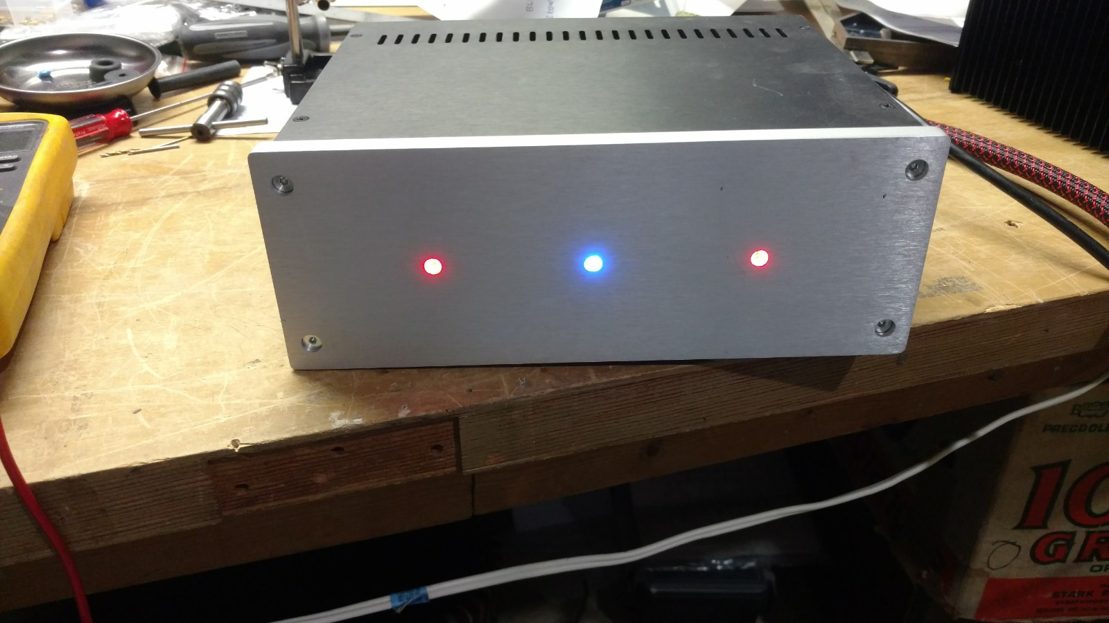

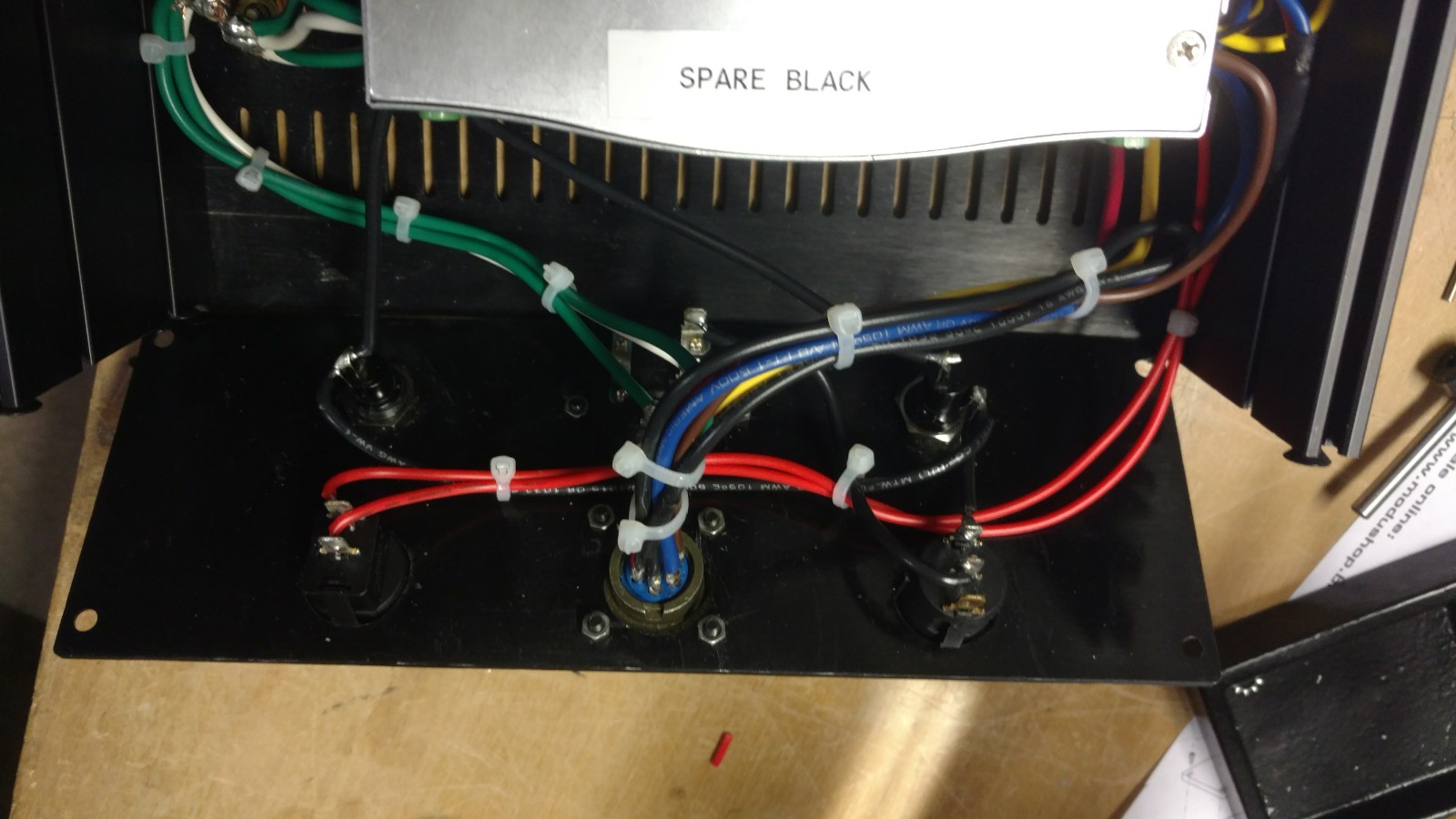

Have built an external power supply for upcoming AmpCamp 1.6 project. Don't know how well this will work. Just could not see using a laptop power supply. The reasons listed I have no problem with other than I guess can't stand the extra wire/brick in the picture. Yes can hide it but I can see through walls and know it is there all tangled up.....Just joking.
Will try to upload pictures. Built with Galaxy 2U chassis. Had to add spacer at the top for clearance. Waiting kit to arrive. Bear with me if pictures don't upload correctly. Hope they are all in one batch. OOPS, Don't know how to upload a url link for pictures in a folder on my pc. Oh well........Tried copy and paste into url but no good either. Sorry..

OOPS, Don't know how to upload a url link for pictures in a folder on my pc. Oh well........Tried copy and paste into url but no good either. Sorry..[/QUOTE]

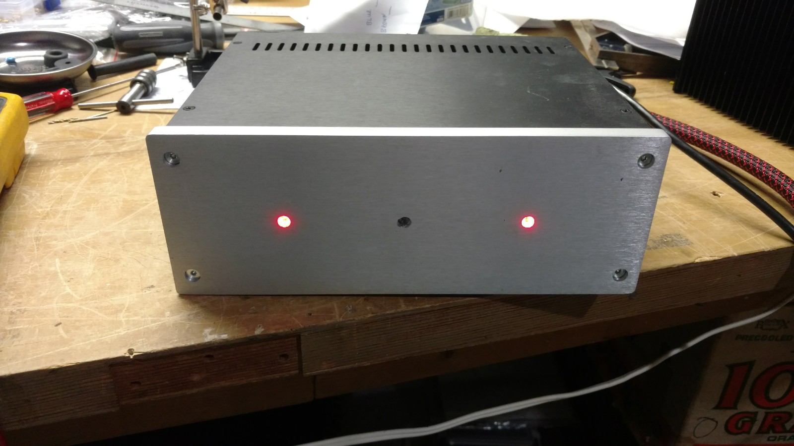

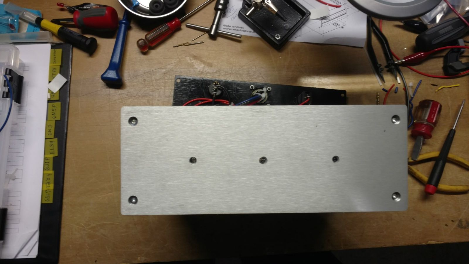

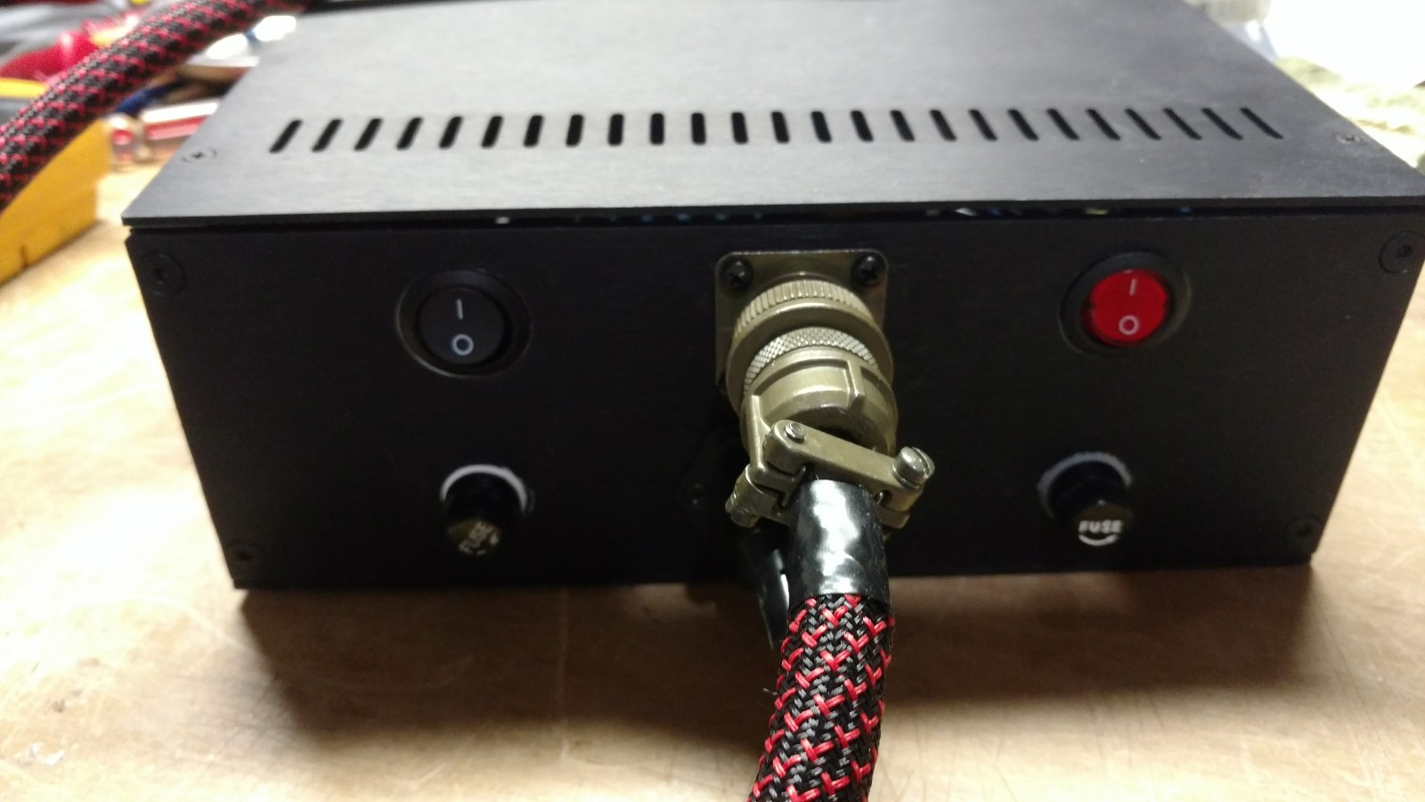

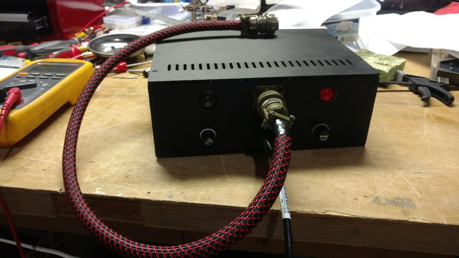

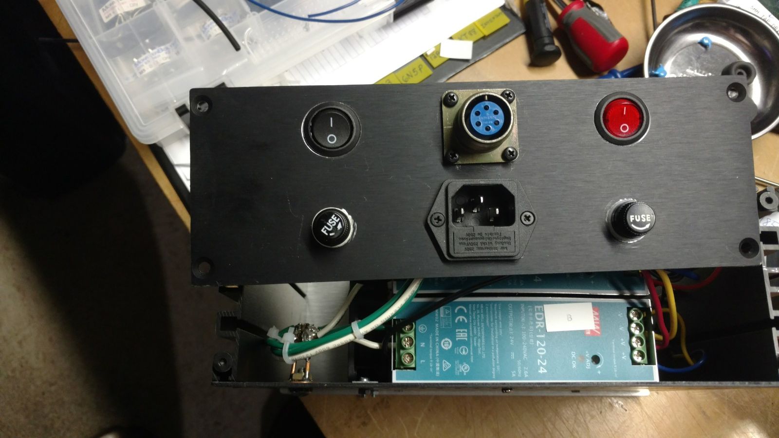

Thanks for the tip. Here are pictures.
Each Red LED is indication of both 24VDC power supplies are active. Each are 24VDC 5A output. Blue LED is indication of manually switched on cooling fan. It is very quiet. Will shorten amphenol cable later. Not sure of grounding to eventual other chassis with the ampcamp boards installed. Interconnect does have a ground wire connected to this chassis and would assume need to attach to to other chassis somewhere. DC negative is not common to anything yet. Should it be? Should it also be tied to earth ground also? At work we tie dc negative to ground to use to calibrate pressure switches using voltage and not having to disconnect the wires to us ohms to make or break the switch. I assume the same can be said for using dc common to ground is OK? Class D for DC supply should not care, right? thanks and you all have a great weekend.

That is a nice PS build there. I have a few suggestions. From the IEC 120VAC connector on the back plate, you have both the white wire (Ground or Neutral) and the green wire (Grounding or Earth Ground) connected together at the chassis. There is a reason they are not connected at the plug. Disconnect the white (ground) wires from the chassis. I assume you are using some SMPS that has separate 120 VAC inputs for A and B outputs. If it makes you feel better, you can run an earth ground through the Amphenol and connect to the chassis of the amp, but not to the amp input ground or amp power ground. Next time you will want to have the black wire from the IEC go first to a fuse before going to anything else like the switch (not critical right now). I am not sure what you mean in that sentence containing "calibrate pressure switches", but No, do not connect the 24 VDC negative to earth ground or AC power ground. Unless the SMPS instructions say the 24 VDC - output connection is referenced to earth ground, you cannot assume it. There is nothing to gain by doing that. Have fun with the amp build and please post more pics of the finished amp.
Unless the SMPS instructions say the 24 VDC - output connection is referenced to earth ground, you cannot assume it. There is nothing to gain by doing that. Have fun with the amp build and please post more pics of the finished amp. quoted from propitious...
Propitious thanks for the tips. What does not show in the picture is that the IEC has a fuse built into it so has some protection right off the bat. Then each PS has its own fuse. and each fuse is in series with either PS A or B. When you say SMPS that is what caught my eye about not grounding - and correcting my wrong idea about the PS negative DC end.
At work our 24DC volts is standard with lead acid battery backup. Years ago they had us ground the 24DC - By doing this we can read 24 volts to ground at the switch 200 feet out in the field to calibrate it when seeing the voltage drop out when setpoint is reached. Easier than removing both 24 + and - and using the Ohms setting to see the microswitch make and break. Glad you pointed out
Having seen all kinds of ideas of earth ground and chassis ground rules/ ideas etc I went with the copper washer with copper wire to make it common. I also did not know that anodized aluminum does not conduct electricity. So for what I thought for safety went with the copper washer as common and to try to not have all kinds of ground loops??.
