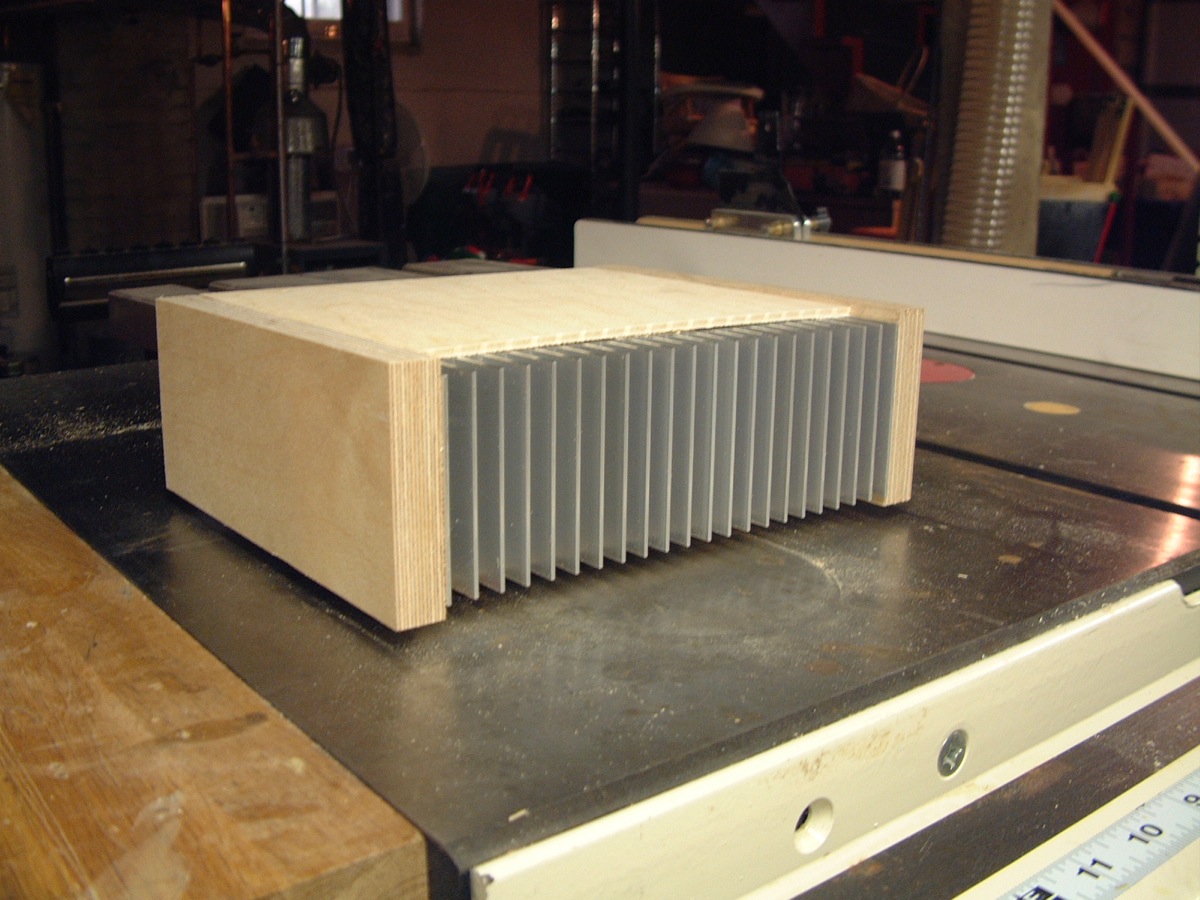

I stuffed the pcbs last Saturday... deciding what to do about an enclosure. I have the heatsinks - looking for ideas about how to encase them.

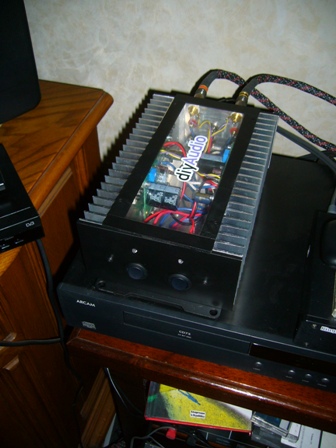

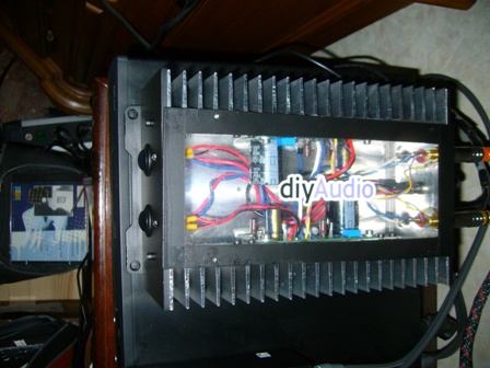

Amp Camp Complete!
I completed my Amp Camp #1 from the DiyAudio Kit! Here you have some pics.
It is stereo version case, made from scrap aluminium; the top is plexyglass.
The channels are completely separate, isolating the pcb GND from the dissipator.
The sound is AMAZING. I didn't think it would have played so well, the sound comes alive at very low levels and is full and rich at any frequencies.
I don't know if it is because of my setup (Arcam CD73, Kingrex Preamp, Klipsch RF82) but from my first listening I noticed surprisingly bass response!
I will do more listening sessions and I let you know in a few days time.
The only issue I have is a turn off thump one the loudspeakers, but I'll investigate later.
This is my first class A amp and I recommend it to everyone because it has excellent quality/cost ratio!
