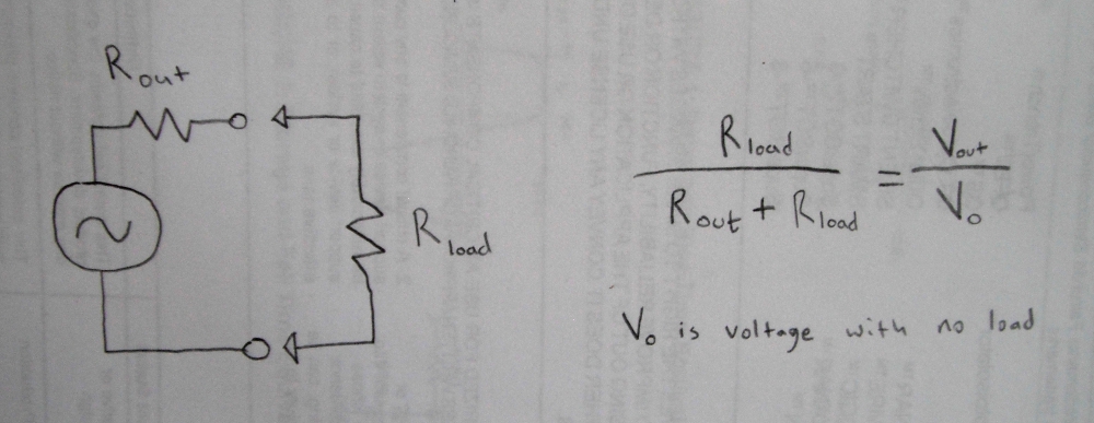

As I see it, there are two ways to approach this problem. The first way would be to measure the output impedance of the ACA and then tailor the Arpeggio (or cables) to match.
The other way, aka, how I would do it, is to adjust the output impedance of the ACA to be 5.2 ohms and build the Arpeggio as specified in Morgan's article.
It's true that calculating output impedance is difficult, measuring it isn't really that hard. Put a sine wave on your amp's input and measure the output (peak to peak) voltage with no load. If you put a load across the output you get something that looks like the picture below. This is a voltage divider. If you measure the output now, the voltage will follow the equation on the right. When V_out is half what you measured with no load, R_load = R_out. To actually make such a measurement you would need a fairly beefy variable resistor to use as R_load. Measure the resistor when you have half the voltage and that's your output impedance.
If however you wanted to adjust the ACA to a specific output impedance, 5.2 ohms in this case, you could replace R12 with a 250k multiturn pot wired as a variable resistor and get a 5.2 ohm power resistor (or combination of power resistors that measure 5.2 ohms) and adjust R12 until, again, you get a V_out with the load that's half the V_out with no load.

I took some measurements today.
My math tells me the output resistance of the ACA is around 2.4 ohms.
I'd like some confirmation, either from Mr. Pass or someone else who has taken measurements that this is a reasonable number.
This is how I calc'ed 2.4 ohms:
Connected a frequency generator to the input, 1kHz and 1V (should be arbitrary.)
Connected a scope to the output.
Measured the output voltage with no load, 6.4V
Measured the output voltage with a 10 ohm load, 5.2V
Measured the output voltage with a 5 ohm load, 4.3V
I then used the equation on the previous page to find that the measurement with the 10 ohm resistor gives an output impedance of 2.31 ohms, while the 5 ohm measurement gives an output impedance of 2.44 ohms. They were 5% resistors, the calculations are within this tolerance. I measured the resistors with a multimeter, but I generally don't trust readings down that low.
Best,
Nelson
Because the gain is non-linear as I showed in reply 274, the output impedance will be non-linear. Try different signal levels, you should get different numbers.
Ah ha, I missed that post, thanks for pointing it out. It seems then that matching the output impedance to a speaker like the arpeggio is a bit more complicated than I previously believed. I'll have to put some more thought into this one.
