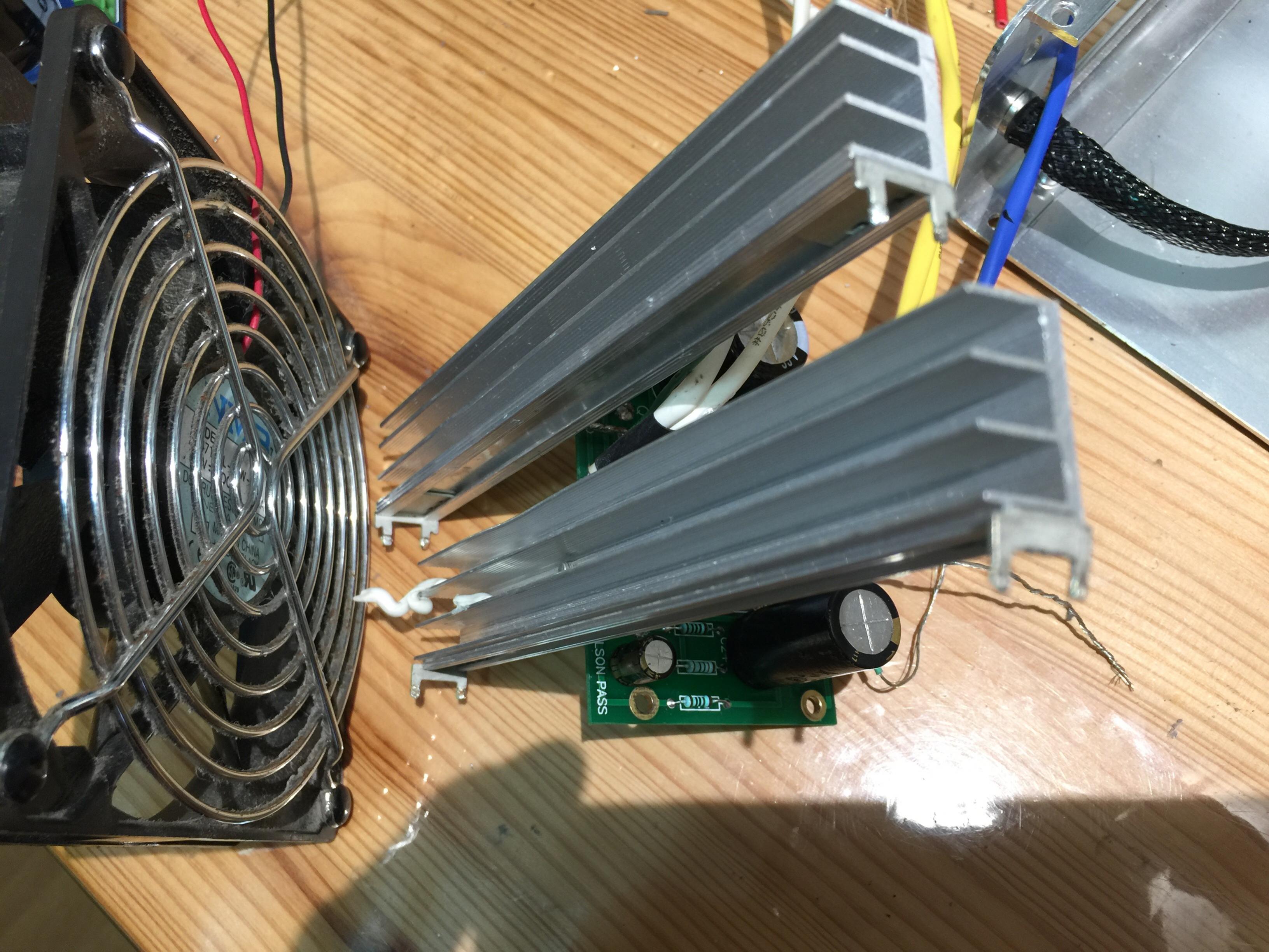

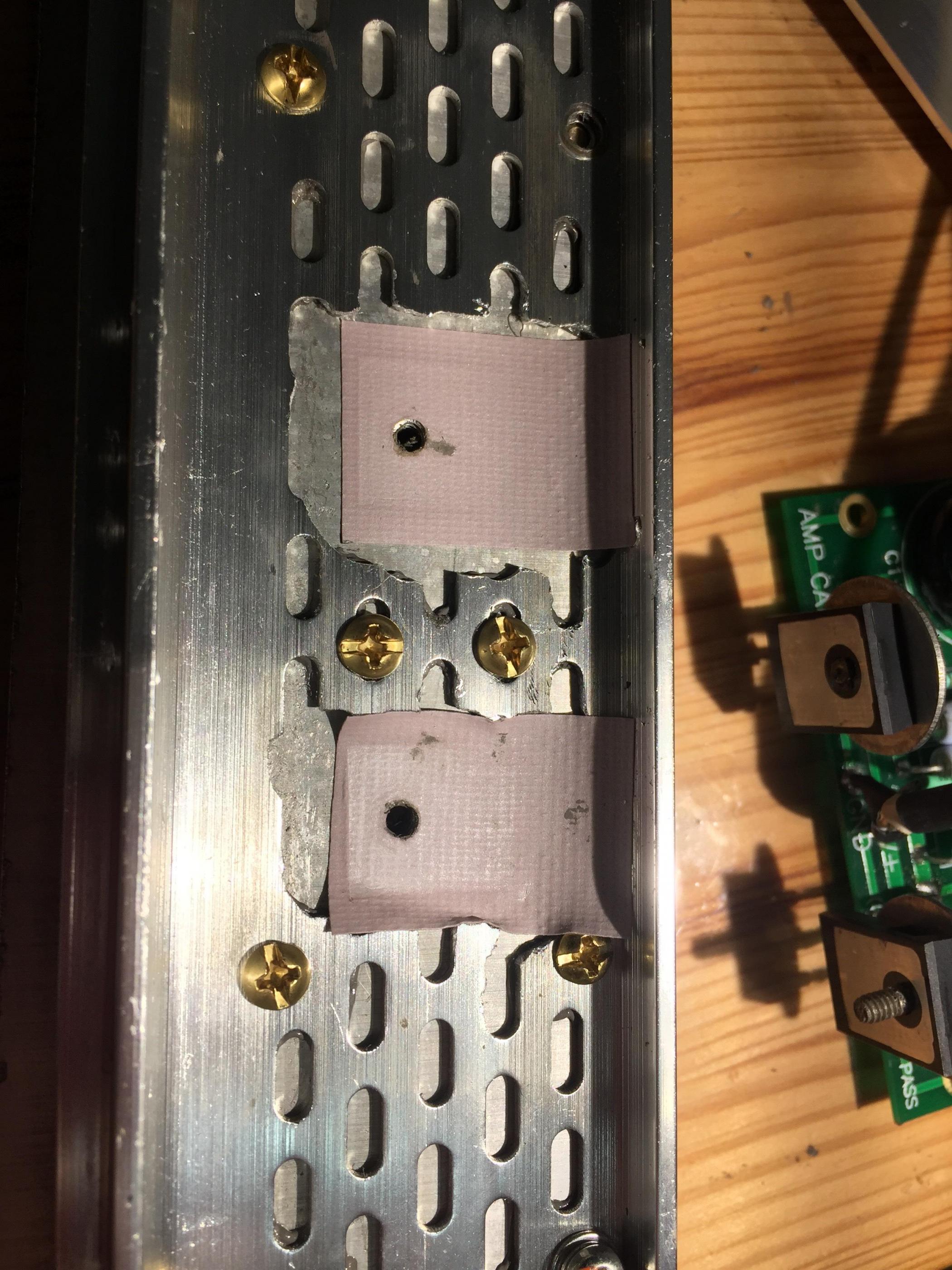

this time I removed the possibility of a short to ground of the transistors. I placed each transistor on it's own heat-sink. Even without insulation pads it make no difference, transistors are not touching any thing and a fan is blowing cool air over the heat-sinks and circuit board.

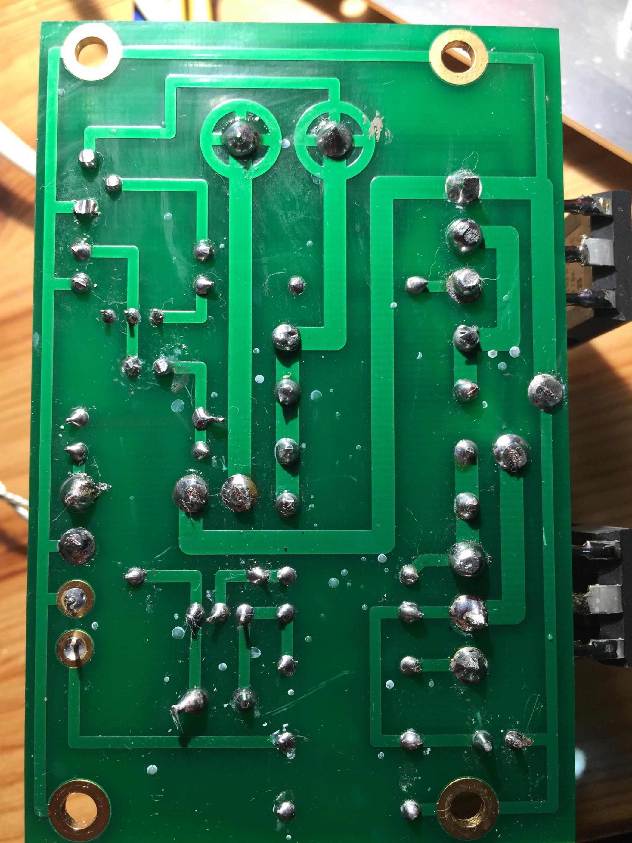

As soon as I plugged in the power into my watt meter it spiked up to 200W and I immediately pulled it. the only heat developed was the resistors on the power supply, transistors and power resistors on the amp board just mild warm. The photo under the circuit board so you can see the quality of solder nothing bridged. This time looking at the insulating pads you can see they did not get hot, no brakes or metal filings.
1:What should my next step to test?.
2:Should I increase the voltage on C2 from 25V to 35V because i'm using 24V instead of 19V?.

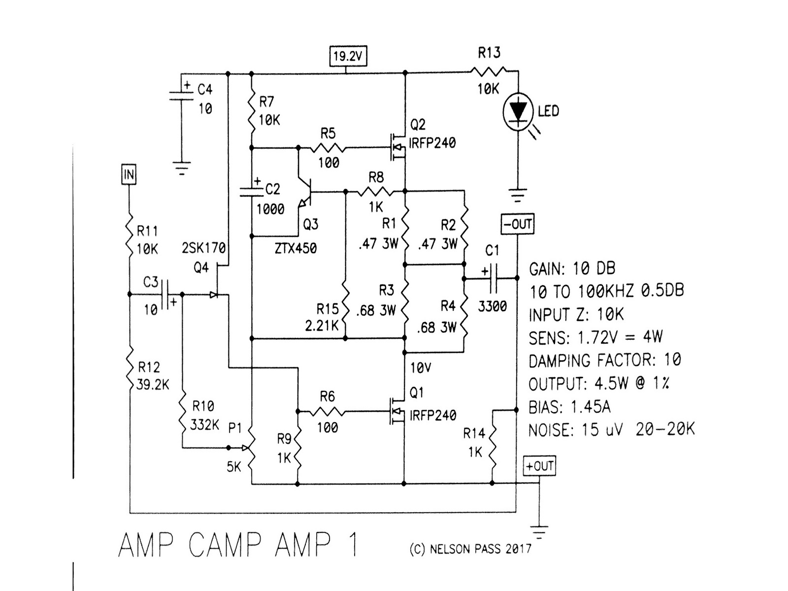

If you are running 24 volts, i hope you added one extra resistor (2k2), and changed values of two other resistors as per post #105.
Its possible you exceeded limits of jfet, now even you added new good outputs, amp is not working right, current all over.
Check each transistor.

Just a shot in the dark; Is -Out maybe connected to or touching ground? Refer to the schematic below.
I nearly made this mistake when I built my ACA and didn't have insulated RCA sockets available.

That irregular surface with the oval holes has many edges. If the mosfet is not *PREFECTLY* level with the mounting surface, or any of those oval holes have even the *SLIGHTEST* of a raised lip around the edges, you are likely to have cut-through in your SilPad and then the mosfet grounds to the sink and causes things to burn up.
The image you have where you removed this metal lattice work is a MUCH better approach, but I would go one step further. Remove this metal lattice from the sink that it is attached to. Then, take some 400 grit wet/dry sand paper, wrap it around a small flat metal block (never just use your fingers), apply some lubricant (water, oil) and do some sanding on that screw hole to make sure there is not a raised lip around the edge that will also cut through your next SilPad and ground the mosfet again.
Surface prep for mounting mosfets is *VERY* important.
Thank you all for your input it looks like I have several things to do . I did not put the 2.2K resistor thank you for pointing me towards the post for the 24 V . On the last third set of transistors I did true the surface of the heat sink so it was flat on the third set. Since this is been used in my class for electronics as part of my class project and I work full-time daily this board will be put off to the side to be diagnosed later and it’s a good thing I ordered four more ACA boards sitting in my parts box.
When the MOSFET is mounted it is good to check the insulation using an ohm-meter set to Mega Ohm. It should show "infinite".
This is EXCELLENT advice and part of my SOP (standard operating procedure) for mounting transistors to sinks. Check for continuity between each pin and the sink. Should come up "open loop" each and every time.
Yes, and it seems that the "back" of these MOSFETs is connected to the Drain pin so the center PIN when looking at a Vishay data sheet for IRFP240. But probalby good to check between all three pins to the heatsink (have to press hard with the probe PIN to get through black coating and oxide layer). And before the MOSFETs are soldered to the PCB and mounted as the PCB center screw makes connection from GND on PCB to heatsink.
