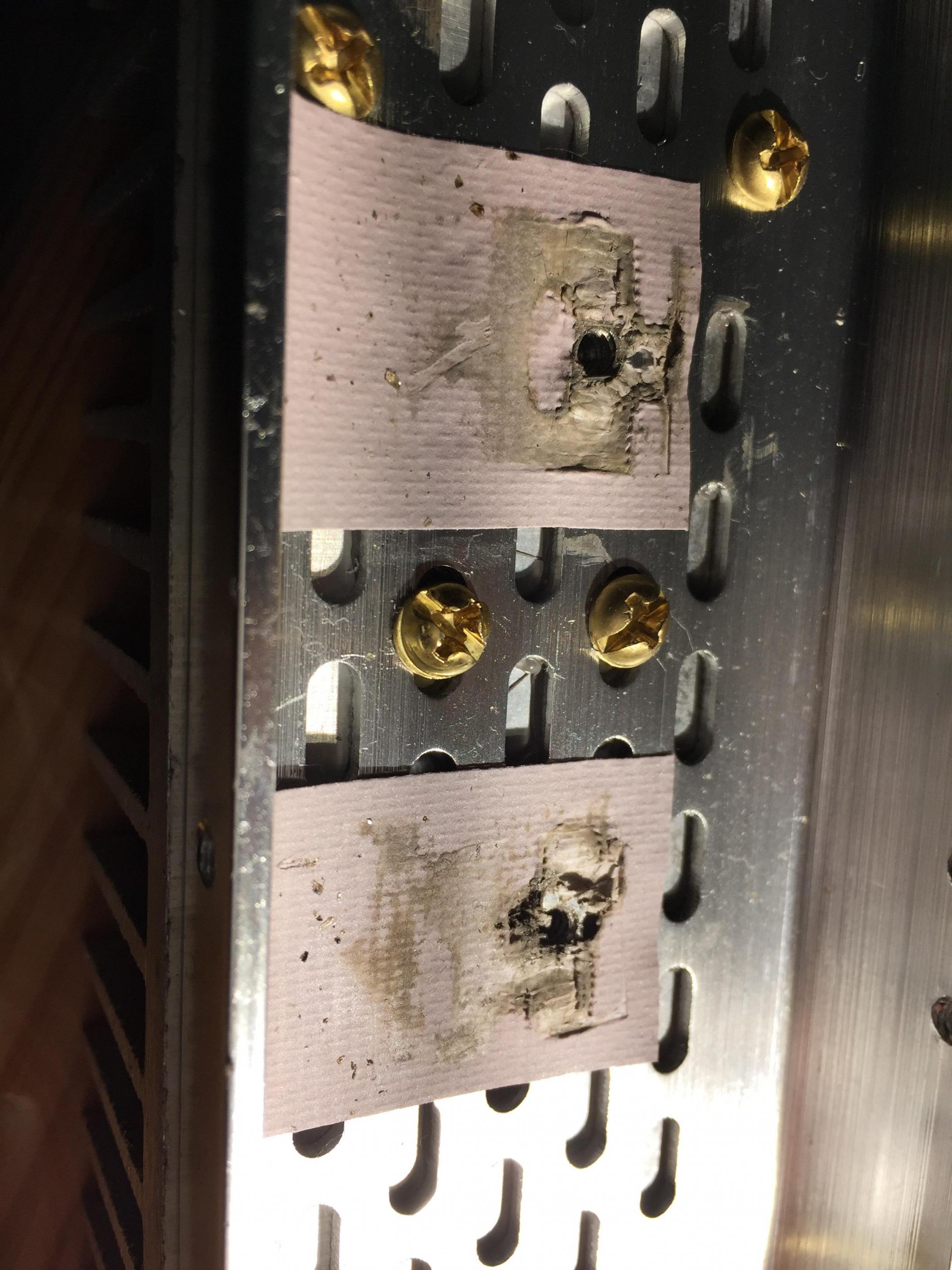

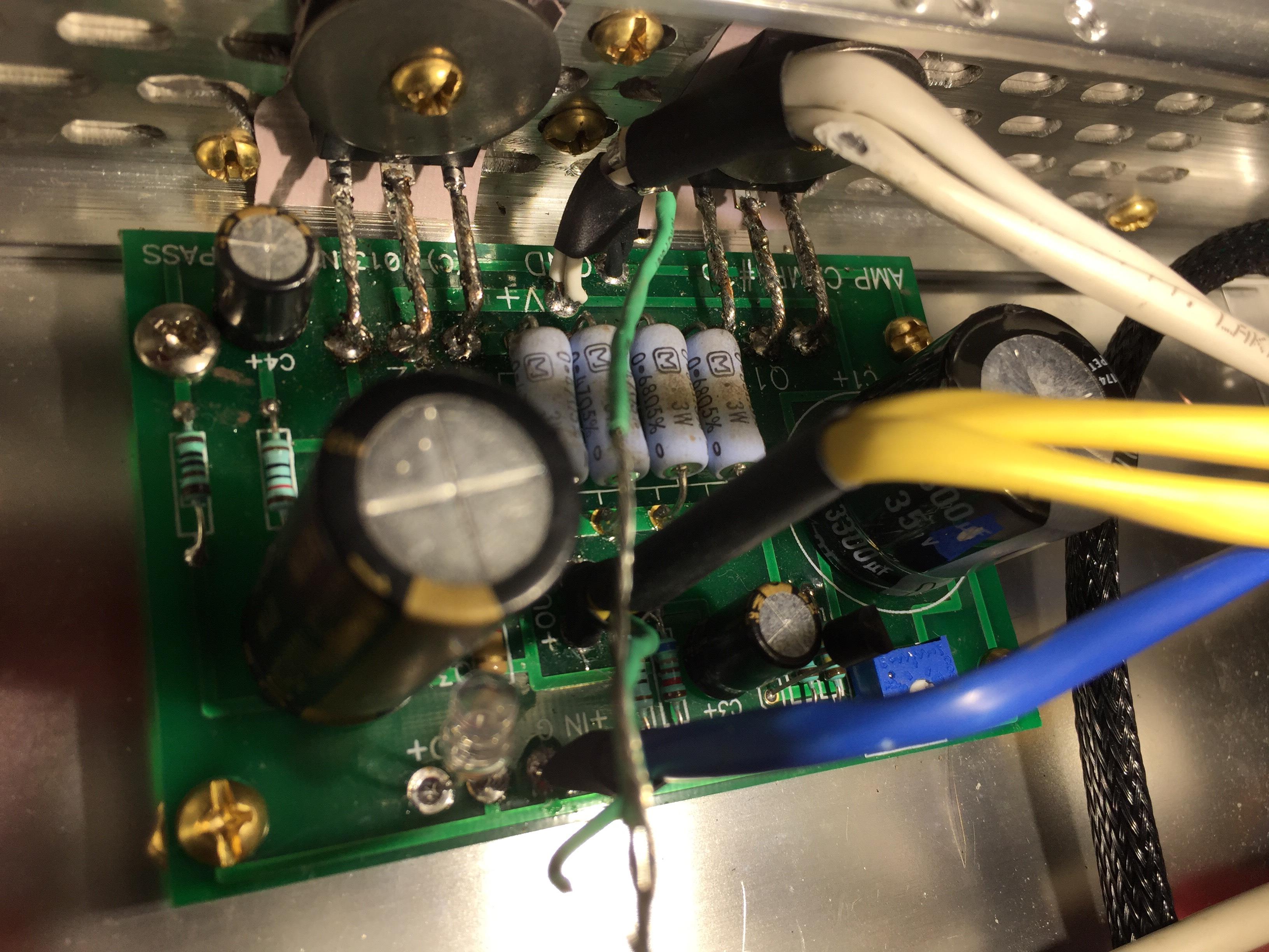

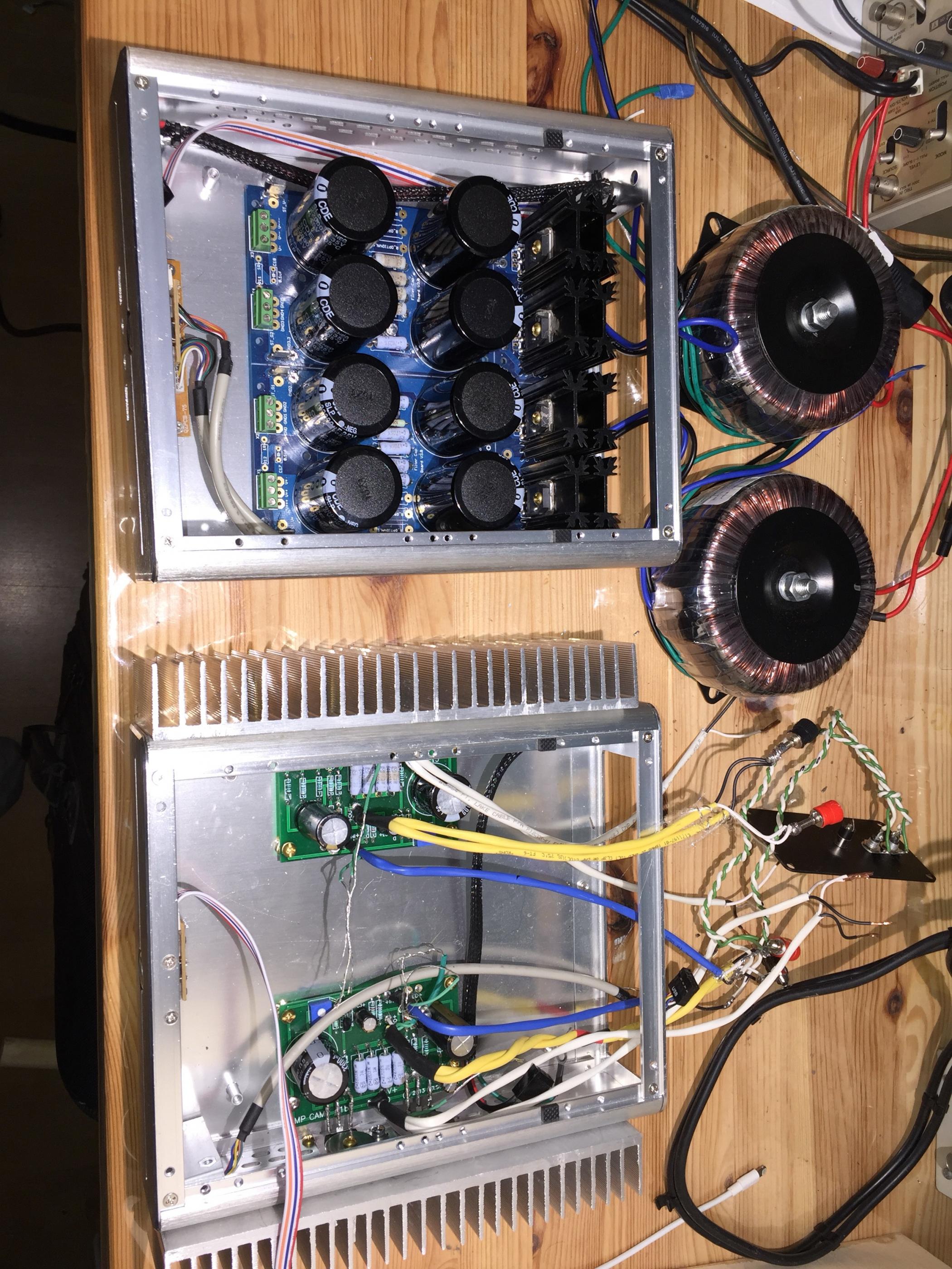

I didn’t want to ask for help this time I was determined to fix it but after three times it’s time to call in the Calvary. It worked great for three days after completion. Just finished building the Fostex BK20 horn loaded speakers for this amp that I read were recommended. Just finish building the universal power supply from DIY audio, got two toroidal transformers 200 VA each, running the system at 22.8 V I don’t know why they would not go to exactly 24 V under load. On day three while I was listening to music there was a snap pop and a flash and Magic smoke started coming off the 3 W Panasonic resistors from the power supply and the 3 W resistors and transistors of the amp board. Found a ground center leg I think it’s called the gate on the transistor of Q2 to chassis. See attached photos you can see the tiny gold arc mark on the back of a transistor and how the pink insulating pads seem to crush away and dissolve when they get hot. I replaced the transistors put some fresh insulating pants turned it on and it worked, “ for about five minutes”. Snap pop flash magic smoke again. Same thing then I determined because I was trying to fasten the transistors to the computer case that had holes sluts cut into them for letting air through May have been uneven so when tightening it pinched through the insulating material. This time I cut holes into the case to mount the transistors flat on the recycled heat sinks I got from air conditioning inverters and I cut down to size. Installed the third set of transistors plugged it in it worked but only about five minutes then more magic smoke with the flash. I was a mechanic most of my life and I’m in air-conditioning now I’m used to diagnosing things with repair manuals with troubled trees and pin out schematics for taking voltages and conductivity readings . But for this little amp camp board I take it there’s no written manual. The signal the power and the speaker wires are recycled off my job site there what we use for signal cables there shielded and have a draw wire ground we use them up to 1000 feet in length to carry our signal so I figured it would be good in this application for only about 9 inches a little overkill.
Was thinking for now it may be faster for me to just build up another board I have for spares, diagnose later.

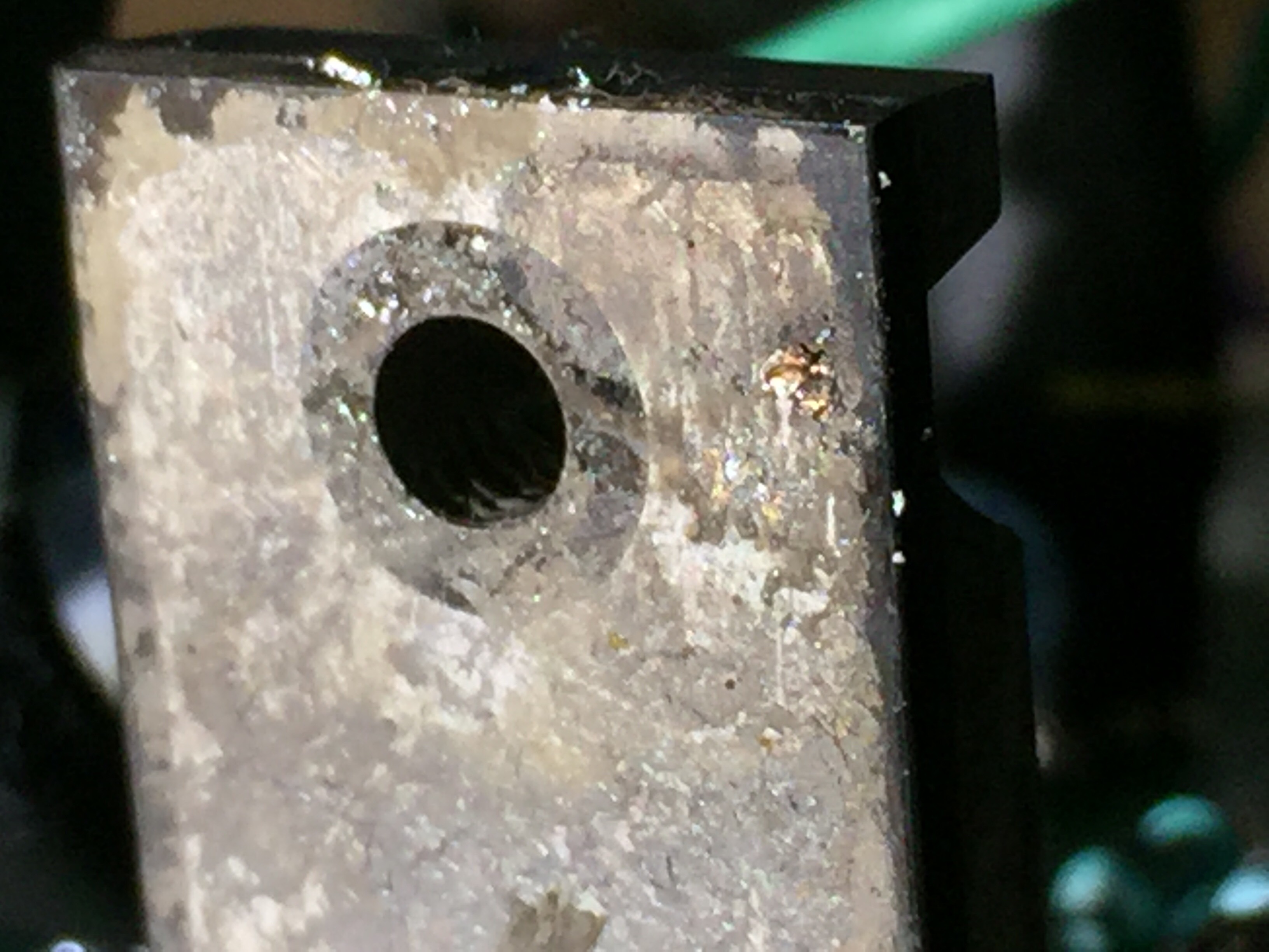

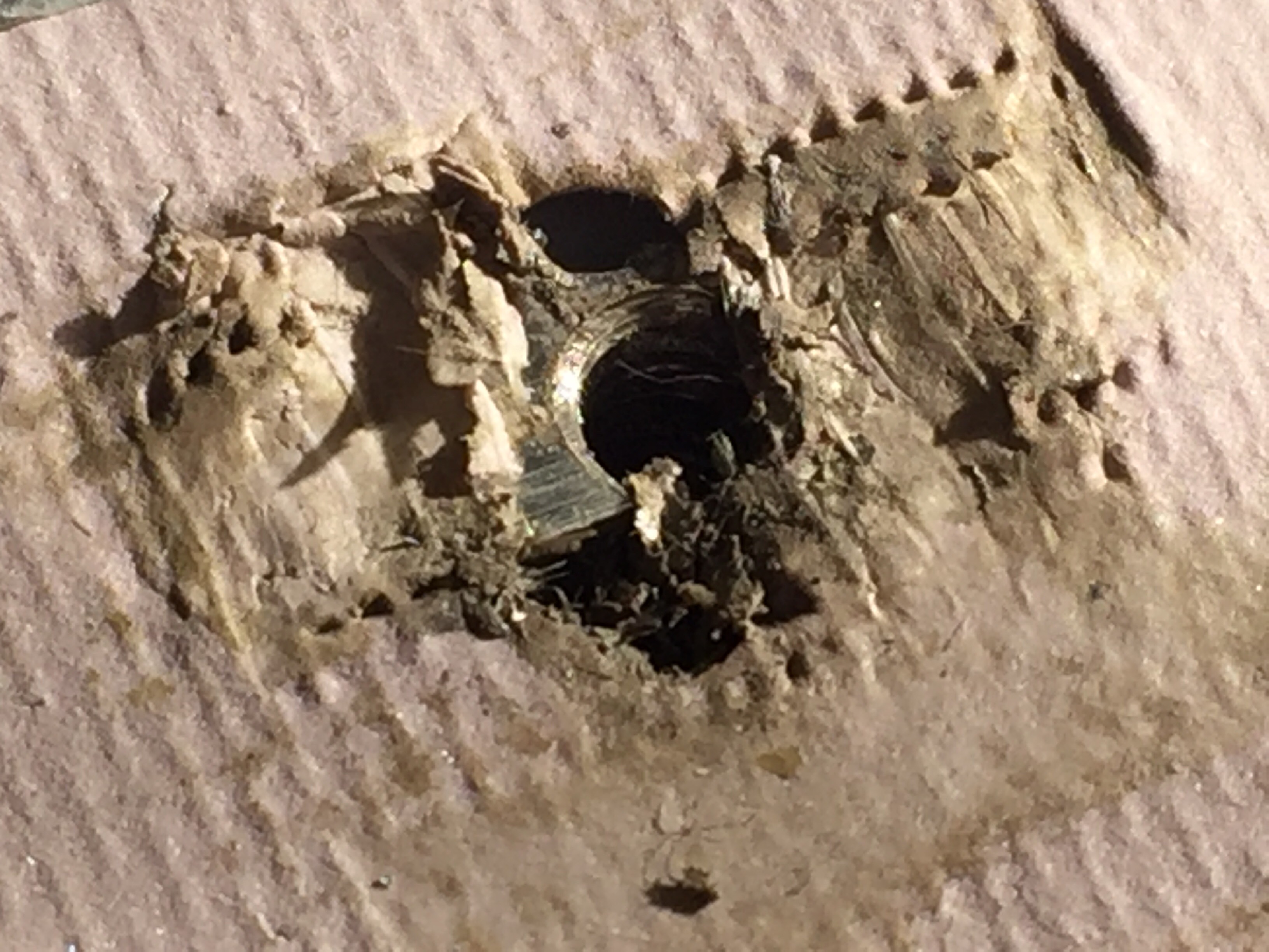

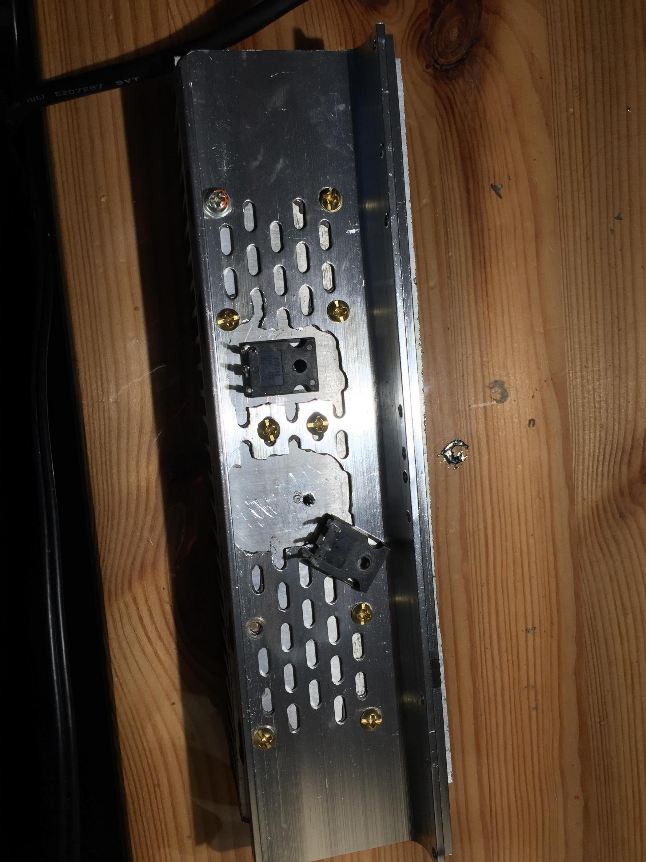

Looking at the photos your issues appears to be the interface between the back (flat metal) of the Mosfet, the insulator, and the heatsink fact that it attaches to - all of that must be very flat to get the heat out of the fet and into the heatsink. Things were getting too hot, the interface failing, then the mosfets were shorting out, pulling lots and lots of current, discoloring resistors and burning transistors.
Cut away more of the perforations, (you were totally on the right track!) you don't actually need all of those screws holding the heatsink to the chassis. Clear enough space so none of the perforated metal touches the fet, insulator, or fender washer. Make sure the heatsink itself is flat and smooth. If it's not, the heat will have to conduct through greatly reduced area, making the mosfet itself really hot.
You need new insulators, those are dead. Make sure the fets, insulator, and heatsink face are all clear of metal crumbs or shavings when putting it all together.
3rd time it was cleanand flat
3rd time it was clean and flat, nothing touching, I ohm first to make sure no short before applying power.
question, is there a problem with this insulator pads if tighten too much it pinches through. is mica tougher?. I'm sure I did not over tighten 3rd time. I chamfered the hole I drilled for the screw. I drew a flat razor across the surface to takes down any high spots and confirm it was clean and flat. There is a good 1mm+ clearance all the way around the transistor.
My knowledge is not yet enough to fully understand, but is there a component that could get damaged by the first two melt downs and cause thermal runaway of the transistor?.
My next test on the 4th pair of transistors I will attach individual heat-sinks no pads separated apart so they can't short, run a fan on them for a day off the chassis. When they pass that test then I will remount them. I'll keep you updated. thanks.
PS. Are MICA pads more durable?
Did you re-use the pads? They had holes in them...
The pads are not just for thermal interface, they are electrically insulating as well. The flat metal part of the Mosfet is connected to drain, and needs to be insulated from the heatsink.
Yes I used new pads I bought the little kit for $19 that came with many extra pads. Yes I know they are electrically isolating because the back part of the transistor is hot. I was actually going to run them separately on small separate individual heat sinks isolated off the chassis. The heat sinks were going to be individual separate from each transistor so there’s no possibility for shorting during my burn in test, prior to remounting the board back into the chassis on the singular main heat sink.

I believe that 6L6 is correct about the perf mounting surface. The mounting surface must be continuous material without the perf holes. Those hole allow for local hot spots on the mosfet, burning thru and making a conductive path. As 6L6 suggested, cut the perf area where the mosfets mount. This gives a flat and smooth mounting surface making for evenly spread heat transfer from the back of said mosfet to heat sink. This will eliminate those local hot spots.

You don't have a rail fuse at the 24V? .....e.g. a 2A or 3.15 A (F)ast fuse?
I think such a fuse could have saved you for at lot of smoke.....
The SM PSU probably have a built-in overload protection. A linear PSU with a lot of uF has a lot of energy so I think good to have some kind of protection.....if you have a fuse at the 24V I wonder why it did not blow....?
