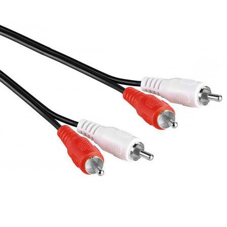

Yes, use this ones, only 1.45 $😀😀😀
The reason I like cables that cost a bit more than the cheap standard cables is that I like a good RCA connector (e.g. with twist lock). I have had some bad experiences with the cheap ones. Once I burned a DC coupled amp caused by bad ground connection in the RCA connector. The screened cable they use in the cheap interlinks is just fine.....I think.
