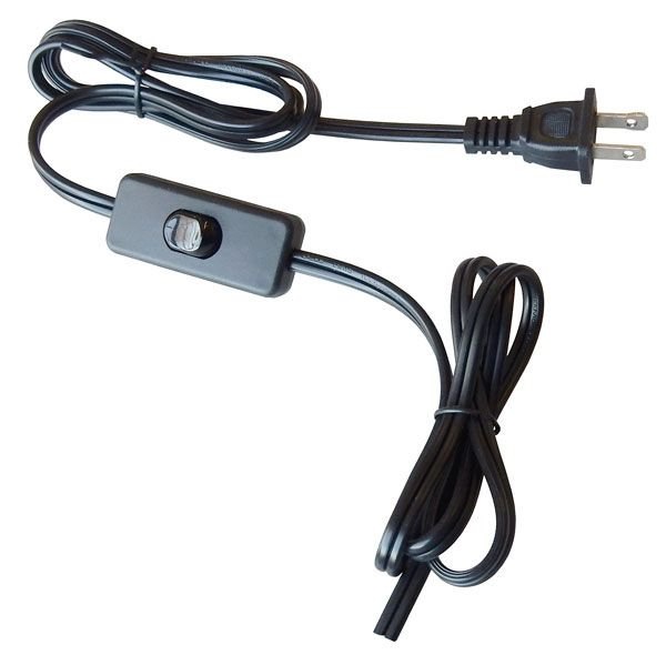

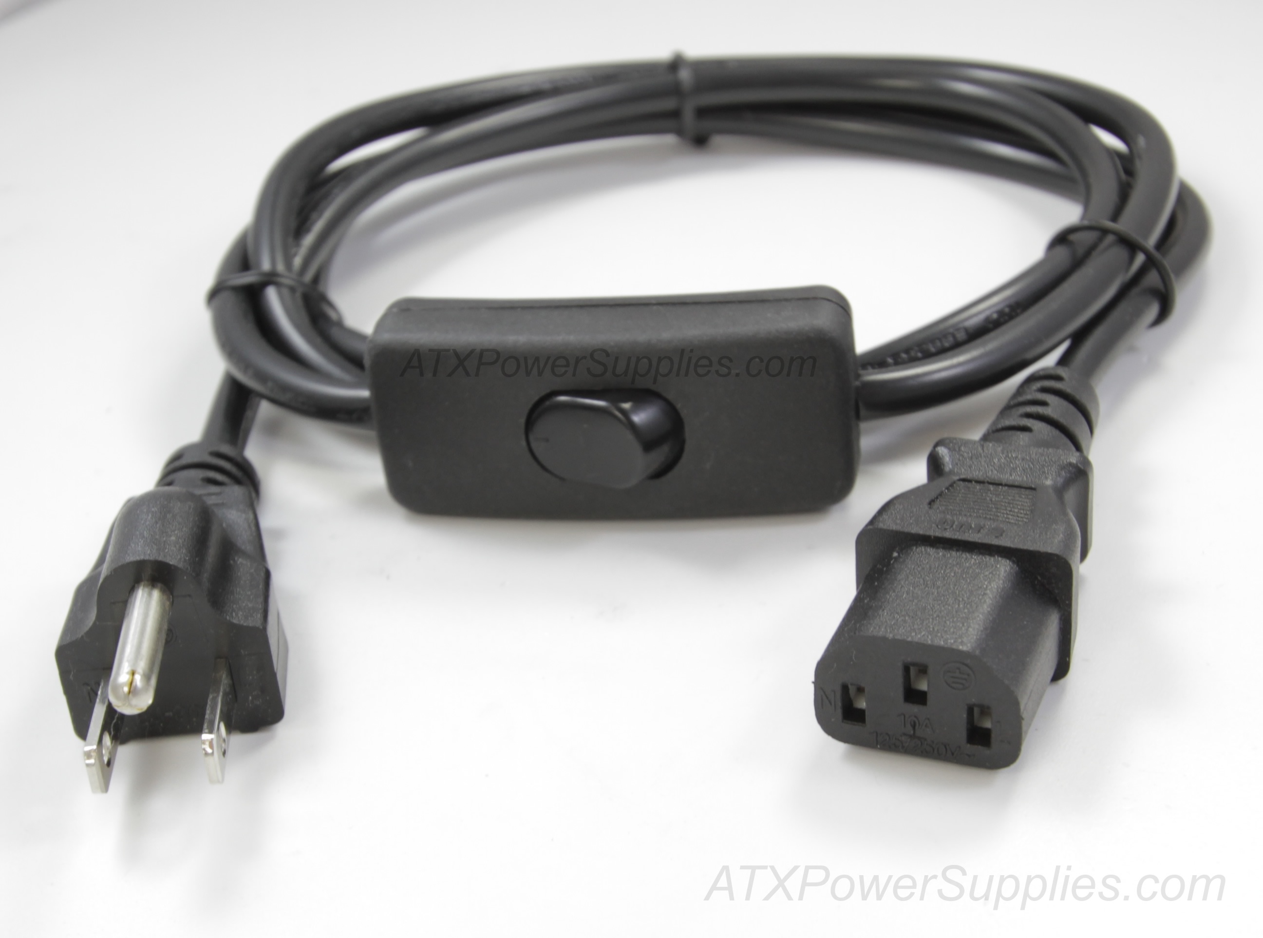

Here's a possible solution for your outlet issue - 😀
24v for the amp is worth it.
Yes, you could daisy-chain the power through the B1.
Yeah, have one or two of those. Turntable, three headphone amps, CDP, music streamer, two tube amps, and receiver so far in a 11x11 foot room that shares an office desk and guitar gear. Looks like I’m starting a cable supply company behind the rack 🙂

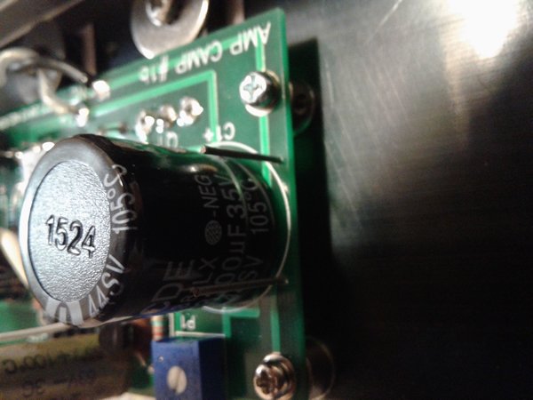

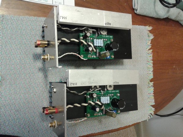

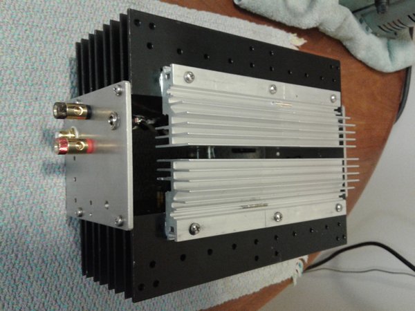

Finished last night, biased first try each half, 10.1vdc as per original design specs at 19vdc. Presently using wall warts supplies, but have built a linear supply for future fun. The enclosure is made of salvaged heat sinks from the dumpsters, built as two separate half of the whole. Removing 4 screws give access for mods and maintenance. Two posts are mounted next to the output cap to allow future bypass experiments without violating the circuit boards. I did use better quality parts near the input and feedback, hoping for a nice return in sound. Yes, this little guy sounds very nice. I am surprised it handles the 91db speaker as well, with enough power for most listening sessions.
The result of this project motivates me to build either an M2 or F4, it's that kind of experience listening to this type of amp.
Thanks Papa, and to others here on DIYaudio!
...very cool, Optimationman. Nothing feels better than using salvaged parts that would otherwise be dump-landfill for audio projects. I've used salvaged butcher block for speaker cabs and cherry ply packing material for vaneer. Well done!
optimationman - That's fantastic! Love the layout, and love the use of salvage sinks. When something is made from recycled bits and is attractive as your amp, that is DIY at it's very best. Bravo!!!
