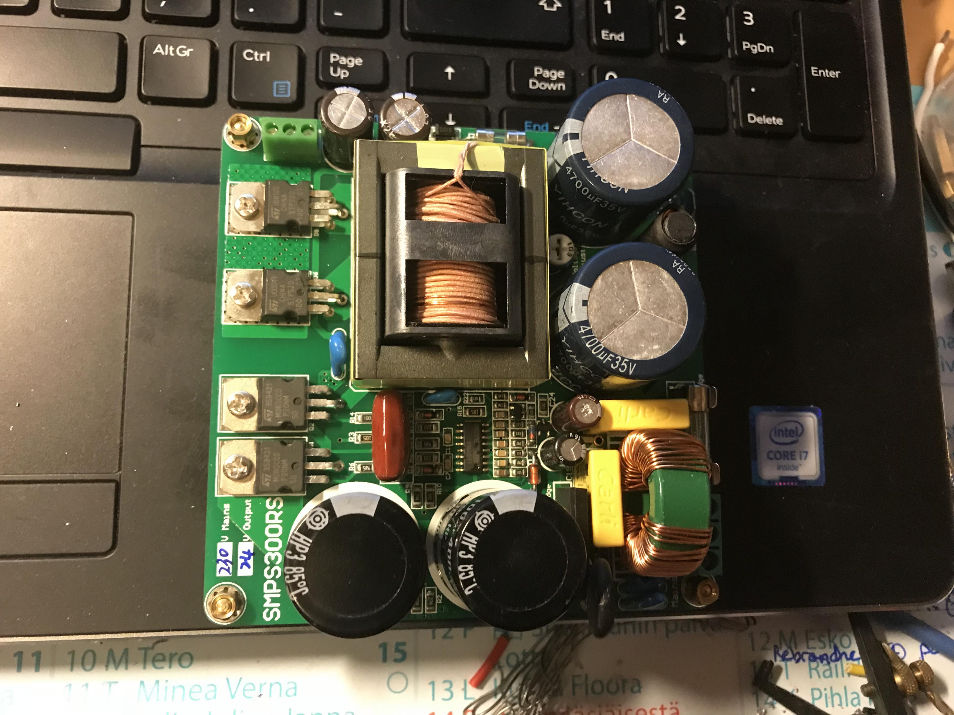

looking for old laptop bricks, i found this SMPS300RS, i had from a previous project, this is quite power full PS able to deliver up to 300W at 24V.
this is quite small and would fit in my chassis to power un both channels!
i am just wondering if it is really the right choice in comparaison with 2 bricks at 19v 3,5A

I have one of those as well and as far as I remember it’s said in the documentation that a fan is needed when pushed to high current. Just cross check before frying it[emoji33]
