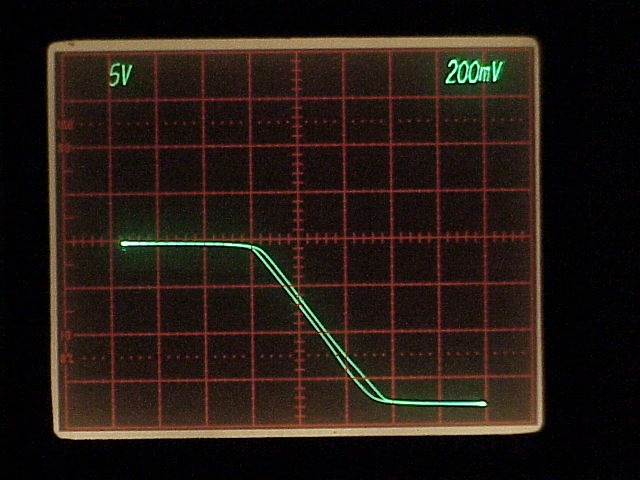

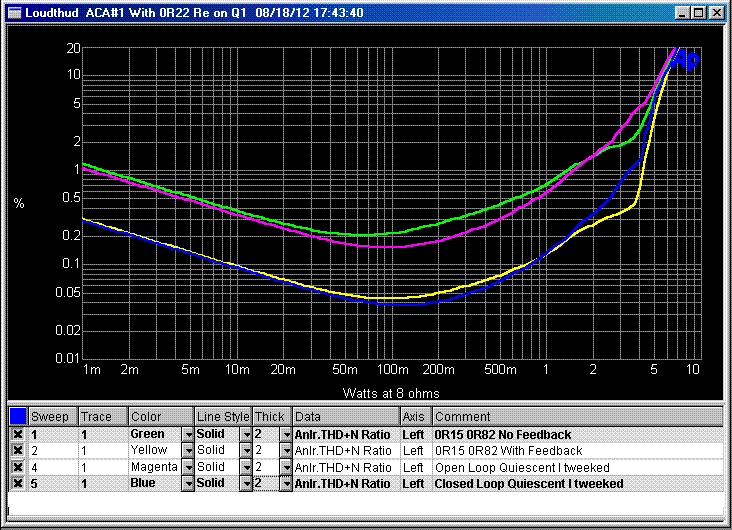

Somewhere along the line, someone pounded into my head the idea that you should make a circuit as linear as possible, then apply feedback. To that end, and in view of my previous post #274, I have been playing with the R1/R2 and R3/R4 resistors.
It looks like R3/R4 wants to be 0.82 ohms and R1/R2 0.15 ohms. This cuts the quiescent current so I added a pot with a series resistor between base and emitter of Q4. I arrived at these values by tweeking the open loop amp, first on the X-Y display, then at 1 watt, 1kHz using the distortion analyzer. If you don't have those resistors available (I didn't) use 1 ohm in parallel with 4.7 ohms for R3/R4 and a 0.22 in parallel with 0.47 for R1/R2. The extra resistor to restore the current turns out to be about 1K.
I had a 0.22 ohm resistor in series with Q1's source, later I shorted it out and it made almost no difference in the distortion numbers. I also adjusted the quiescent current, it had been running about 1.3 amps with the stock circuit, there was a slight decrease in distortion when it was lowered to 1 amp.
What I don't understand is now the distortion rises below 100mW. The stock circuit keeps falling to around 1mW. Am I picking up noise?

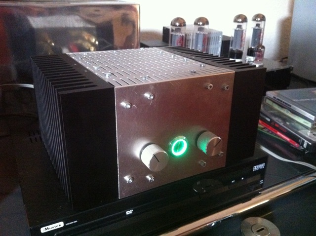

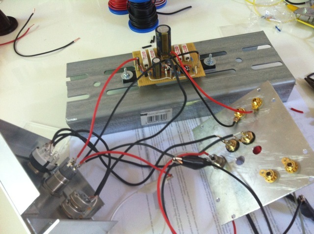

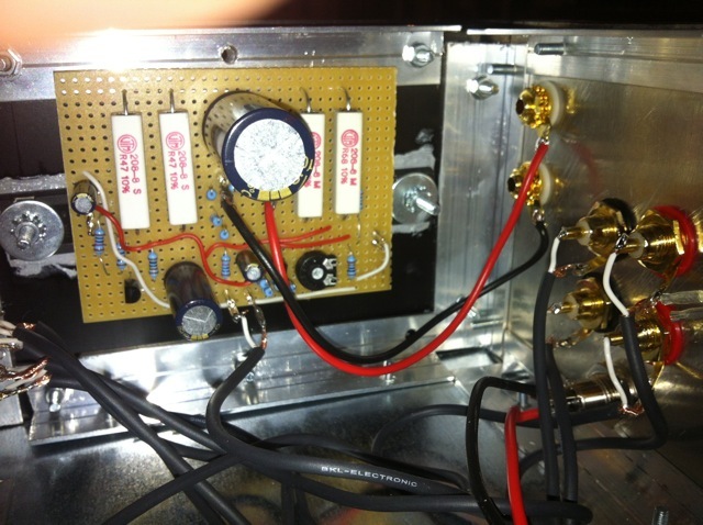

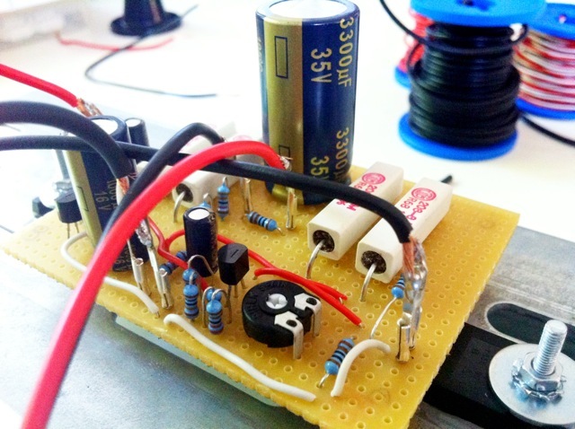

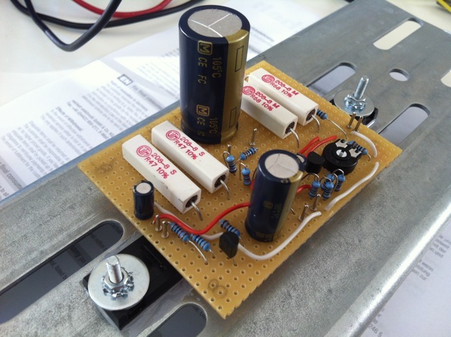

I've given a try on building a stereo version of the ACA with a high-end preAmp (in form of a 22k pot an a source selector switch :D).
Really a nice device, although, as it was my first amp of this kind, gave me a bit of a heart-burn watching the Q1 drain voltage on the first switch on - first nothing, then 15v, then back to 10v after 15 secs... :zombie:
Sadly, I own it no more - my 8-yr-old daughter has it now. Maybe I build myself another one, still have a fitting heat sink... :rolleyes:
On the pics you see first the later right channel on a "test" heat sink, the first test run, then the left channel already on the final heat sink, and the completed assembly (and yes, that's a set of EL34s in the background :D)
