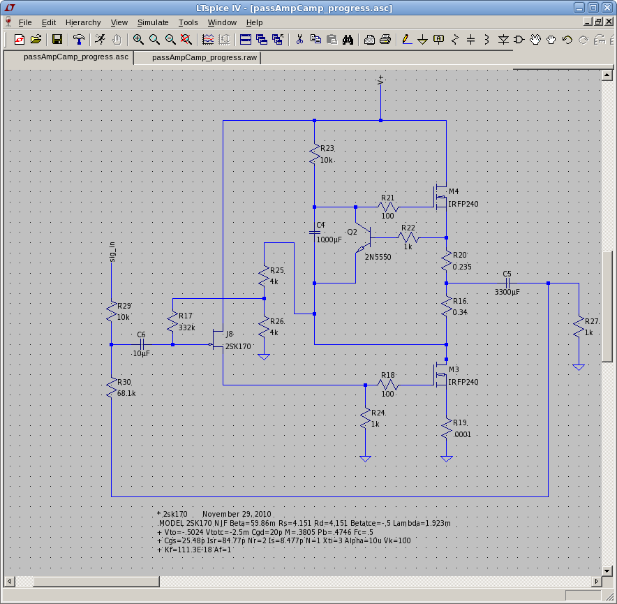

damping factor sim
I though it might be quite a tease to simulate the circuit and measure the output resistance on the simulation. Disclaimer these simulations are mostly accurate but sometimes like a republican campaign speeche it can differ from reality by a vast margin. The actual measurement by Mr. Pass and or others on the actual amp supersedes these simulations. I am using a method described by Rod Elliott of Australia on his Elliott Sound Products - The Audio Pages web site where the output voltage is measured across a known load and with no load attached. Then the following formula is applied:
Vu=Voltage out un-loaded
VL= Voltage out loaded
RL=Load resistance
Zo = Output impedance
Zo = (Vu - VL) / (VL / RL)
I am assuming most people are building the amp camp to drive full range drivers or at least high efficiency drivers. The multi-way speaker crowd usually want an output impedance as low as possible (zero point something proceeded by several zeros). For full range drivers we want a little higher output impedance something more like a 300B amp which I have seen quoted with damping factors between 2 and 6. Converted to output impedance it is between 4 and 1.3 ohms. I personally use an 8ohm power resistor on my class-d amp to make it sound more decent on my Fostex 6” drivers. My observation is that the value is not super critical as long as it's a few ohm, though I don't have the power resistors to try values higher then ten ohms.
OK, lets get to it:
The value is it is drawn by Mr. Pass is:
Feedback NetWork 10K/68.1K
Vin = 0.5v @ 1KHz
Vout@8ohm load = 2.49509V
Vout@1Kohm load = 2.88103V
1.2374385 = (2.88103 - 2.49509)/(2.49509 / 8)
6.4649677 damping factor = 8/1.2374385
The value given by Mr. Pass is a damping factor of 3 which would be 2.66 ohms. The value I simulate is off by 1.4ohms not that much, but I don't think I could hear the difference between one ohm more or less. If we assume the simulation works perfectly the difference can be explained by the model picking slightly different transconductances for there parts compared to the lot of parts used in the true build (just speculation).

Sorry I don’t have the simulator in front of me at the moment (I am at work). I should have stated that I made the rail voltage 18.5v instead of 19.5v because I have a laptop power supply which is 18.5v@6.5A (that should drive a pair of these).
Those two resistors are substituting for the trim pot, I adjusted the ratios up and down until I see no clipping (top or bottom) with an input sine wave of 1.5v. I think it’s about half the supply voltage. But I can confirm in my next post.
The true value here will depend on the gate to source threshold voltages of the input and bottom fet, those will be different for every device, you grab from the bag. That’s why a trim pot is needed there. If the amp goes into clipping this measurement method will not work, so I made sure to stay out of that range. I retested with two input voltage ranges (0.5 and 1.0v), and the variation in Zout was small, just to double check myself.

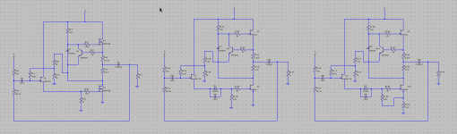

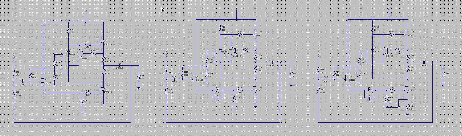

I am trying (simulating) other topologies which are very similar to this. Well it seems like we have some time before we get the kits. I am working with models of power Jfets. I found 4 different input stage topologies that will drive the same Amp camp power stage without needing a negative supply. They are differential p-jfets (like J2), p-fet with source feedback (like JLH), n-jfet with source feedback (using folded cascode to flip polarity (like 1/2 of original x amp patent)) and, normal amp camp with shunt voltage reference added to jfet source. When I find time I’ll draw them up and present my findings here if anyone is interested. Sorry I’m a bit of an armchair engineer

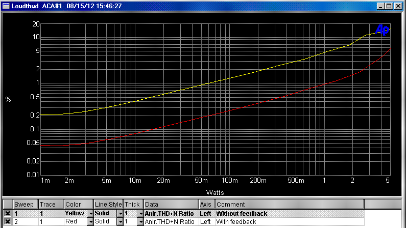

Here is a plot of distortion with and without feedback into 8 ohms. I just connected the generator with output impedance set to 50 ohms to the junction of R11 and R12 for the open loop plot. The X-Y plot is the input vs output of the open loop amp. With the loop connected, the plot looks like a straight line. You can see the gain is changing (slope of the line) therefore, the output impedance must be changing. This makes sense because the gain of Q1 goes up as the current increases when Q1 pulls the output low.
