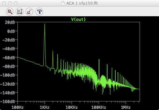

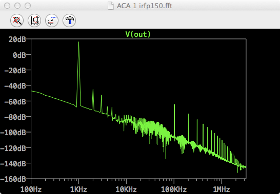

Does anyone know if I can change C2 to 100uF? In LTSpice simulation it appears to produce lower distortion than 1000uF. I'm using IRFP150s with 32V supply.
Thanks.
Thanks.
If lower distortion is the goal, the quality of C2 is probably more important than the value. Simulation might not reveal this.
The extra Gate capacitance of the IRFP150 will cause an increase in distortion at high frequencies. Have you tried adjusting R4, R5 and R9?
R1-4 have a major effect on the 2nd order distortion and overall linearity. I have experimented with these and plotted results in this thread. See posts 274 and 284.

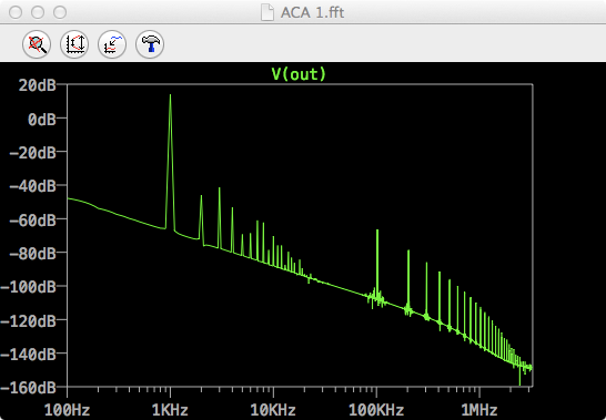

I wouldn't say lower distortion is THE goal, but of course it's preferable to higher distortion. The goal is just to have a working amp that sounds good... whether that can be achieved with the IRFP150s I don't know. I guess I'm the guinea pig. I chose the 150s just for a little more oomph, and to try something different as I've already built stock ACAs.
I'm probably the wrong person to be trying this mod since my knowledge of electronics is pretty thin (my forte is in the fabrication). However, as I said before, this is low cost/low risk experimentation, and I can alway swap in the standard components if it doesn't work. If nothing else I'll learn a thing or two, maybe.
I'll try tweaking the R values you've suggested and see what the simulation produces. (BTW, did you mean R6 and not R4?). Of course I realize that it's only a simulation and is of limited value, especially since I'm not really sure of how the graphs relate to real-world performance.
Just for kicks, I've attached some FFT graphs. The first is the IRFP150 mod with C2 = 1000uF. Second is C2 = 100uF. Third is the original ACA as designed by NP.
