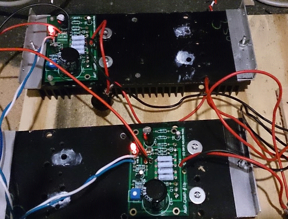

Having updated a pair of boards I had a pair left laying around. Dreamed up this to combine the mono blocks into a single chassis. This does require active (fans) cooling as these heat sinks aren't quite big enough.

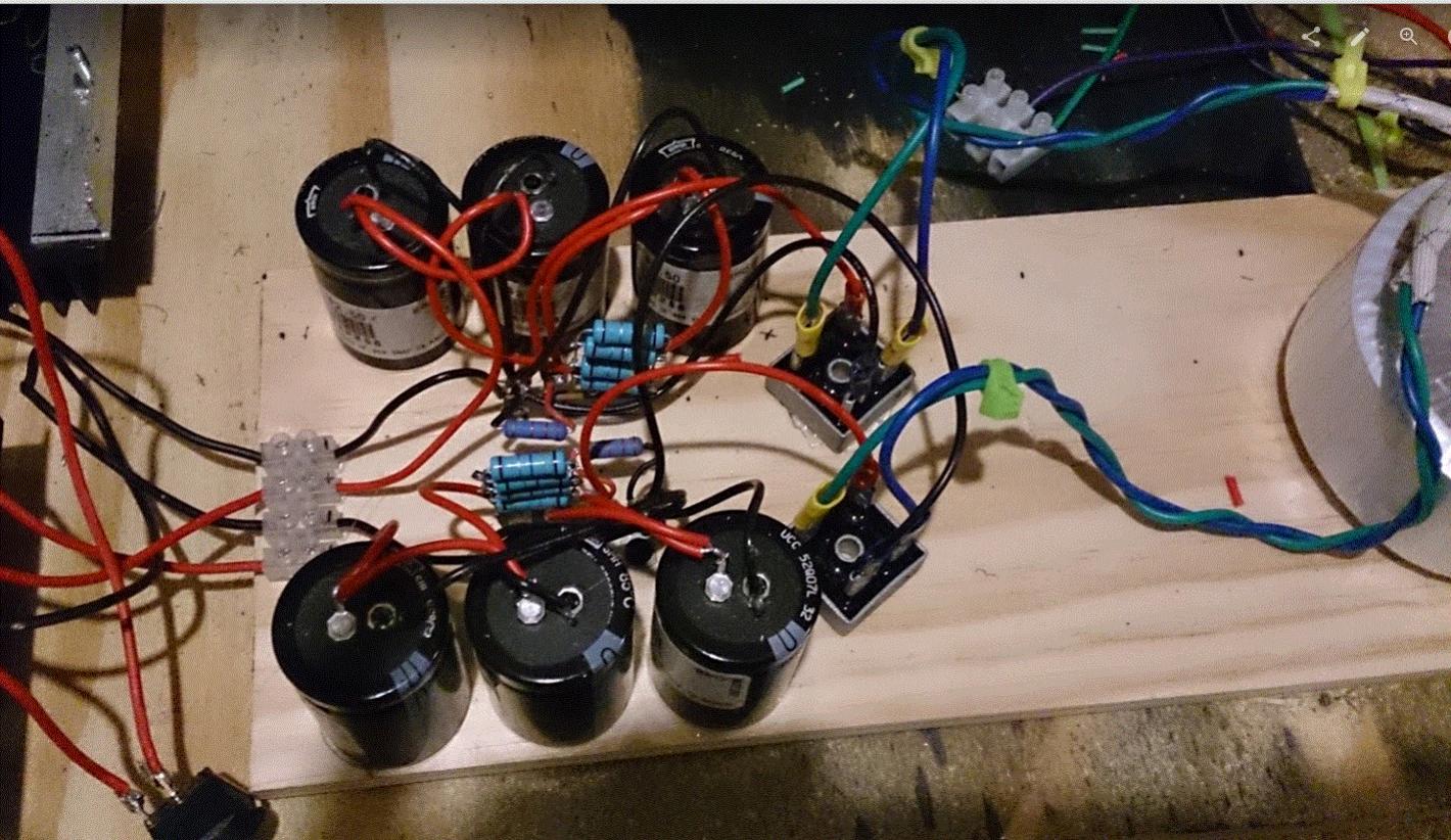

I have another project going where I will be using point to point wiring, so I built a "standard" Pass Power Supply with a point to point approach and a 15V transformer.
Used tag strips and 600V wire to put the whole mess together. The .47R resistors are in a free form ladder. While not shown, I use the thermisitor/capacitor/thermistor as per the schematic. The caps are some from one of the last true surplus electronic stores in Houston.

Finally getting around to getting mine in a chassis.

Yes, they are. Don't ask if they are hooked up - to anything! Thought it would be fun to just drop a couple in the holes.
Final version: Fans are running at 7 volts - should be around 6db. Can't hear them until you stick your ear in the blades. They are attached with some clear 3M mounting tape. Runs just warm to the touch.

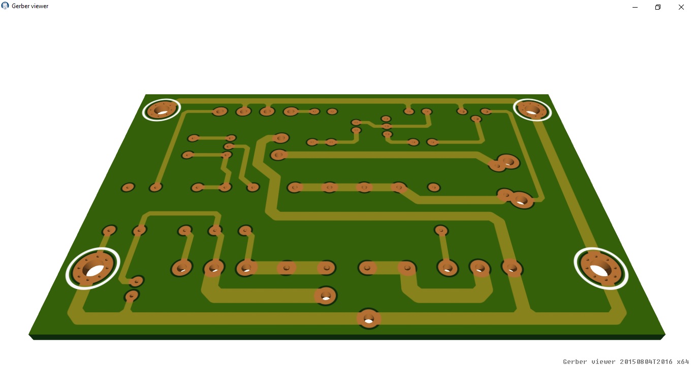

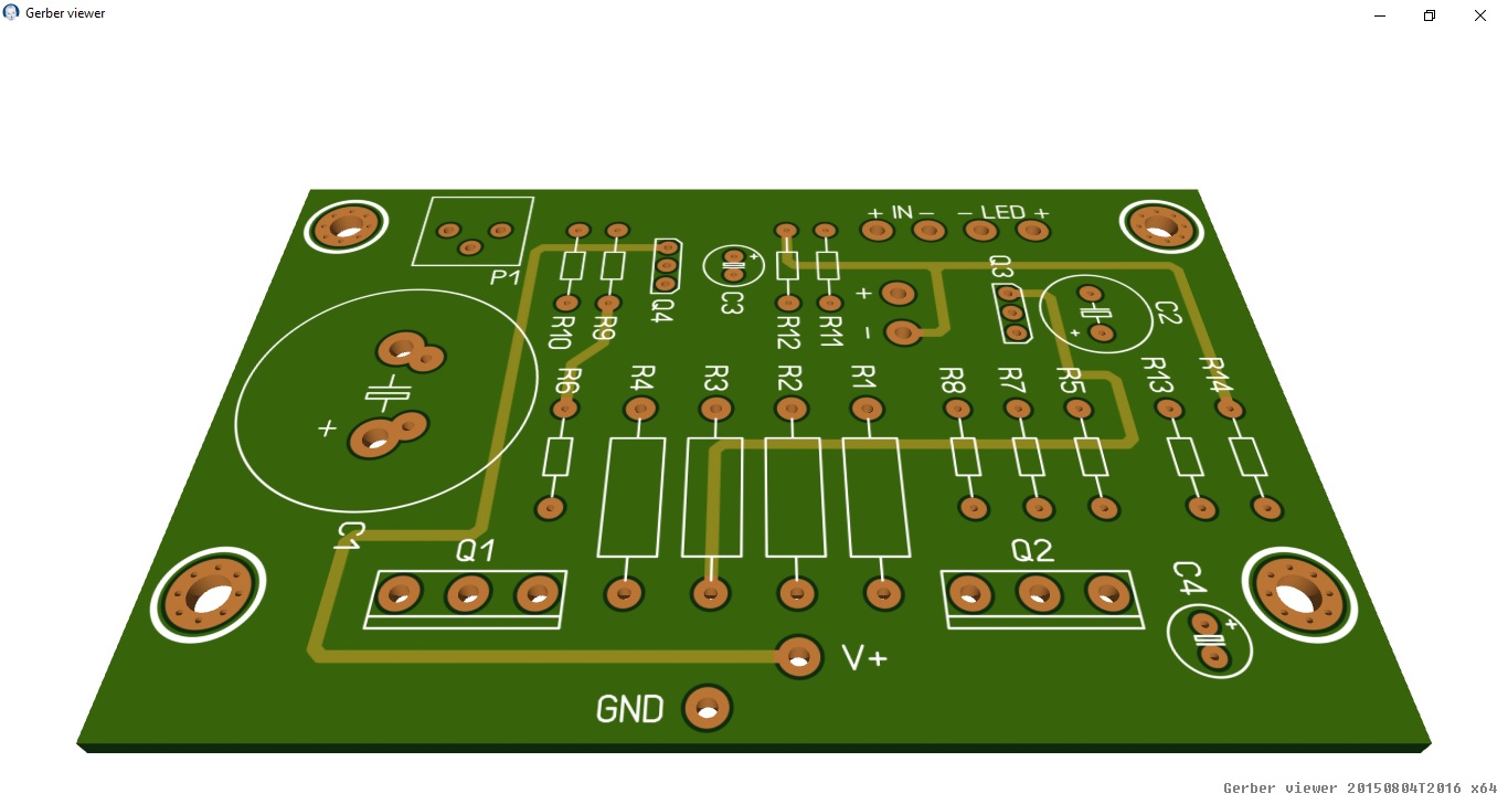

Hello. Does anybody have the Amp Camp gerber files for this pcb?
I have drawn the PCB some time ago. However I'm not sure if it is allowed to upload the gerber files (copyright?)
