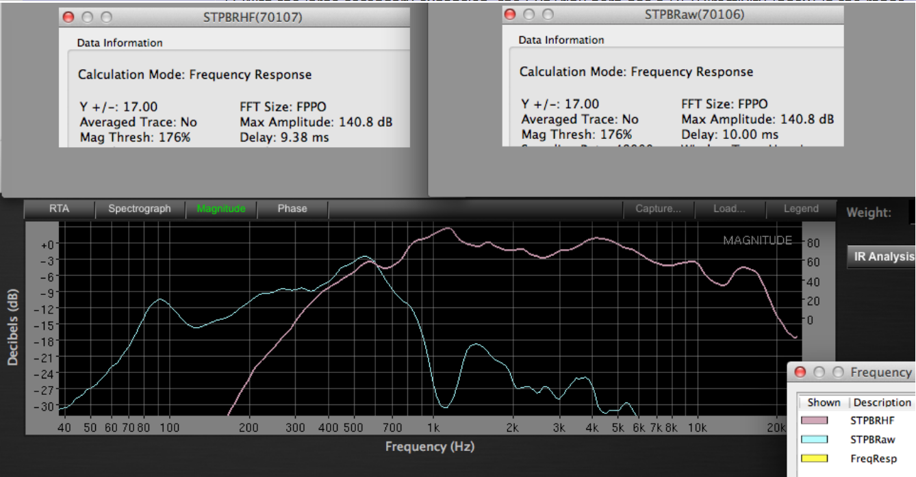

Mark,Hi Chris, the 11cm measurement is a timed acoustic measurement from the 4594's mid section to the mounting flange, not simply a mechanical path length estimate.
Looking back at measurements done on my SynTripP MEH (multiple entry horn), found that though the HF driver acoustical center is physically further from the measurement mic, it's output arrives .62ms before the BP (band pass) LF output. The combined raw output of the two 10" with the 3" diaphragm HF driver, no crossover used at all results in a relatively flat phase alignment as can be seen below.
It's even possible that Chris' MEH might eliminate or reduce the delay required by reversing the mid/high polarity- without doing the math (which I'd probably hose up 😱 ) it sounds like the path length plus the .5ms LF delay used may be close to one wavelength at the acoustic crossover point.

Hey guys, with all due respect, you are making something very simple, very murky.
Diyuser, yes finding a subs acoustic center is very difficult, or better said, relatively difficult to full range / HF drivers.
But it's not difficult in the least, not for a compression driver... not at all.
Patrick, no offense but what you're saying has nothing to do with finding acoustic centers..I don't understand...
Chris, 600Hz, group delay, your plot... ALL are totally immaterial to finding the acoustic path length of your driver.. Please, Just go measure it !!!
Hi ya Art,
Ok, what I've come to be dang certain about...😉
...acoustic path lengths are physical geometry...they don't vary due to polarity, crossover topology or order,... etc.
Period.
I think I know this because I've found the acoustic centers sooooo many times for various multi-way drivers/sections.
Finding acoustic centers is simple and uncomplicated....just use a full range signal.
People get confused because they try to find electro-acoustical centers, with a crossover (low pass) in place.
Those findings are not acoustic centers, and lead people to all kinds of alignment errors, because they conflict/trash the cornerstone of timing....which is acoustics.

There's no electrical crossover filter delay in the measurements posted for the 4592, above. No "named" crossover filters were used.
I'm honestly not sure what you're worried about.
What do you think phase response is? Group delay?

I always use dual channel FFT to find acoustic centers. and have found once properly located, the center can be 'marked on the box' so to speak.
Subs are always a pain to get repeatable measurements, but I think that is more a function of FFT's linear data spacing, and relatively fewer data points down low trying to find peak energy, than anything else.
That said, using FIR, I have found I way to keep distance variability down to a handful of processing samples. Measure a sub's distance with no LPF in place. Then using a FIR filter with a known number of samples delay, implement whatever LPF you like. The new distance to sub's acoustic center simply becomes very accurately, the first measurement plus the FIR sample delay.
Now, because of the paper you linked I'm going to have to get out the tape measure and see where the sub actually is vs measurement !

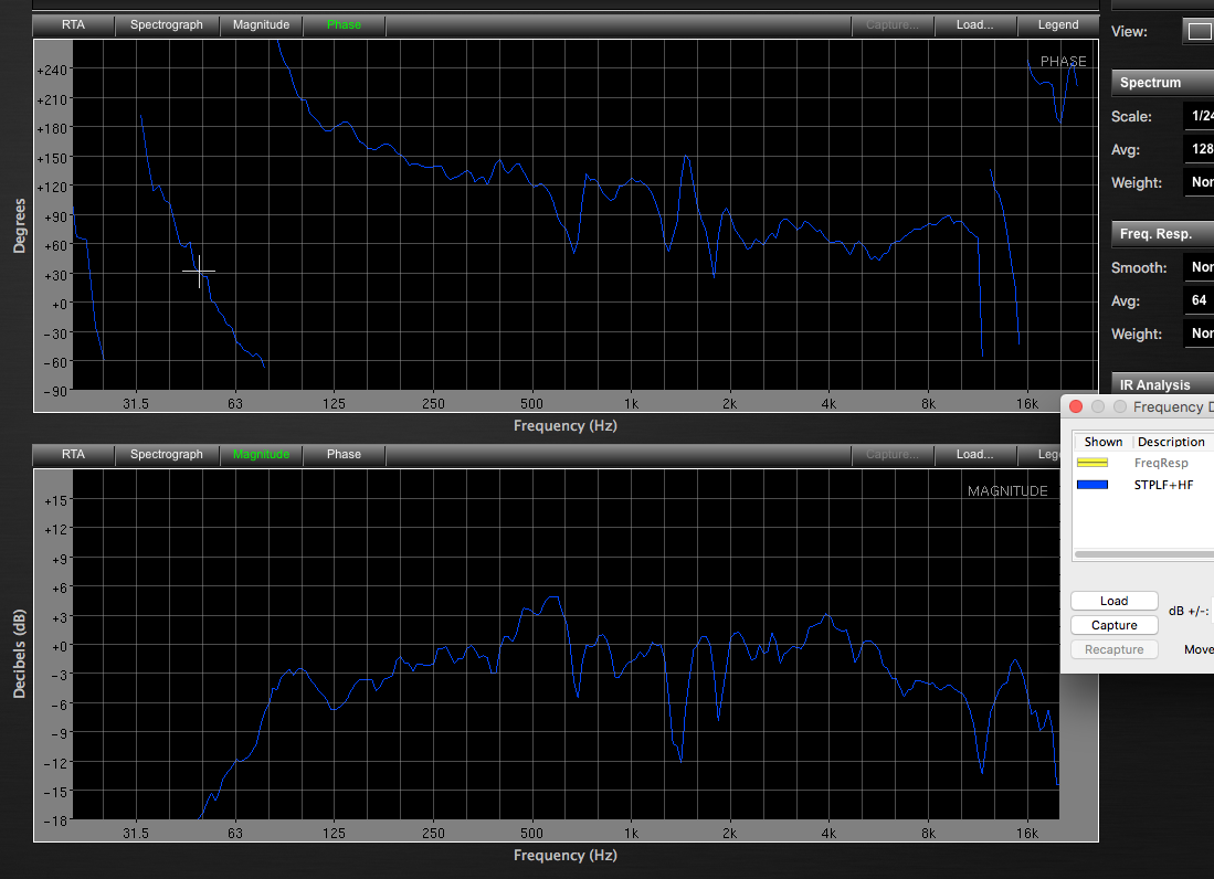

Hi Chris, here's my concern...
Everything I can gather from the unity/synergy patents, TD's posts, great threads like 'suitable mid-range', yours, nc535's, Patricks, Bill's, and many others..... ...all say to keep the maximum distance between the mid range ports and the HF acoustic center, within 1/4WL of the crossover frequency (due to the creation of an acoustic low pass filter near said wavelength).
Now I'm trying to do as you and a few others have done, and skip the mids, using a CD that goes low enough to mate with a woofer. But the same 1/4WL rule should apply, shouldn't it?
When I go to determining where to put the ports, by laying out the distance to the CD's acoustic center, it seems to me I need to know exactly where that distance begins (apex/HF acoustic center).
So, to even begin designing, I put a mic even with the mounting flange of my CD, and measure. I get a surprising 11cm. I repeat the measurement at greater distances, backing out tape measure mic to driver distances, and repeatedly get the same 11cm. (That's why I ask you to check yours.....)
When I look at 1/4WL for let's say a 475Hz crossover, I get 18cm port to apex distance to work with. I believe I need to subtract 11cm for the CD's path depth, plus another cm or so for a wooden mounting flange, for a total path of 12cm before even getting to the horn walls. Can this 12cm path be ignored or reduced, and in keeping with the 1/4WL rule?
Because if it can't, I'm down to 6cm of room to try and fit the woofers' ports.
It just doesn't look like it can work...and stay within the acoustic low pass design guidelines.
That's my concern.

The relationship of the volume of the enclosed throat chamber, length and area of the cone entry ports determine it’s acoustical low pass. The distance of the cone entry ports from the throat of the horn determine a reflective null, a different concept.
There has been a lot of reference to keeping the multiple horn entry locations within 1/4 wavelength from each other at the crossover point, but the MEH output location and it’s acoustic center regarding time are two different things. Different HF drivers will have different depths, those depths can be time aligned to coincide with the low pass output of the cone drivers entry points. However, if the location of the multiple entry points are not within 1/4 wavelength, off-axis lobing will start to occur due to path (time) length differences, regardless of on axis time alignment.
Consider that the HF “plumbing” on MEH line arrays, or DSL’s Paraline adds somewhere between 8 and 20+ centimeters path length to a HF driver’s acoustical center, at much higher frequencies than you are considering, and perhaps your concern over a few centimeters will be reduced.
Art

Thank you Art !
Yes, I've been talking about the 1/4WL rule as if it were the low-pass determiner, instead of a notch determiner. My bad. I do understand the location of the ports relative to the horns cross sectional area and flare rate determines the acoustic low-pass, not the distance to horn apex.
The problem with the 4594 seems to be getting the ports out to the necessary cross sectional area for chosen xover freq, and also keeping the 1/4WL notch above the chosen xover freq.
The 11cm acoustic depth of the driver appears to eat up too much of the allowable 1/4WL length,... length that is needing getting out the horn to a sufficient cross sectional area.
I've been looking at a 60x60 horn for a start. If I went wider maybe the sufficient cross sectional area needed would occur close enough to apex to stay within 1/4WL. I think the k402 horn is pretty wide...maybe that's part of why it's working well?
Anyway, real question is: where do you think the horn's apex is ? Should I use the 11cm depth for modeling and layout?
I don't know what to think, or how to incorporate the paraline into my thinking...I'm not sure it applies to what's going on..it may be creating an acoustic image well in front of the drivers. When I said in a previous post that acoustic centers are a function of physical geometry, I should have said apparent acoustic centers. The point I was then trying to make is that apparent acoustic centers themselves don't move from polarity, crossover, etc. Sure, the way an acoustic center interacts with other acoustic centers changes, but the point-in-space it emanates sound from doesn't.
It seems to me the goal of a synergy/meh, is to get the acoustic sources playing together as nicely as possible acoustically before having to finish alignment with various crossovers, EQs, and delays, etc. I guess that's my fixation on knowing where to begin with the CD's acoustic center...
