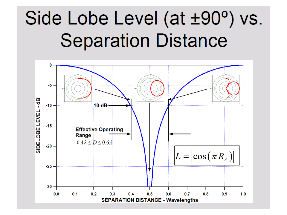

The K402 "works well" as a MEH because it has really good polar response, and even polar response is the primary reason for MEH. A wider angle conical horn will have more cross sectional area near the throat than a narrow one, but any cross sectional area large enough to accommodate the mid entrances is "sufficient", the nearer they are to the throat the better the integration between LF and HF, the goal is a virtual point source.
The horn's apex is the throat entrance, not the time of flight distance to that point. The path length (time of flight) distance from the throat to the HF driver is important in terms of time/phase alignment to the MF output, but with digital delay you are not constricted to distance restraints- you could mount the 2" exit HF driver on a four foot long plane wave tube connected to the throat and still get good mid-range polar response.

Modeling in Hornresp will tell you the first notch frequency of your off-axis port locations (which is a vital piece of information) but not the performance of size of the ports. It won't tell you the on-axis SPL of your woofers but it will tell you the relative performance of woofers in a qualitative way. You'll need to build and test them to see the real frequency and phase responses. That's where a DSP crossover comes in handy: to EQ the output flat below the first notch frequency and to attenuate the response above the first notch frequency.
In the K-402-MEH, that means setting two to three attenuating PEQ filters above the first notch frequency of ~650 Hz: one peak at 1320 Hz and another at ~2600 Hz, and perhaps a third notch centered at 3400 Hz. The woofers and 2" compression driver will couple and act as one driver in their crossover interference band. The other frequency bands will behave like a regular horn-loaded loudspeaker. You can use a first order crossover filter between the woofers and compression driver, or you can simply set the woofer channel delay to around 0.5 ms (corresponding to 90 degrees of phase lag to approximate a first order crossover) and use no crossover filters. The results will perform almost identically in terms of phase and on-axis SPL response in my experience (surprisingly). This is most likely true due to the coupling of the compression driver output to the woofer output. This is a phenomenon that is largely absent from other horn-loaded loudspeakers, i.e., the coupling that takes place between drivers in an MEH.
I would not use any higher order crossover filters than first order, only attenuating PEQs to bring down SPL response peaks. The resulting SPL and phase response of the MEH will get your attention when you play good music recordings having a high degree of phase fidelity (i.e., acoustic music performances recorded with all musicians playing at the same time in the same open venue).
