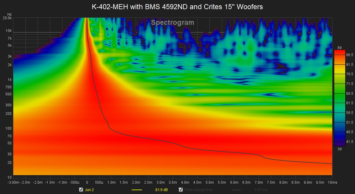

Note that the measurements above were done in quarter space loading--as you would likely see in a home hi-fi environment. If you're talking about full space operation, like is common in PA environments, subtract about ~12 dB below ~100 Hz.
Chris

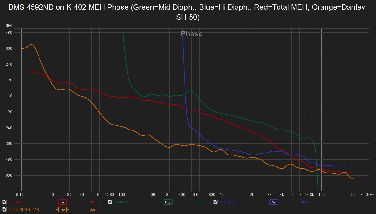

I'm currently using 0.5 ms delay on the woofer channel with the BMS 4592ND and Danley-style crossover filters (i.e., "fractional order")--no phase shifts through the crossovers. My woofer ports are about 4.5" in front of the horn throat. Crossover frequencies come out to 600 Hz and 5720 Hz.
Chris

Hi Chris, the 11cm measurement is a timed acoustic measurement from the 4594's mid section to the mounting flange, not simply a mechanical path length estimate. It seems to me it is a very real addition to the 1/4WL path length ???? You might want to measure your 4592....my bet is the path length will surprise you...it sure did me ! Had to triple check..
(The HF section has about 0.06ms less acoustical path depth.)

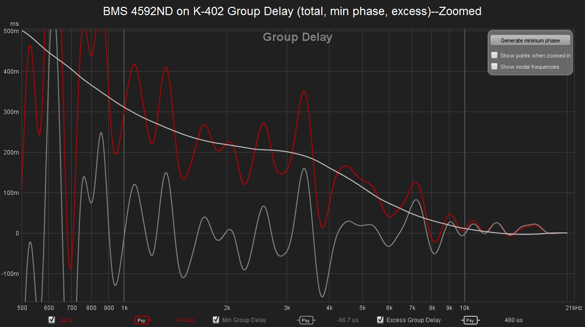

At 600 Hz?Hi Chris, the 11cm measurement is a timed acoustic measurement from the 4594's mid section to the mounting flange, not simply a mechanical path length estimate.
Consider the group delay measurement (total, min phase, excess phase). There is a 450 µs excess GD growth from 600 Hz to 20 kHz:
Chris
