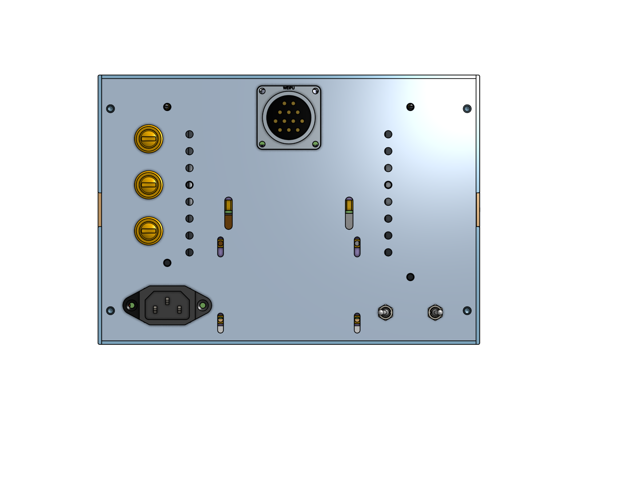

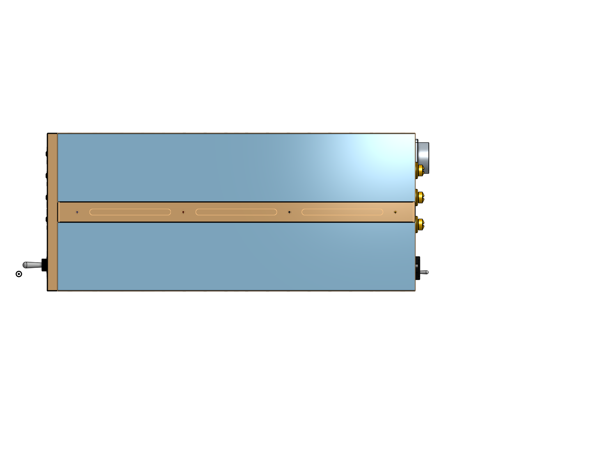

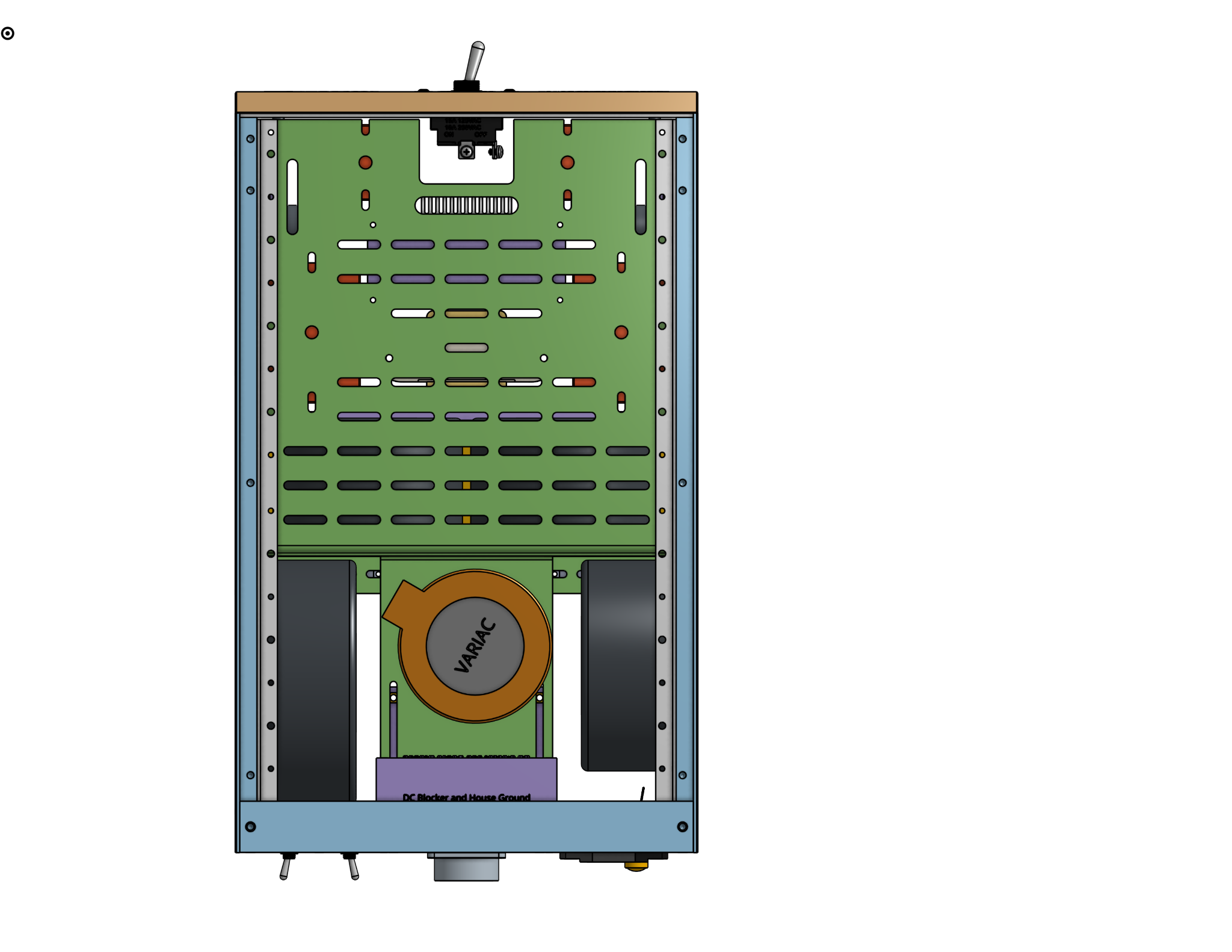

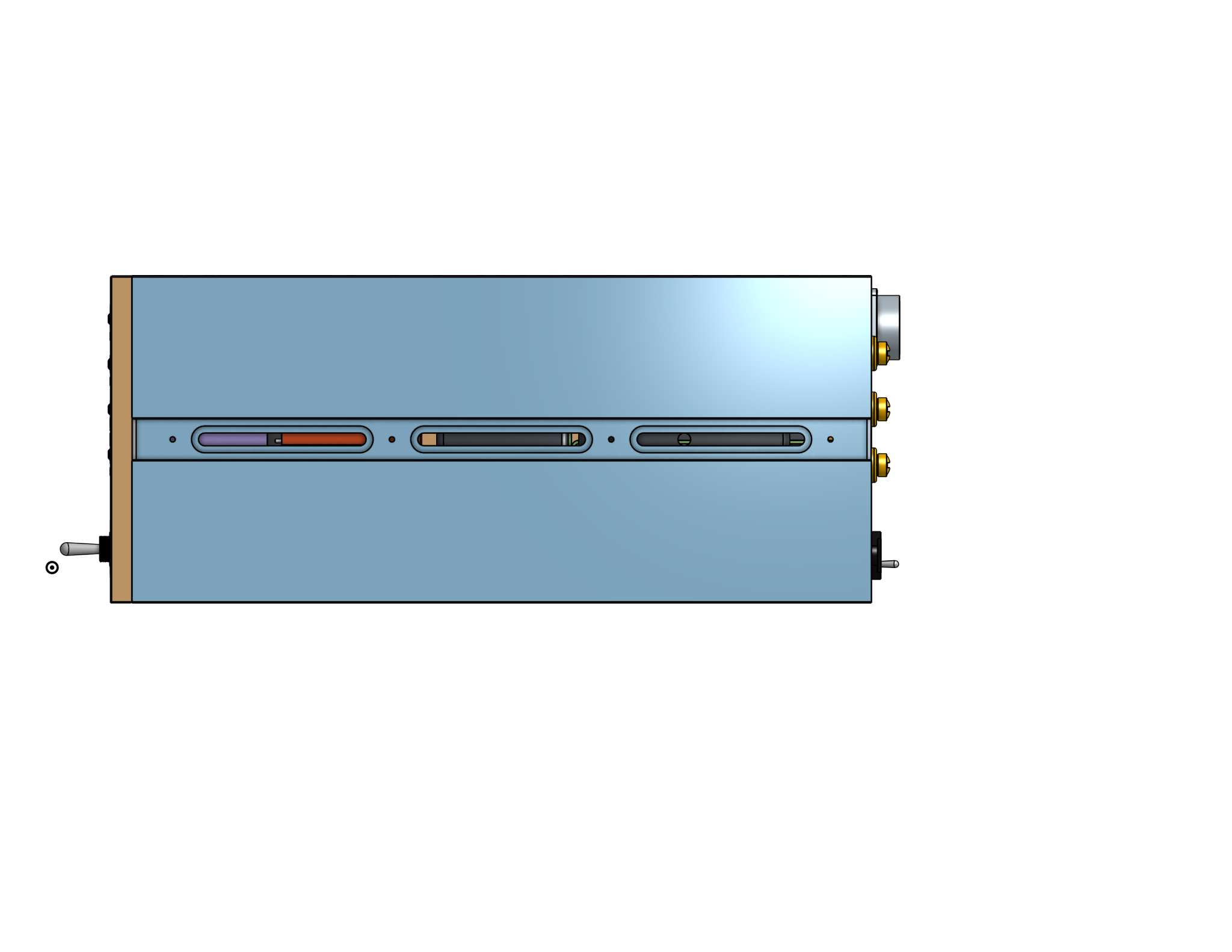

I really want to do a good job with the mechanicals design of the chassis, so I'm trying to capture every single part I need to fit, as well each parts size, as well as construction notes. This way I can 3D model the chassis right down to the size and mounting holes of the PCB's, what parts need to heatsink, access to adjustment pots, positioning, etc. I see now what commercial products must go through. I'll still have more circuit updates before I crack out the 3D modeling, I'm almost ready to 3D model the PSU chassis though.. And I want to draw out a set of alternative driver boards too that use different tubes, etc. to prove that I can "modularize" the driver board to swap boards. The power section topology will always remain the same, IT coupled with direct grid bias, only modularizing the driver boards and ability to change out IT xformer with others. I have some nice grid chokes, tomorrow I want to replace the driver grid leak resistor with a grid choke. And any other changes others smarter than me suggest!

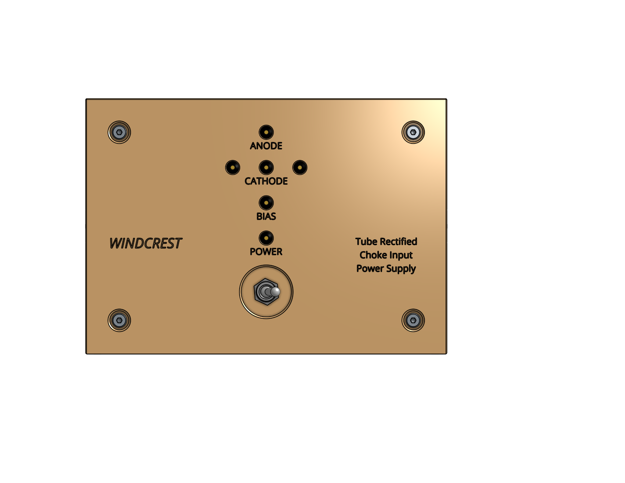

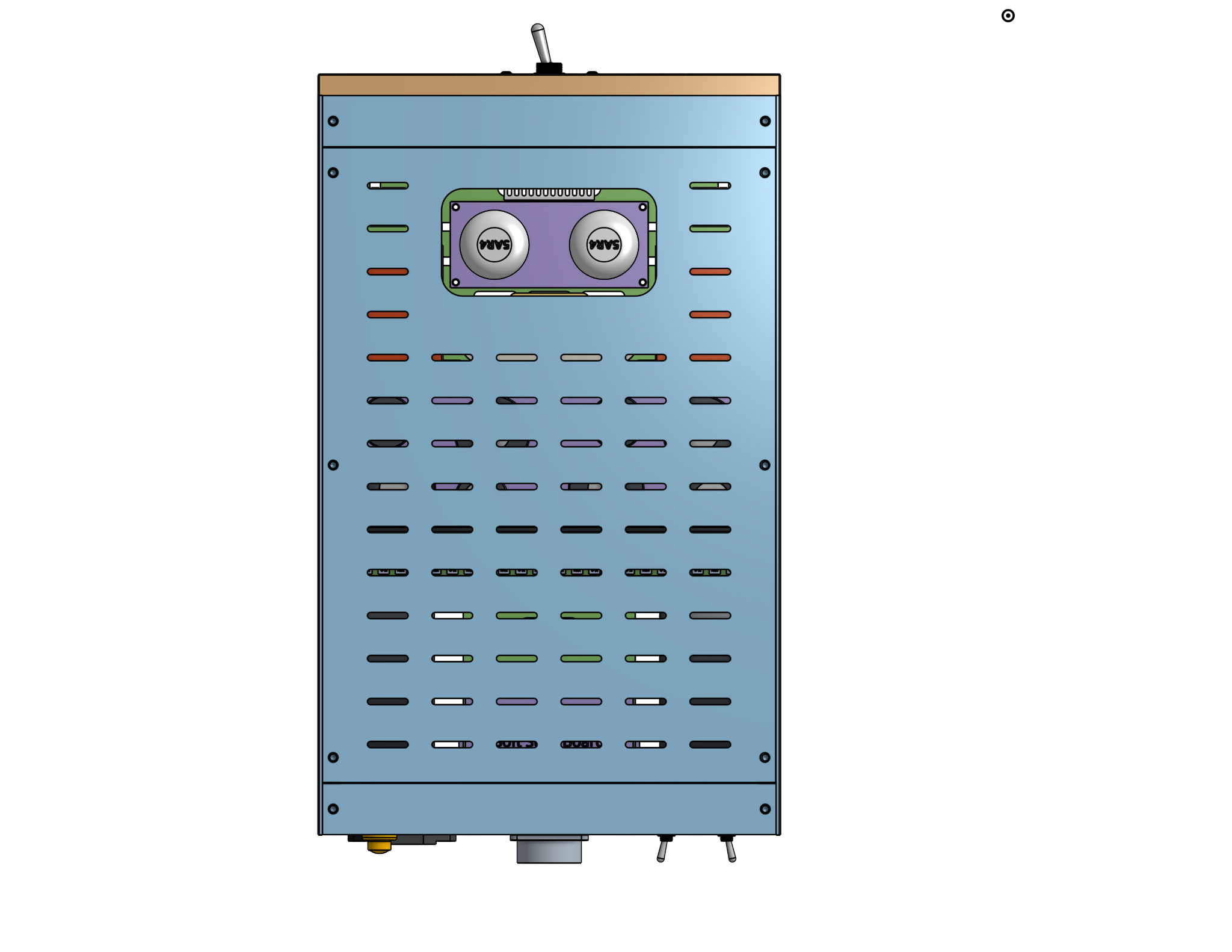

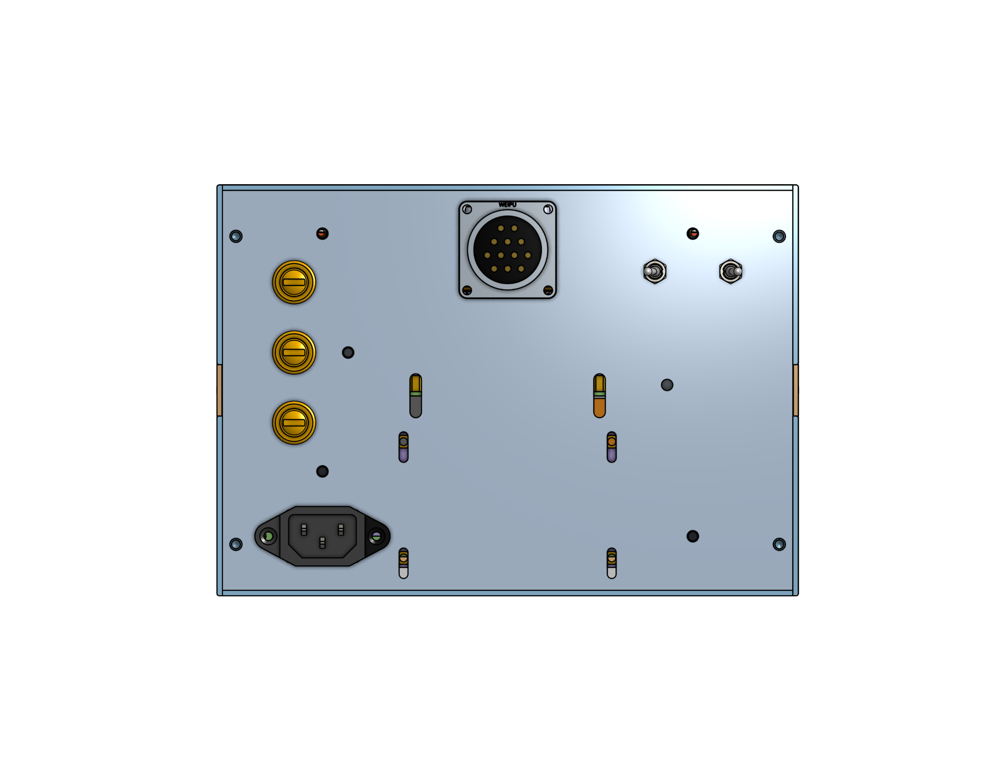

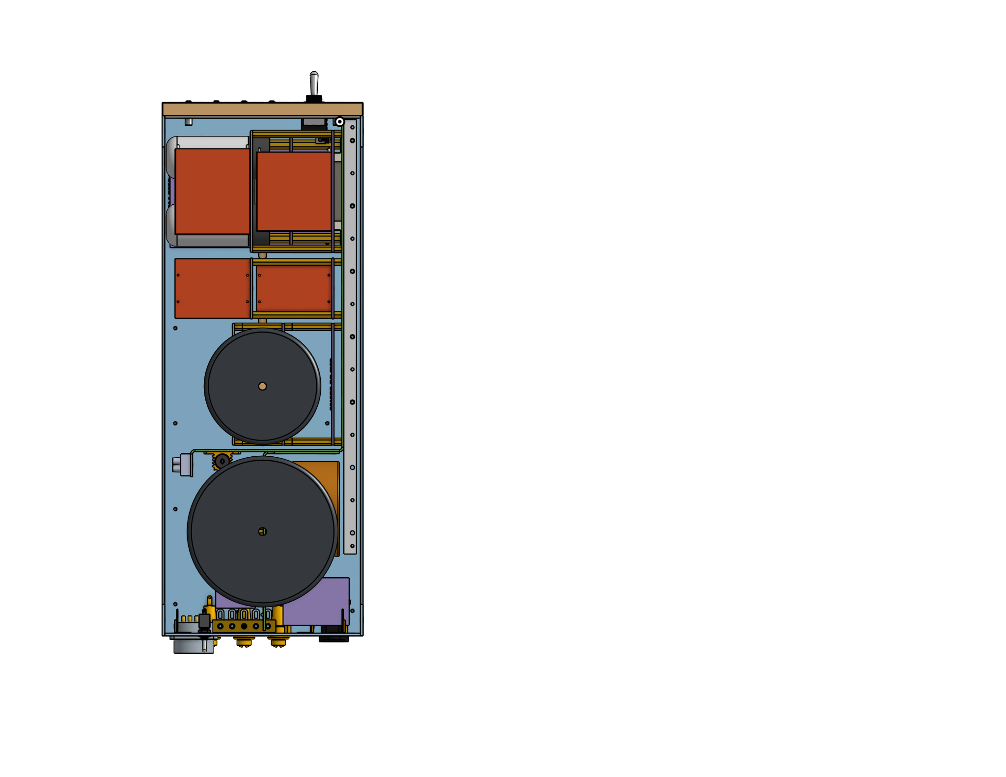

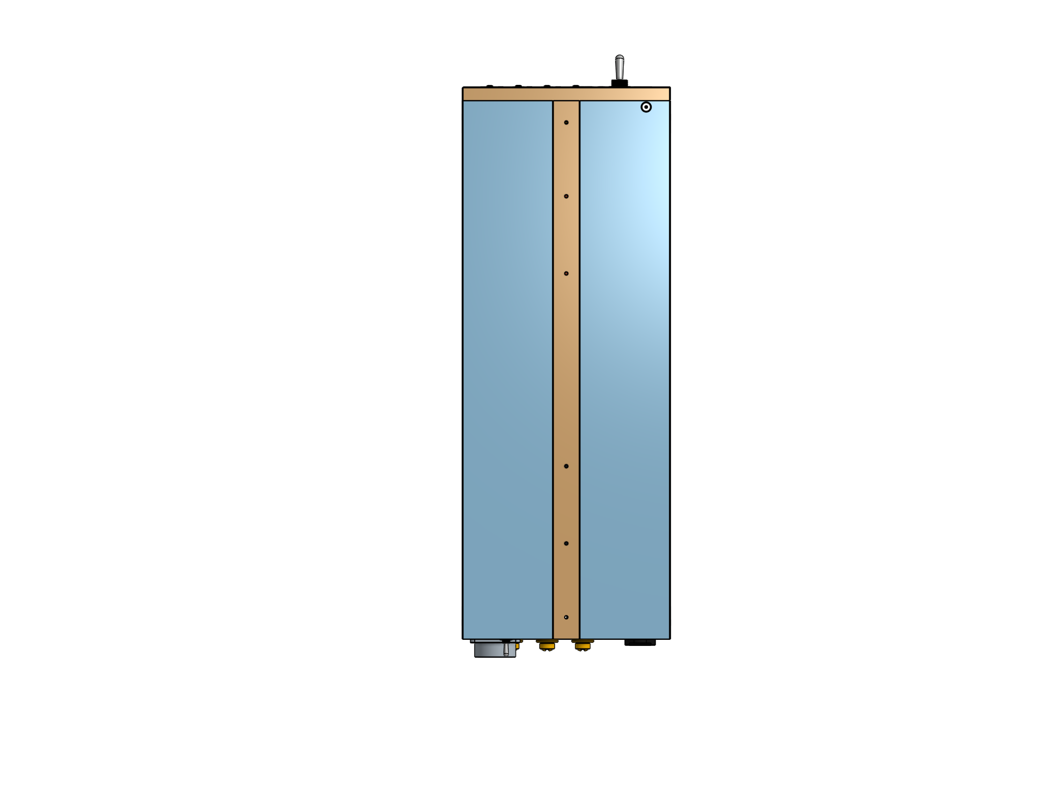

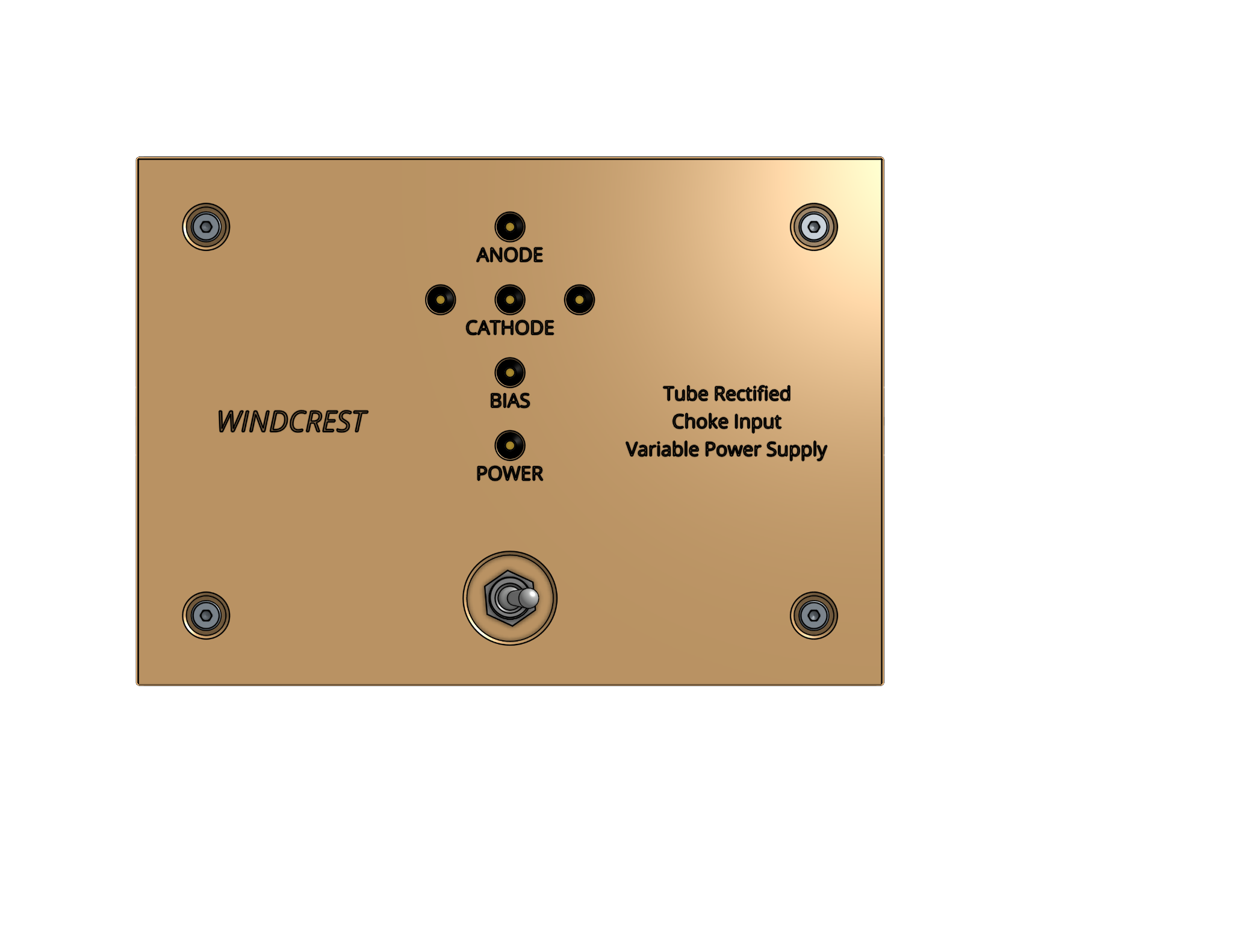

Now I know all the PSU parts on the schematic will indeed fit into the chassis. Since standard amplifiers these days seem to come in a 17 inch width, I made the PSU chassis exactly half at 8.5 inches, about 6 inches high and about 15 inches deep. This way two PSU's will fit exactly under an amp chassis. Most receivers seem to be 15 inches deep, so is this PSU chassis. The big-*** Hammond choke made me go up to 6 inches in height to fit it. Notice the rectifier tubes are enclosed. The two HV diodes are on the bottom HV capacitor board, heatsinked. The only other things that ned to heatsink are the LT1084 regulators and the gyrator choke MOSFET, those heatsink to the side slab, those slabs are 10mm thick aluminum. The Toroidy transformers are obvious, the soft start board, the DC blocker and house ground board is next to the variac on the back panel. Toggle switches on rear for items in the schematic. 3 fuses. The umbilical female socket. The compact variac, etc.
Green in the model indicates this is made from bent stainless or aluminum sheet.
Purple are PCB boards.
The blue side slabs are 10mm aluminum I'll machine on my CNC.
Back panel is plain aluminum.
Front panel is probably going to be Walnut, Zebrawood, etc. whatever nice wood,
Front panel has LED's indicating if all voltages are present and the on/off switch.
The variac control is only accessible if you remove the top panel.
Sample shown is chassis with top removed.
See PDF for all views top, bottom, front, back.
Top view of PSU in that PDF (other views in there):

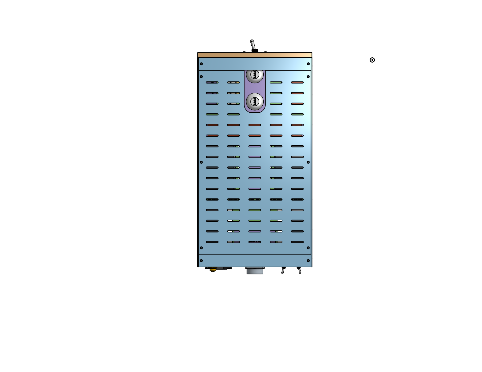

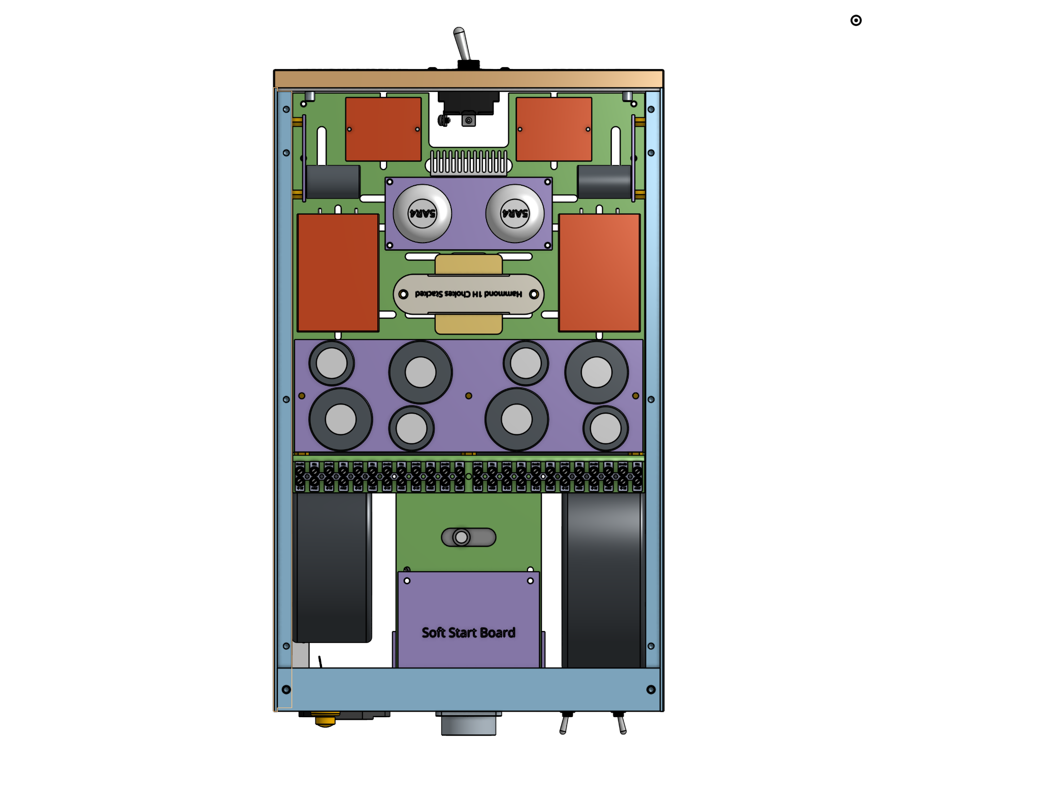

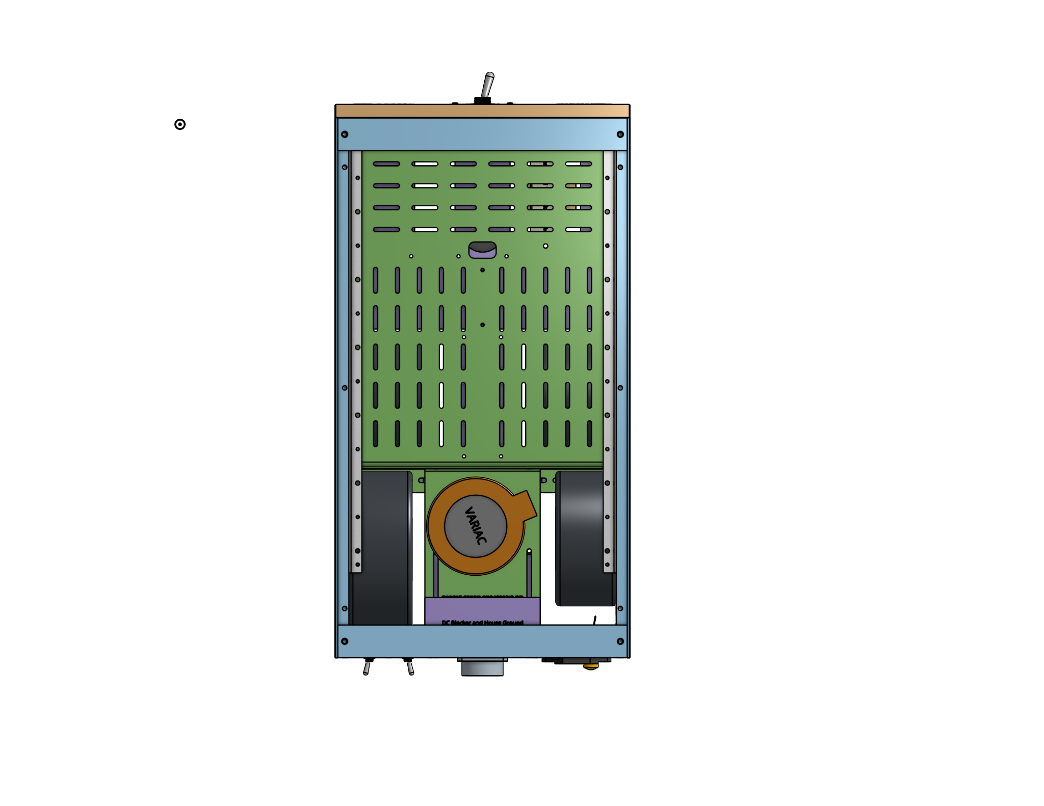

I think I'm settled on the monoblock PSU's electronics and mechanicals. Going with choke input exclusively. Schematic updated. Used PSUII, the ripple is immeasurable at 100mA load. Also ran model with a load change, ending the Pi filer with only 1H virtually eliminated ringing. I think I finalized the mechanicals for the PSU chassis too below: Green is bent sheet metal, blue is anodized aluminum, black are the Toroidy PT's and 16H, 12H chokes, allocated solder tabs space for mains side point to point wiring, red blocks are MKP's, variac, silver are angle brackets, purple are PCB's, brown front is some kind of wooden beauty face TBD, the wood strips down the sides hide the 4 M6 torroid mounting bolt heads in a slot, 5AR4's are given a cute little cutout so you can see them, a row of euro scew terminals separate the AC side from the DC side for serviceability demarcation. Lots of parts, but they do fit into the box which is 394mm deep (15.5 inch) 152mm high (6 inch) and 215mm wide (8.5 inche which is exactly half of a standard 17 inch wide amp which will be the stereo amp chassis width).

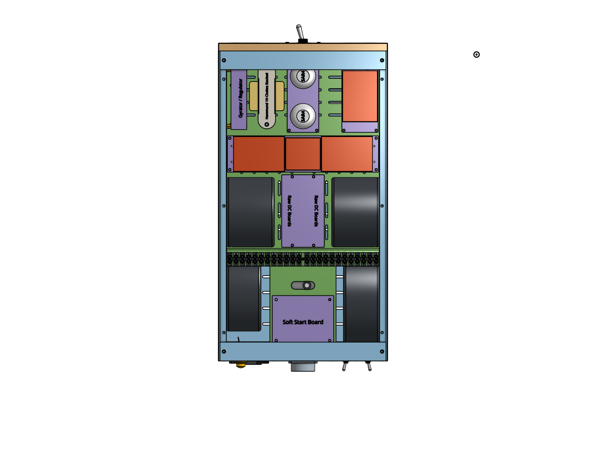

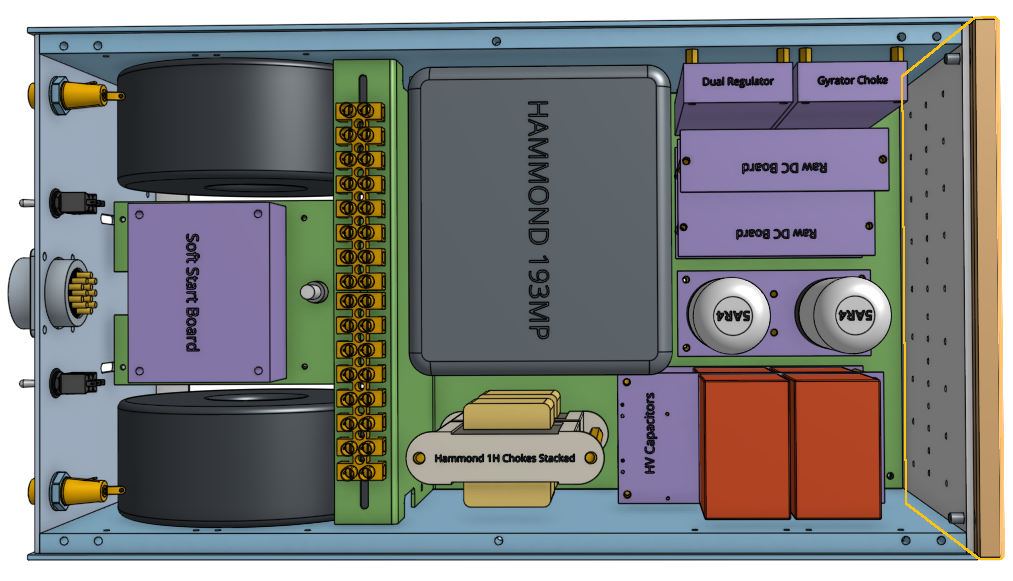

I wasn't liking the 16 inch depth of the chassis, managed to trim it down to 14 inches (which seems to be what a lot of receivers come). All the parts on the schematic fit with the addition of even more DC link caps. Schematic updated. Some PCB boards were consolidated. Now I know the exact size of every PCB to begin making. All mounting holes/slots are in place. Ready for an order to Send Cut Send for the sheet metal parts they will make, I will probably only wind up making the face plate on my CNC.
Wondering if you considered using Damper tubes instead of 5AR4s? You would get a more controlled power up time, and potentially have a greater current capability. Vinylsavour 19DE3
