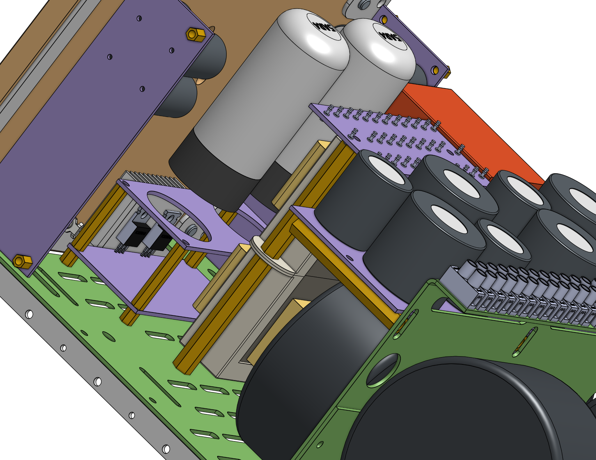

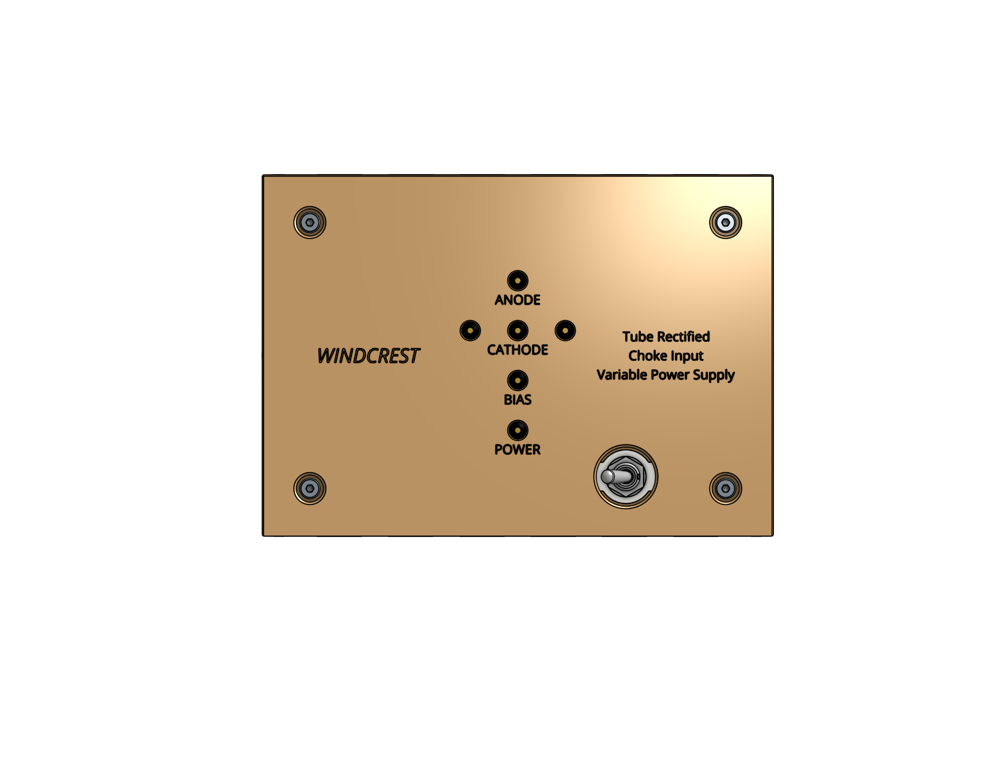

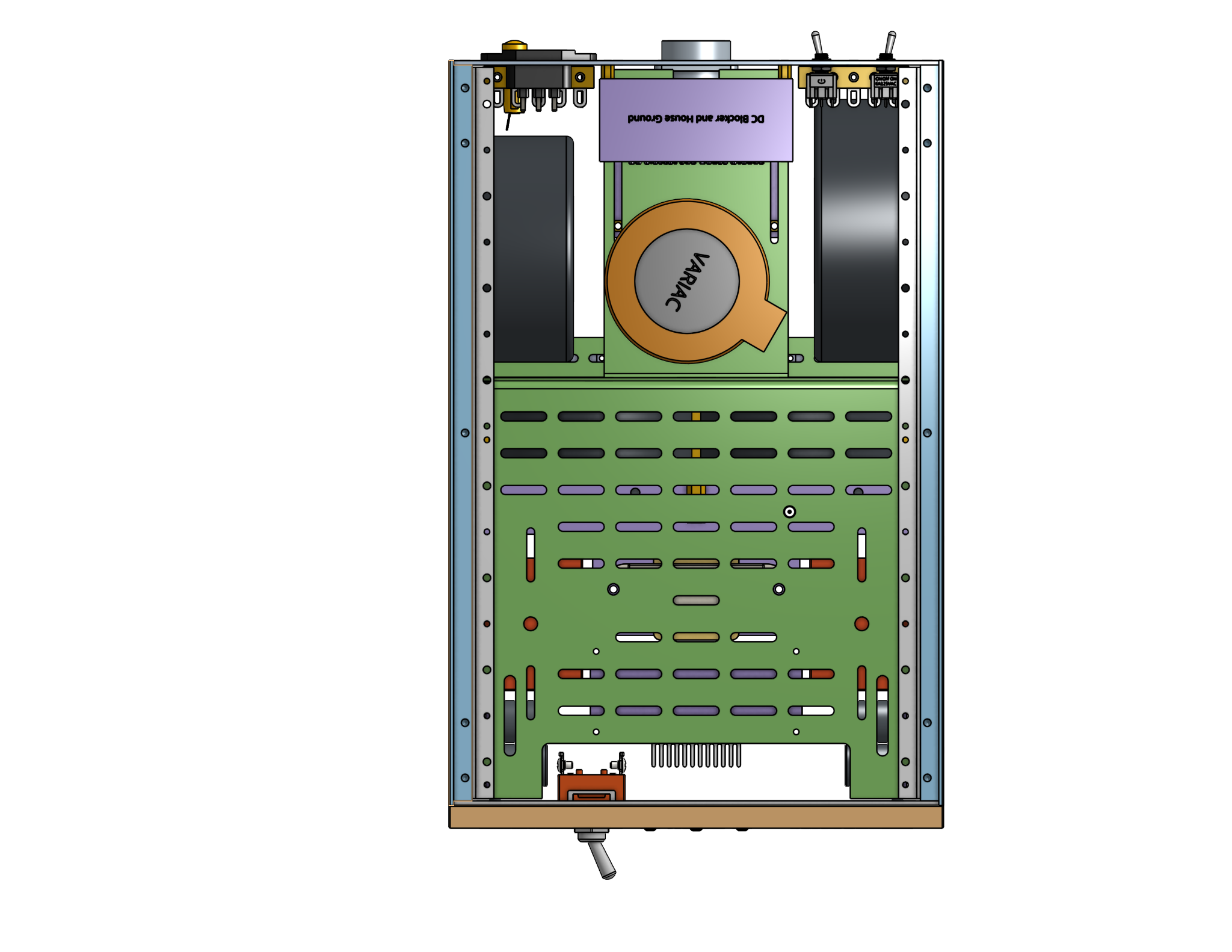

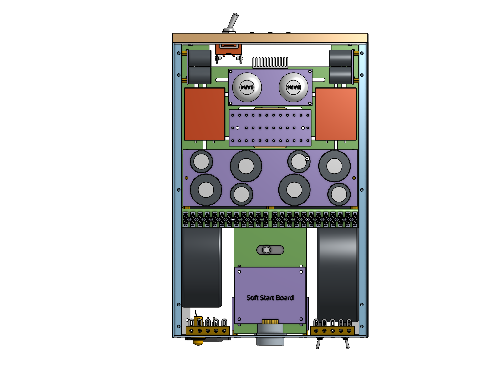

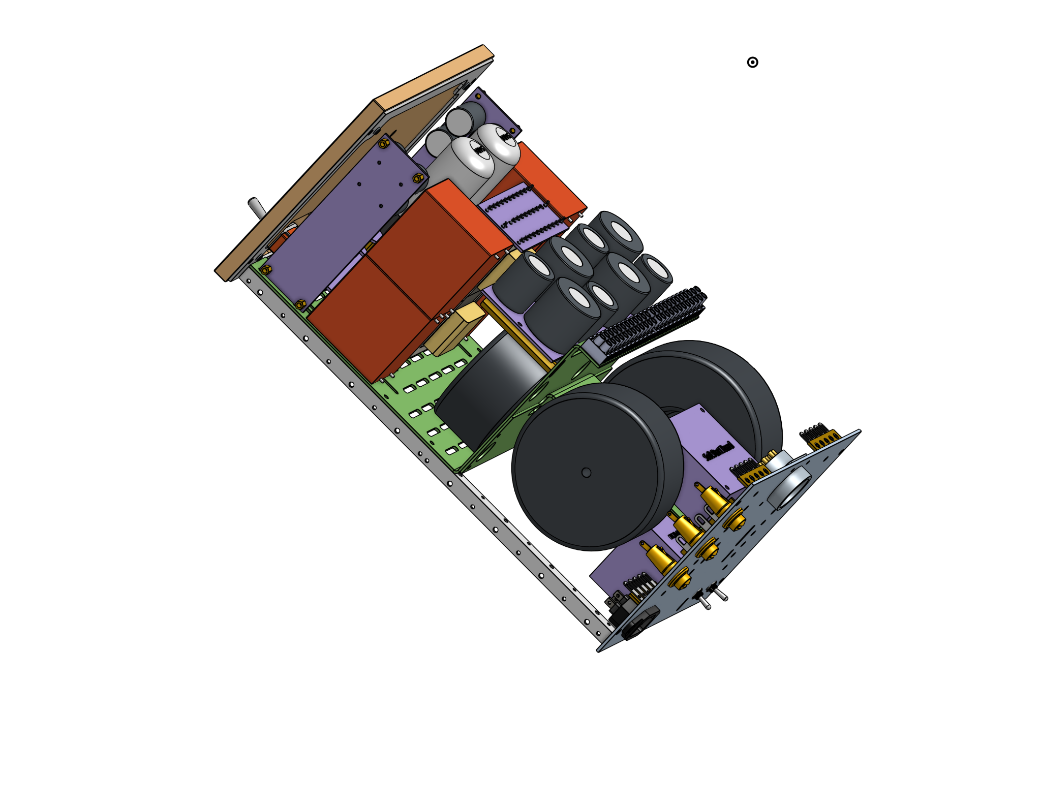

Iterations, iterations, I know. But now I think its done. I managed to decrease the depth by another inch, the box is now 13 deep x 8.5 wide x 6 high in inches, a manageable "power block" I can reuse with this amp and pre-amps, headphone amps, etc. Since it is variable. All point to point wiring occurs on the turret board in the middle, for easy servicing. The two boards near the front are the 6.3-0-6.3 dual regulated supply, and the gyrator choke parts for the bias supply, they are both heatsinked to the exterior via the thick slab sides. House ground and DC blocker board is on the back, the inrush soft starter is near the variac dial. The PSU side of the schematic is in-synch with these 3D models. I'm happy with it, I think it is assemble-able once I get all the chassis parts back. Below the tubes is another board that holds the diodes, the 5AR4 current limit resistors and the optional 0.1 uF input capacitor if needed. The 5AR4 sockets are actually 30mm above the sheet metal. Time to double check all the holes and start uploading metal parts for cutting and bending!
