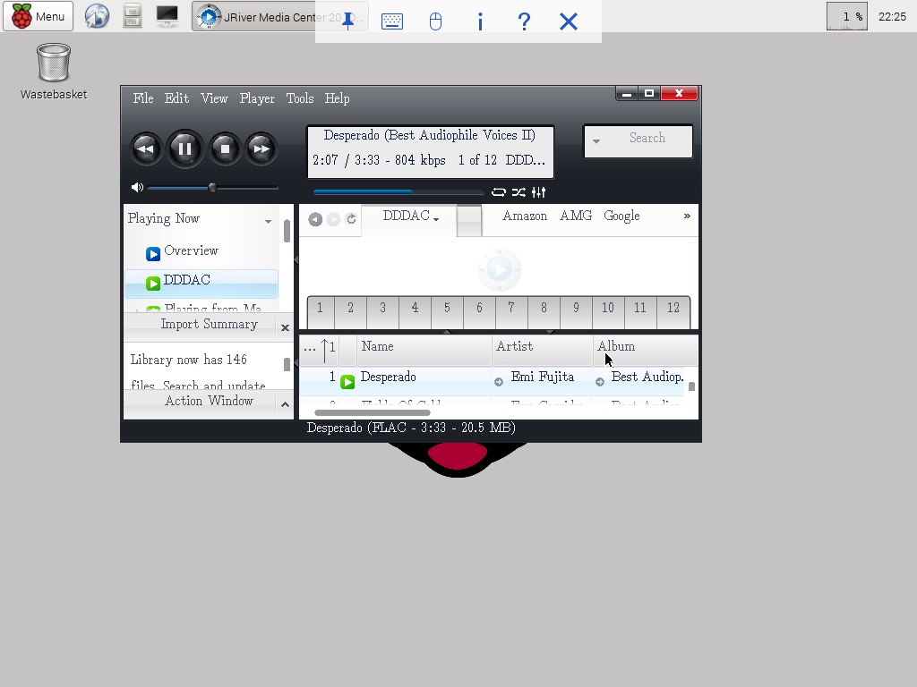

Btw, I have been playing with Banana Pi and Banana Pro is on its way to me. This little pc is amazing...! Now with Jriver is made available on armhf platform, I have removed my pc completely. If someone could tweak the Banana Pro to have i2s output...! This will be next game changer. 😛

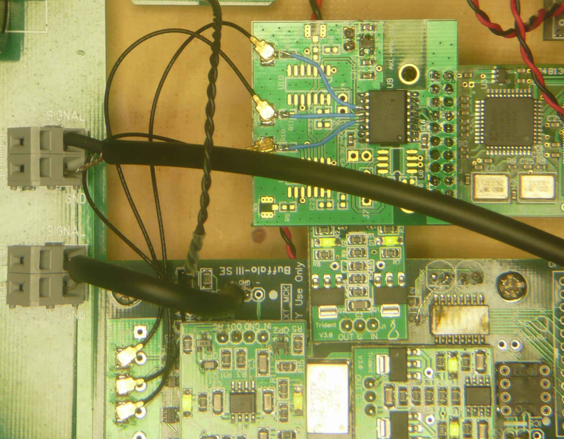

Thanks lintweaker. The DAC will be a Buffalo IIIse so fully DSD capable.
I've installed Asset UPnP V5 Beta 8 on my laptop and it does indeed detect and index my DSD sample music files. As a quick test I used my control point to select a DFF file and played it on JRiver acting as a UPnP renderer. JRiver is installed on the same laptop so not a complete test, however, JRiver showed that it was receiving DSD data (which it obviously transcoded to PCM for playback on my laptop) so evidence of basic functionality established, which means I have should have a viable way forward. Next step will be to try it with BBB/Botic, once I have DSD/PCM switching with one of Acko's new boards (in the meantime I may just remap my BBB P9 header).

Yes, this is in the works already - UFL connections from S03 to DAM1021 DAC 🙂
Banana Pi
Looks like an RPi clone and audio clocks are similarly PLL synthesized.
No provisions for slaving to an external clock. So only ASync re-clocking possible with S03.
Feedback from others indicate BBB (and other similar transports) with native re-clocking sounding better than RPi
Banana Pi/RPi will be good though for media serving or NAS applications - low cost and low power 🙂

Correct! I have been using the Banana Pi as JRiver streaming Ethernet to BBB. The BPi has made my optimised laptop obsolete. 🙂

Excellent! Can this JRiver stream native DSD like AssetUPnP? Re: post by Ray on his new setup

The Windows version of JRiver MC can certainly stream native DSD, as I reported in January -Can this JRiver stream native DSD like AssetUPnP?
http://www.diyaudio.com/forums/digital-source/267074-slice-media-player-6.html#post4196078
JRiver calls this "DSD bitstreaming".
Depending on setting, JRiver can also do DoP, or DSD-to-PCM conversion.
So it's really a question of whether this feature remains in the armhf version of JRiver.
There's also the question of how to render such streams ...
acko's Edel-NMR should do it out of the box, as should Oppo blu-ray players, but opensource media renderer applications which can play native DSD are rare.
The only one I'm aware of is MPD-DSD + upmpdcli plugin.
The well known GMediaRender won't currently handle DSD.
