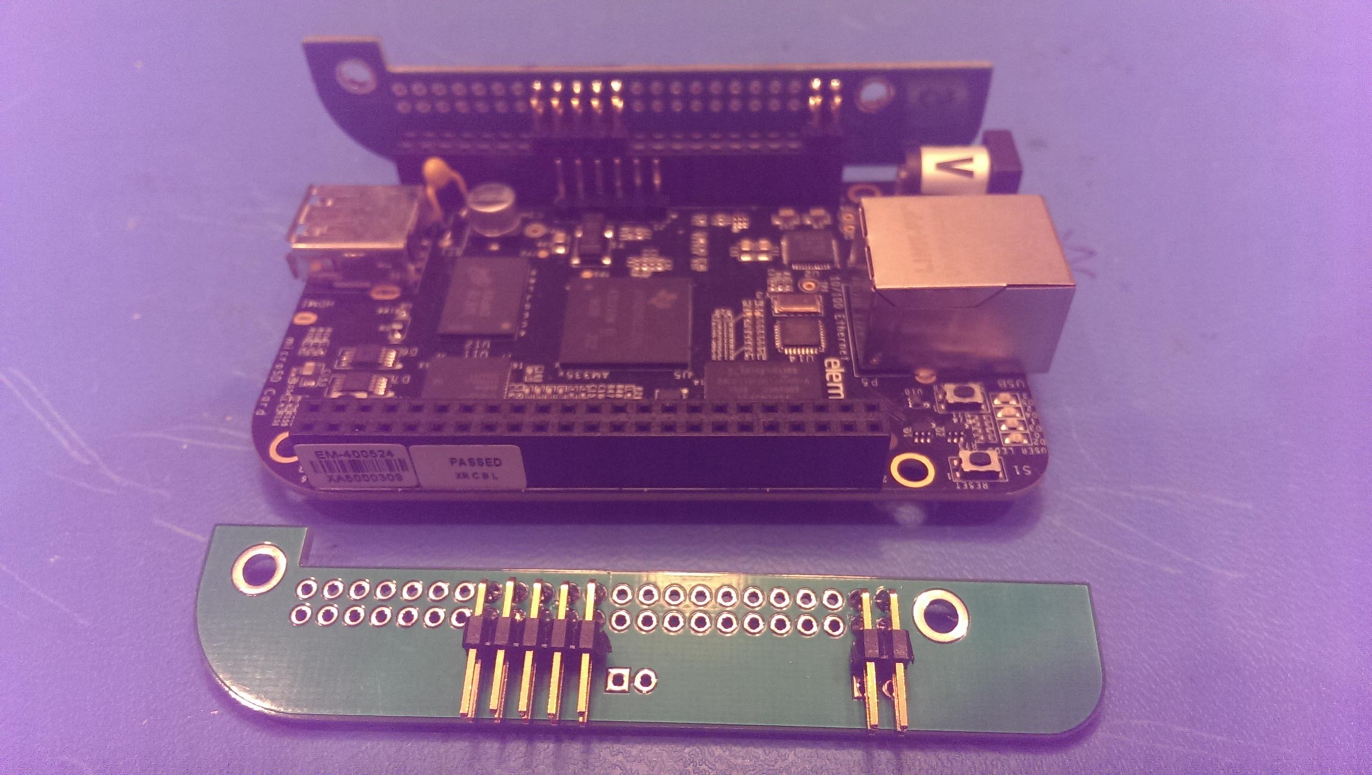

I have added an isolated I2C port to make it easier for your.
This is mapped to I2C channel#2 (I2C2_SCL and I2C_SDA) of the BBB.
You can now code away your control software for the AKM4490 DAC 🙂

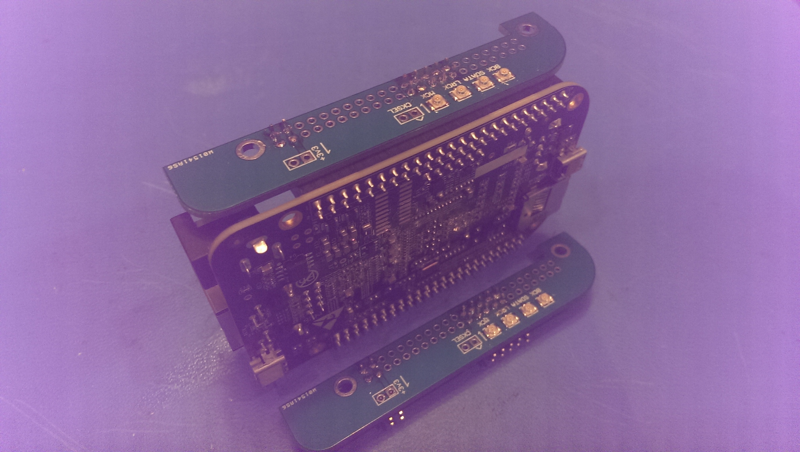

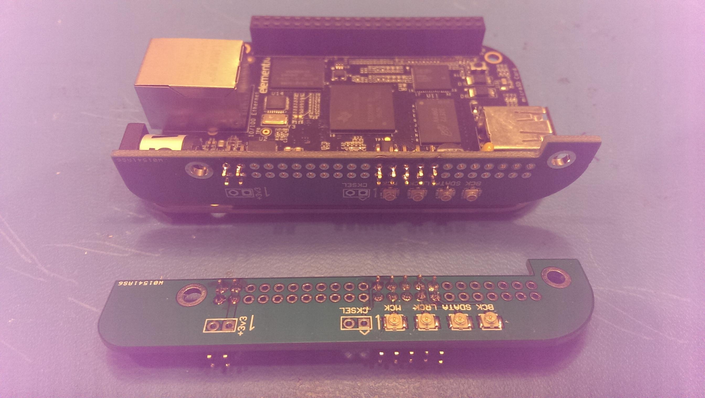

Acko, have you tried this with 90deg. header pins so that it stacks onto the BBB P9 header vertically; looks like just a little surgery needed in the bottom left corner. I ask because in a horizontal arrangement the outputs will be further away from my SO3 board and I want to keep all connections as short as possible.
Anyway, I'm as keen as mustard to get my hands on one....

Ray, it will fit with vertical mount - no need to trim anything. You can try this with the adapter board that you already have. It has similar cut on the mounting side. New board will go into fab early next week. Samples for tests, a couple of weeks later ... not long to go!

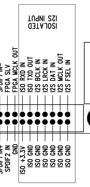

The Soekris DAC has 'masterclock' output and 'clock-select' input on it's I2S header so in theory it should be able to clock the BBB (with miero's Botic software) to retain native sampling rates.

f I have to say it myself, the clocking scheme is actually very high performance and flexible.... Have mostly been discussed before but the thread is getting long, so here's a recap:
The DAC have a low jitter digital controlled oscillator (SiLabs si570), data is sent though a FIFO (with programmable lenght) and the FPGA and uC work together to measure incoming bitrate and adjust clock as needed, basically a digital PLL with very fast lock and very slow filtering. So the DAC itself only need serial data, word clock and bit clock, no master clock is needed, it will sync to whatever you feed it.
But the DAC can also output a master clock and do have a pin for selecting between 45.1584 and 49.152 Mhz (can be divided).
Same master clock output is also used when connecting multiple DAC's, t.ex. for digital crossovers.
Thanks! All good to go then direct to BBB (if these lines are active already in the current version of Soren's DAC) full Sync operation 🙂
I see no issues with this interface except that MCK from DAM 1021 is 45/49 and BBB can take 26Mhz max only, but then again we have seen reports of successful operation at higher frequencies. Says, "can be divided" (on the DAC itself) but how?

Clock division is on the development list, not yet supported, eventhough the pins are already there I've not yet heard of anybody giving them a try.

Sorta like this?
Sorry, did this back in Dec & never around to posting it.
There's one way to find out if it works....
I think ChanH is feeding his BBB circa 45MHz clocks without subdivision and reported good results.

Sorta like this?
Greg in Mississippi
Thanks Greg. Yes, similar to that, though I would rotate it 180 so that the board is on the other side of the P9 header with the ufl connectors facing P8.
