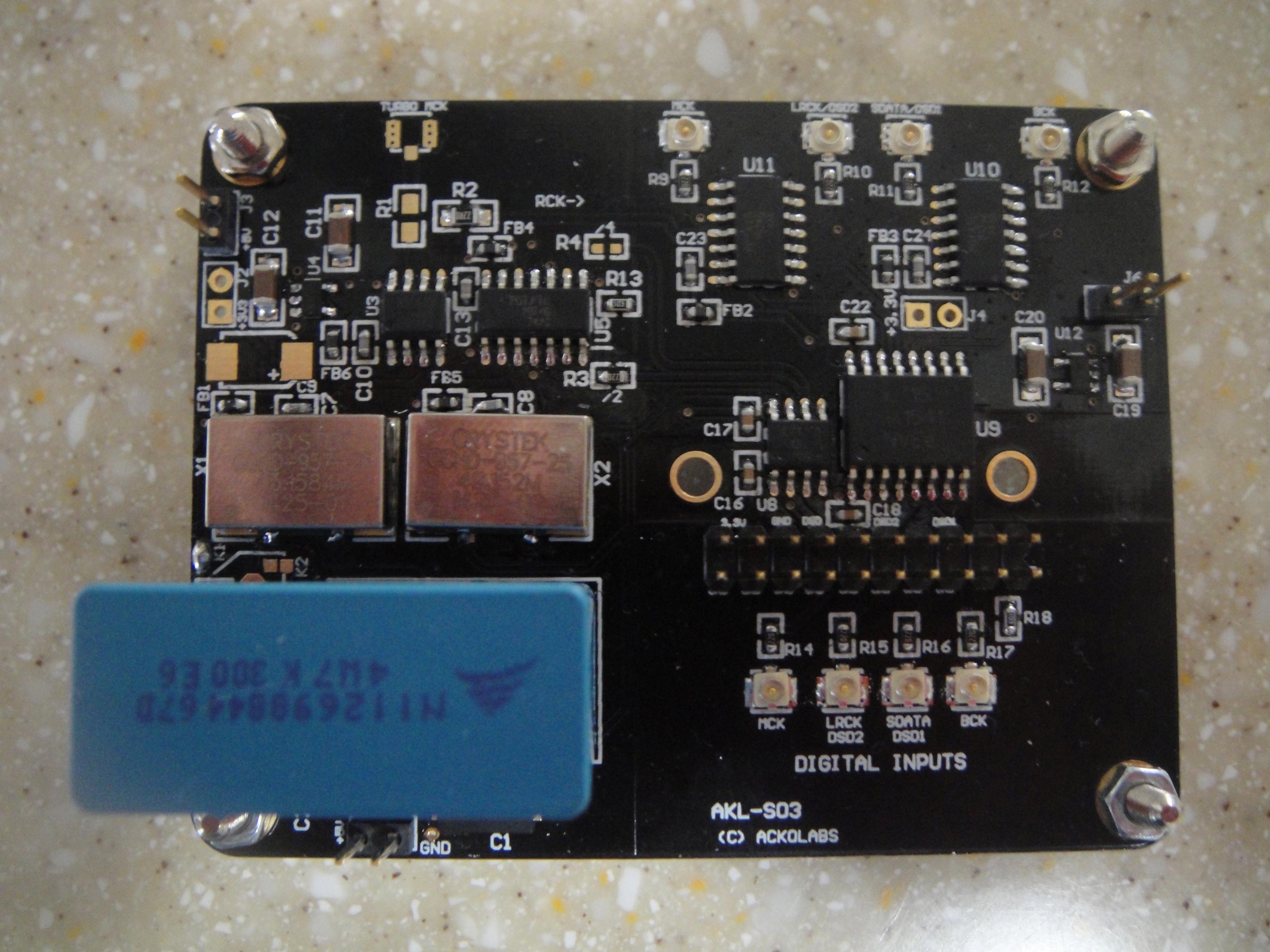

Hi James, It sound like the clock divider on the S03 is not doing it's thing. Do you have the /2 resistor (would have to look up the nr.) in place?
This is how I've got it setup at the moment:
X1: 45.1584Mhz, X2: 49.152Mhz

It's fair to say that it definitely isn't 😉Hi James, It sound like the clock divider on the S03 is not doing it's thing.
I'm not fitting a divider, but setting the frequency in the Botic uEnv.txt file so the division is done in the software.
I have this working with 44khz now and I'll add the second clock shortly.
The info I was missing is that the snd_soc_botic.clk_44k1 value in the file must be placed on the same line as the clock selection value.
I'll post up some info on what I've done when I have it sorted.

Well, not fitted in the first place, but yes, it appears it's not needed at all if you're using the Botic driver for bbb as you just set the frequency in there and let the software handle it all.OMG..., it's gone! 😀😀😀

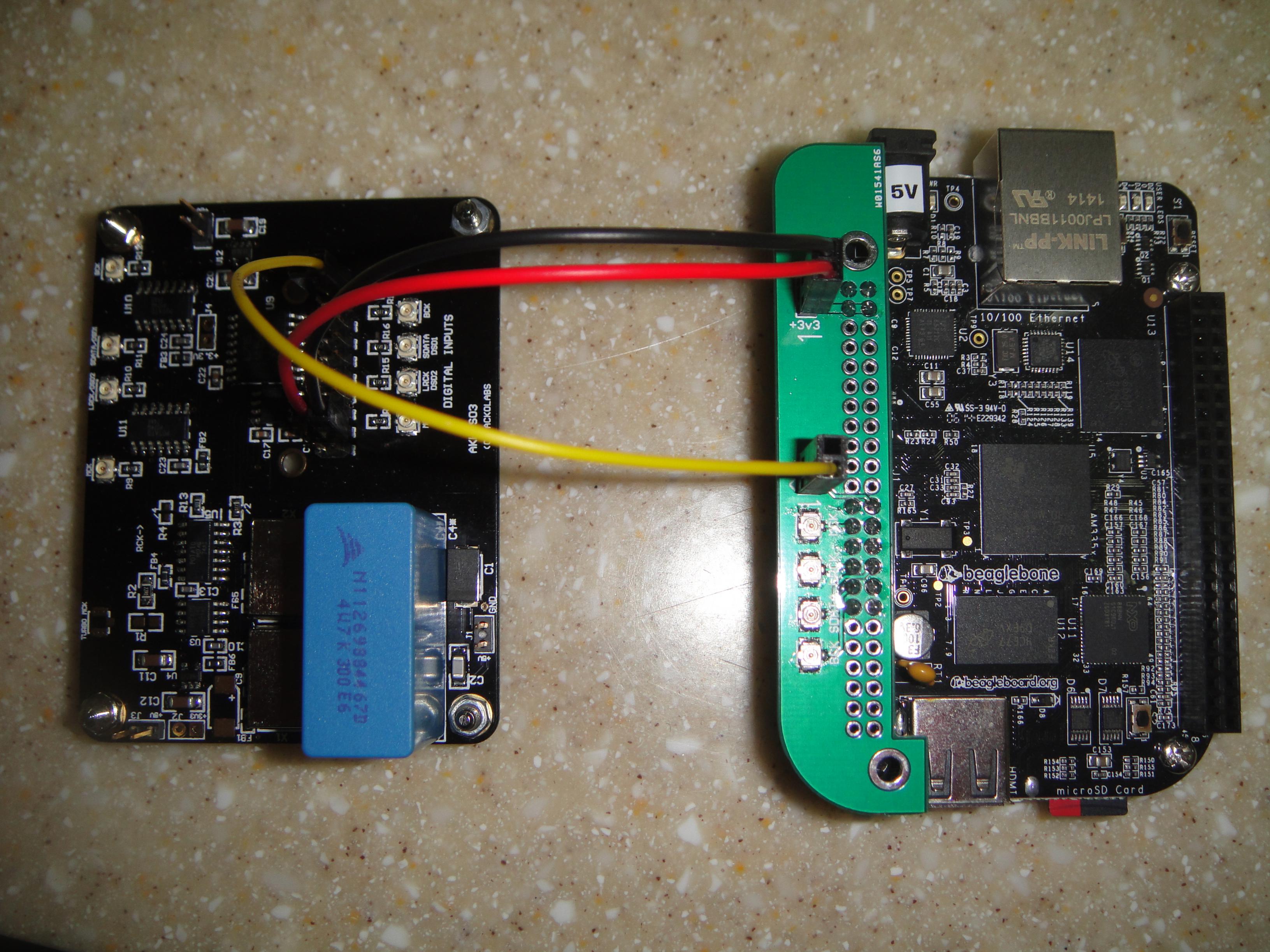

Hi James, I completed all the HW parts, I tested the S03 how much I can test without signals (various PS at the pins of the flip flop, XO and isolators)
I download and flashed the img miero file in the microsSD and I am actually ready to power up... I will wait your post before to understand how can go ahead and don't proceed blindly 😱

You can put the sd card back into your computer and look on the root of it for the file uEnv.txt
If you use windows or Mac you need a decent text editor, something like pspad (free)
Then just edit the line which says
Code:
optargs=coherent_pool=1M snd_soc_botic.ext_masterclk=0
Then save and you're ready to go I believe. It looks like your s03 is set up for 2x divider, so you don't need to change the frequency in the Botic driver.
