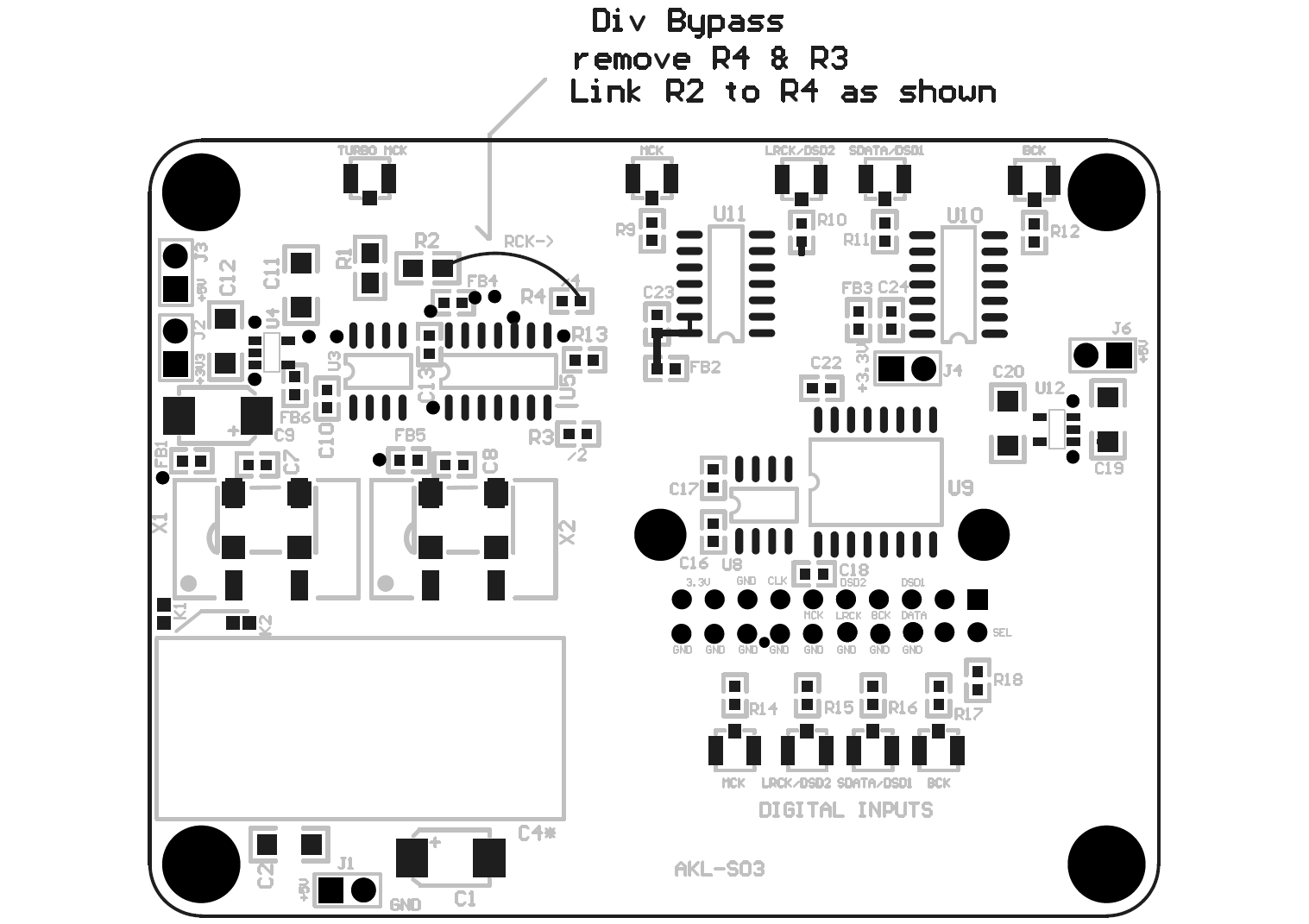

am I right in thinking that the MCK u.FL connection in the S03 digital inputs is sort of performing 2 functions?
So it is the input for MCK which travels through the 4 channel Isolator, gets reclocked by RCK and ends up as an output, but also it's connected to the EXT CLK > Amanero CLK which goes through the 2 channel isolator?
What I'm wondering is because the DDDAC doesn't use the MCK output from the S03, whether it's possible to split the 2 functions at this S03 MCK input so I can still output the EXT CLK signal to my BBB, but also I can input, isolate and reclock an additional data signal? (this way I could have dedicated right left mono signals which the Botic driver can apparently output)
I know it's not possible without cutting and bodging the board a little, but am I understanding it correctly or missing something there?
I won't have the board infront of me for a day or so to trace the tracks and confirm that MCK is connected to both isolators and is therefore input and output at the same time.
thanks,
James
James,
You can repurpose the MCKout channel - just cut the track to pin#3 of U9 and then attach wires directly to pin#3 and gnd connection from pin#2 of U9. This becomes an additional data channel for your mono version of DDDAC

a) I set the MCLK/1 but I see that the default amanero set is MCLK/2
b) I removed the R3 (R22) complete from the S03 board and jumper this position. Nothing! The same behavior, plays at half speed.
The 1KHz test is demonstrated as 500Hz test.
Any suggestion?
See if you can select MCLK/1 and do a "write flash". If not maybe this prescaler is now hardcoded! Will check with Amanero.
Jumper R3? will not help, the same effectI removed the R3 (R22) complete from the S03 board and jumper this position
If you are bypassing the divider for your build then remove R3 and then connect end of R2 to end of R4 pad as in pic

Select the mclk/1 and do a "write flash" = No success (the flashing was done succesfully).
Bypass the divider = Yes a success achieved and it works well untill 192KHz (also works well the clock frequencies). Frequencies bigger than 192KHz don't play well.
