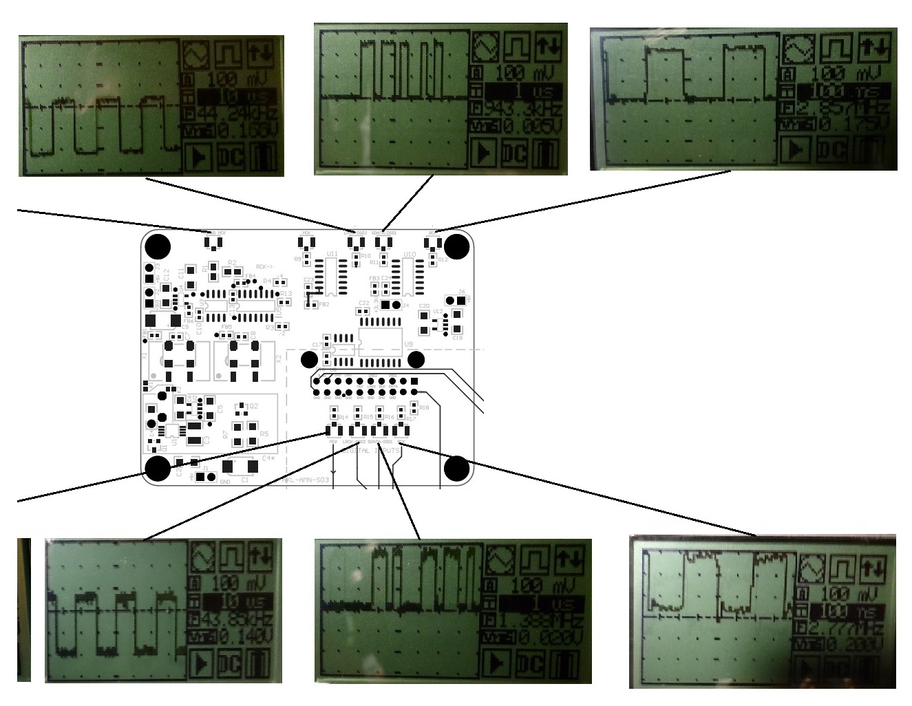

Initial results from an early adopter:
Equipment is a commercial DAC with USB-I2S built-in and driving 9018 chip in Sync mode internally. Good sounding setup with performance better than some of the cheap 9018-based DIY DACs out there. DAC has options for external I2S connection via RJ45 interface
1.BBB-I2S connection sounds better than USB
2.Adding S03 module with connection as shown produced even better results
AKLS03 can make the signal smooth as the attached picture so that the sound is improved.

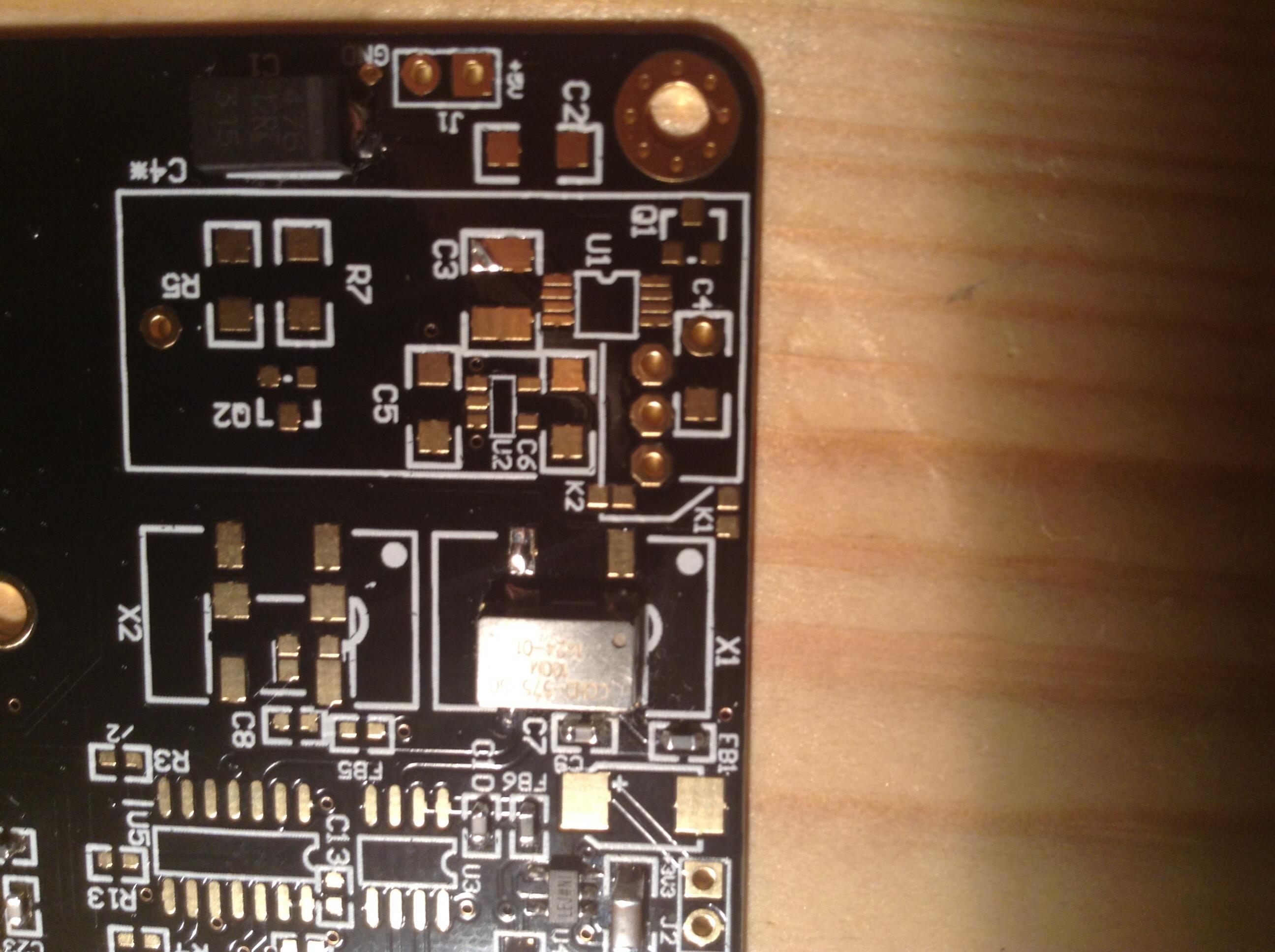

I have noticed that there is a 3pin through hole arrangement next to c4, this is new on the black board. Is this a spot for a shunt regulator for the supply of the clock? It's not clear in the documentation.
Yes, indicated as RG1 on the schematic but not marked on the board
