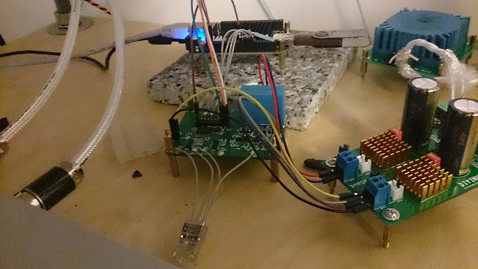

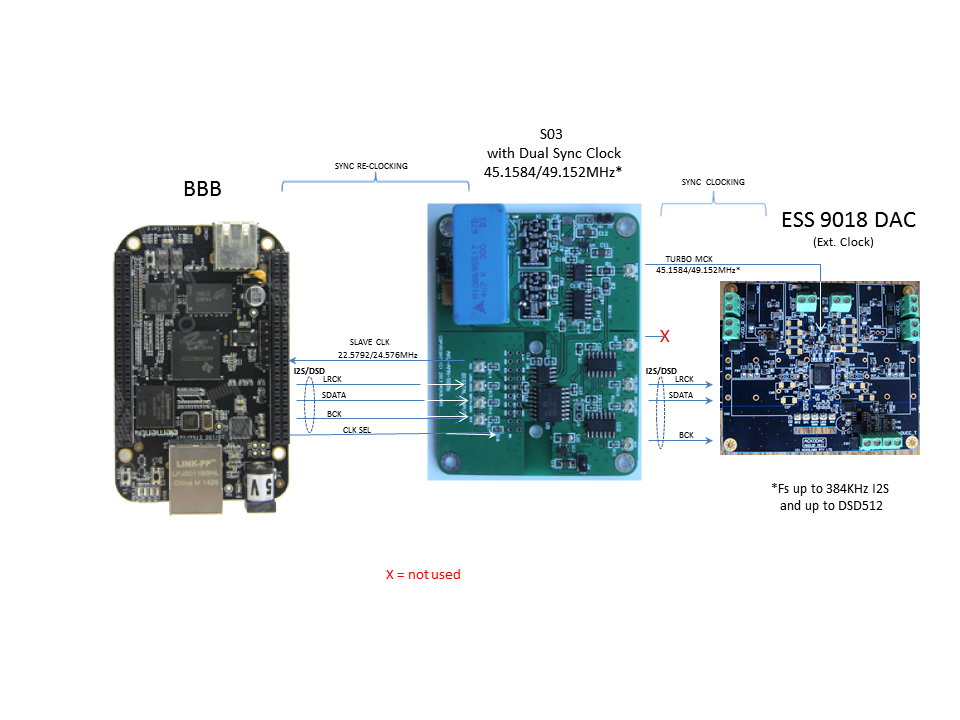

Initial results from an early adopter:
Equipment is a commercial DAC with USB-I2S built-in and driving 9018 chip in Sync mode internally. Good sounding setup with performance better than some of the cheap 9018-based DIY DACs out there. DAC has options for external I2S connection via RJ45 interface
1.BBB-I2S connection sounds better than USB
2.Adding S03 module with connection as shown produced even better results

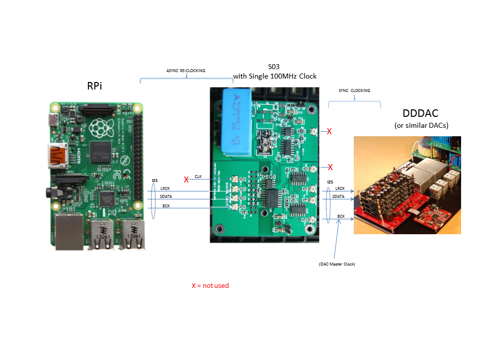

@Acko, If I was to install two clocks 45/49, would that still work with the RPi? I'm looking to experiment both with the BBB and the RPi, haven't made up my mind yet.

I am thinking of using these isolators:
http://www.ti.com/lit/ds/symlink/iso7640fm.pdf
Will these be suitable?
For powering the three different (exept for isolator chip input side, this will come from the raspy pi) I am thinking of using one 5v power supply taken from the dddac board. For the clock a local shunt regulator will be used on the S03 board.
Will this be sufficient, or is there a benefit in splitting these?
What will be the total power consumption?

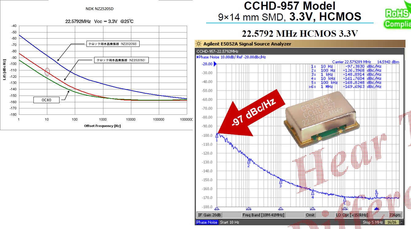

The jitter elimination is relative to the reference clock driving the output FFs.
The absolute jitter performance is dependent on the phase noise of the clock itself. The lower the phase noise the better the outcome.
Noise figures in the range 10Hz-20KHz matters most for audiophile grade applications.
The key figure to look out for is the "Close-in" phase noise ,i.e the value at 10Hz - the lower the better. See comparison graphs example.
