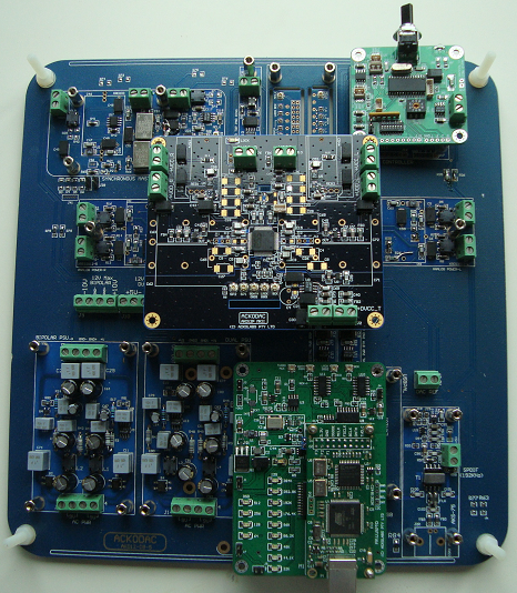

.... I see many voltages inputs, what does it really need ?
These are options for you to source them from separate power supplies if you wish to but in most cases a single 5V supply would suffice.
There is also an external 5V supply option for the Amanero so that the PC usb supply is not used.
You could use it with B3SE if you can disable the on board XO.
You only need not power the XO (it has it's own regulator).

Async mode for this case means the DAC master clock and transport clock are completely independent of each other.The default build of BIIIs is Async as it has the Crystek XO mounted and enabled. So the I2S signals and its clock from transport are running freely on their own. If you have a 2CH scope and monitor the clock/signals you can only trigger onto one of them - the other channel appears running around (async behaviour)
The default build of my own DACs is for Synchronous operation. XO is not mounted and this means you will need to source DAC master clock elsewhere and usually from the transport. This puts the DAC and Transport I2S signals in Sync mode as the source of clocks are the same. On a scope, triggering onto any one of the signals also locks onto the others as well (sync behaviour)
Of course, as what Brian explained you can get the BIIIs in Sync mode by disabling the the on-board XO (unpower it) and then pipe in the external clock from transports like from the S03 board.

Yes, the S02 board can be used as a simple isolator by just populating only the required parts.
As for the S03 boards you may use any clock as suited to your DAC. I guess apart from ESS DACs the rest will only handle less than 50Mhz clocks
Again the reasons why S01/S02/S03 are made available are bare boards.

In the SO3, R4 divides the clock by 4, R3 divides by 2, can I use 22.5792/24.576MHz clocks and not populate R4/R3 so the freq is fed undivided? This is to test S03's reclocking with the rpi or beaglebone black (when i2s out becomes available in the beaglebone). I have the two clocks leftover from another project.
Just skip mounting the U5 IC and wire-jumper leg3 to leg5 (or leg9) and also jumper R3 (or R4 of jumper to leg9). That should do it i think. 🙂
Yes, this is right. U5 does the division and R3/R4 are simply to link select required outputs.
If you are using 22/24MHz XO then the maximum Fs than can be re-clocked is 192KHz
U5 also buffers the clock output so you will need to consider the loading when connecting direct. Hopefully your XO has sufficient drive.

1. The SO3 board is a general purpose digital isolator and re-clocker designed to clean up jitter from preceeding stages. It is not a signal processing device, has no embedded processor and intrinsically bit-perfect. So it will take any LVCMOS signal and data format (I2S, DSD, etc - even non-audio) - first isolates and then re-clocks with reference to a clean clock to present to DAC for best performance. In its current form the SO3 is supplied as an empty board so that you can match it closely to your intended application. You can even use it as a simple isolator like the previous SO1/2 board. Reference material can be found in the App Notes posted before. The SO3 board can be used with popular choice of audio transports like WaveIO, Hiface, Amanero, etc. Amanero allows greater interaction so you get benefits like Full Sync re-clocker for DACs like ESS.
2. The AKU384 is a purpose built device with the SO3 cct integrated around the Amanero for those who just want a finished product with tightly integrated features. It will be supplied with a specially programmed and configured Amanero plus warranty. No options to leave Amanero module out even though you have one already.
