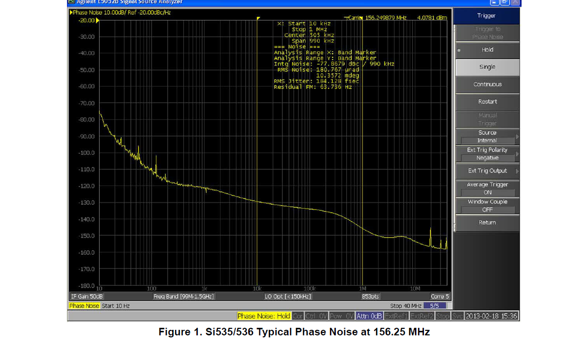

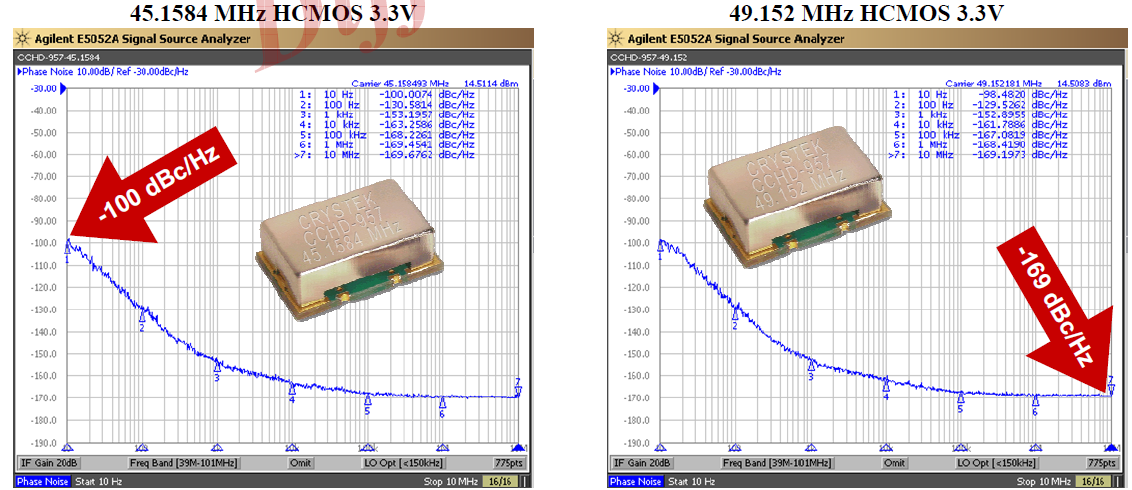

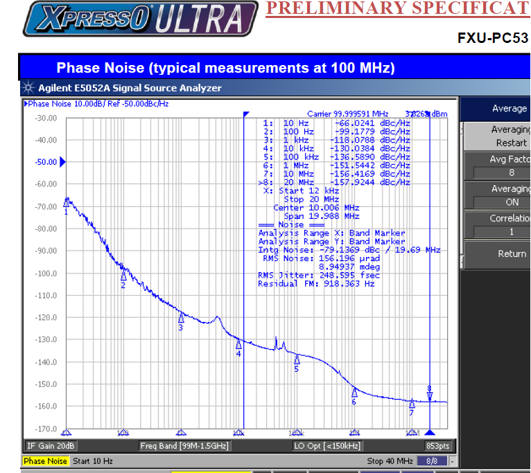

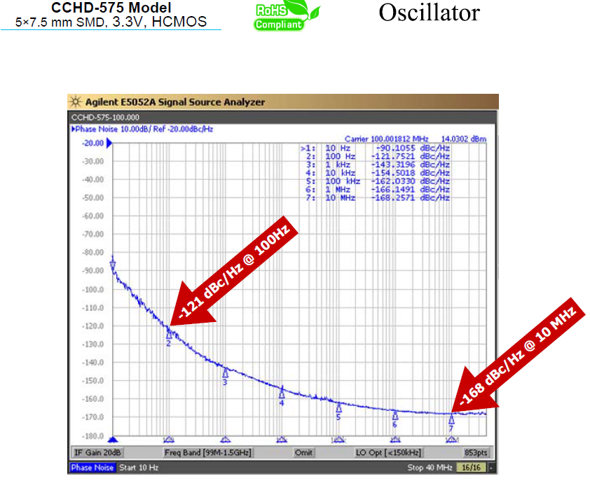

After going through a number devices, I have gathered some information that will helpful in selection of oscillators. Every other manufacture now claims 'ultra-low jitter' specs so closer look at the characteristics is needed. The attached pics show the main contenders:
Crystek's CCHD 957 has the lowest phase noise, both close-in and floor
Top-end Fox and Silabs 5xx series are tad poorer in comparison even if they are of the high speed PECL types. Silabs types have 'spurs' (the effect of frequency synthesis) that could be bothersome
So CCH957 is the favourable choice.
As for 9018 DACs, these were originally promoted for Async operation where MCLK comes from a standalone XO, the frequencies must be greater than some multiple of Fs to operate correctly and for better jitter reduction:
>192 Fs for I2S
>386 Fs for Spdif
So to cover up to 384KHz I2S and 192KHz Spdif Async mode we are looking at MCLK >75MHz, so the choice of 100MHz types such as CCHD950/575 that have excellent jitter performance at this frequency.
Now we have seen that 9018 DACs can be operated in Sync mode with even better performance. In sync mode the MCLK frequencies can be much lower to operate correctly and as I have said before the 49.152MHz/45.1584MHz are more than adequate. (In fact without re-clocking the MCLK can be as low as 24.576MHz/22.5792MHz in sync mode to cover up to 384KHz)
So yes, 9018 in combination with CCHD957 (49/45M) will give excellent performance used in I2S Sync mode. Now whether it would work better at 98/90M is still yet to be determined. There is some mention that jitter reduction in ESS DACs will work better at higher frequencies but then again this could be negated by poor jitter performance XOs. I haven't seen any 100M XOs that could match CCHD957. The closest is Crystek's CCHD575 but these do not even come in sync frequency types. So we are left with Fox and Silabs ones and you may need to load these and see for yourselves. The S03 boards are meant exactly for these experiments. If anyone has done comparison tests please post your impressions. I will be doing my own tests in future (when I get some free time 🙂)
