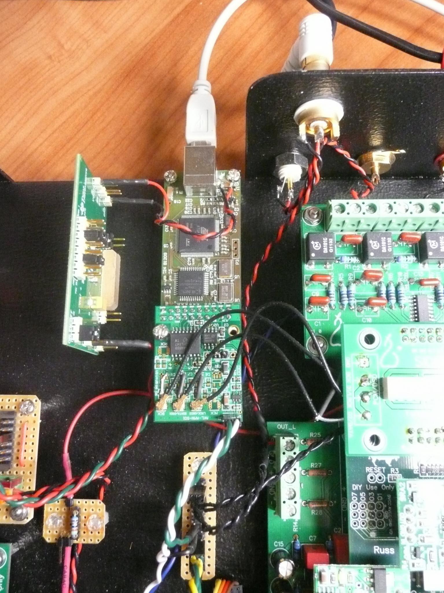

I'm trying to work out some CKSEL issues with my full sync install (posted a question in the Amanero thread), but I was wondering - how can I best force X1 out and X2 in (simulate pin 11 high)? I'm thinking ground pin 2 and power pin 3 of J10? would 5V on pin 3 be too much?
Amanero CKSEL Issues
Yes, you can manually select the clocks on the AKX302 module. Obviously I was thinking this would done automatically by Amanero but from the looks of it there may be a firmware issue with the Amanero unit. Until this is sorted try manually:
1. Disconnect any J10 (CKSEL) connection of AKX302 to the reclocker boards (S01/S02).
2. Tie pin#2 and pin#3 together and use the combined lines to connect/disconnect to XO 3.3V supply to select clocks accordingly.
e.g. Pin2/3 open -> X1 selected. Pin2/3 to 3.3V ->X2 selected.
I would not advise connection of the above to 5V supply as the XOs are running on 3.3V
Let us know if this works 🙂

No, not yet. Had to shelve it for a bit. My sense is that we need the upcoming firmware with CKSEL working as it should. Using slave2224 & 1074, pin 1 & 11 are not being remapped to provide the Hi/LO necessary to select the proper clock. Short of that it's working for me.
