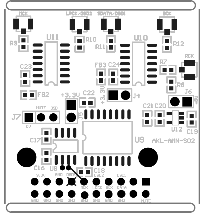

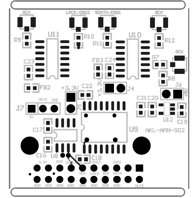

The 'mistake' in the re-clocker design came about from the information above where I thought pin#7 (DSDOE) has become MCLK input. It has become clear that this is not the case and it is actually pin#6 (MCLK out) turns into MCLK input with the firmware update and 22/24 slave setup. Many thanks to Jackal29a for bringing this to our attention.
But all is not lost as the mod seem minor to rectify this. I will post pics soon to illustrate my earlier fix to this issue
Thanks Acko - that'll be a huge help. To clarify the jump from pin #3 of the 712 should go to pin #6 (MCLK) not pin #7, correct?
For Full Sync mode with Amanero firmware update and cpld 22/24 Slave select:
Cut the track (bottom side) of the ALK-AMN board from U8(U2) pin#3 to pin#7 Amanero (DSDOE) and then re-connect pin#3 of U8(or U2) with IL712 to pin#6 (MCK) of Amanero. This affects the S01, S02 and the new S03 boards used this way.
As shown:
As shown:
Alternatively, (if you do not wish to cut tracks) simply link pin-pad#7 to #6 on the re-clocker board but do not connect pin#7 of Amanero

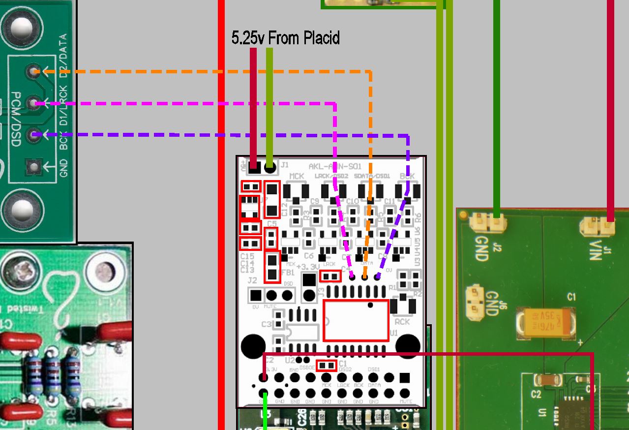

At this stage I've decided to keep it simple & just use AKL-AMN-S01 as an isolator between the Amanero & the BIII (Sidecar) I propose to power the BIII side of the S01 from the 5.25V Placid HD supply & the Amanero side from a separate 3.3V supply, & bring the 3.3v supply in at the Amanero 3.3v output.
I will install links from the isolator chip to the output pads for LRCK, SDATA & BCK, as shown in the drawing.
I have marked the components I propose to load onto the board to make this happen. Can anyone please confirm;
- That I have shown all the components that I will need to stall to make it work properly.?
- That it is ok to feed the 3.3v into the Amanero via it's 3.3v output?
- Do I need to remove any components from the Amanero so the power supply from the computer (when plugged in) doesn't get to the board.
I am afraid this will fault your setup! Correct way is to let the Amanero 3.3v output power the input side of the isolator. If you wish to use an external 3.3V supply for this then make sure it is not connected to the Amanero 3.3V pwr output.
Also GND of BIII inputs needs to be connected to gnd on the output side of the S01

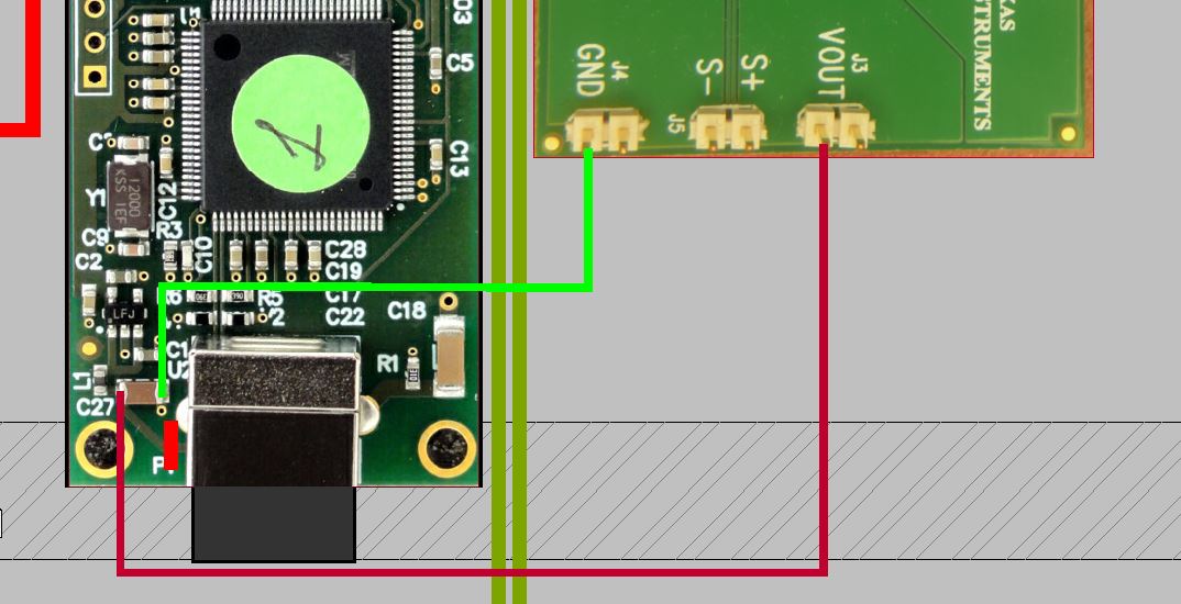

Thanks, I am thinking I will bring 5V into the Amanero just after the USB & before the regulator, then cut the trace to the USB power.
I forgot to draw the ground 🙂 thanks again
you don't have to cut the trace to the USB power, just remove the L1.
My thought was to leave the CLC circuit in place before the regulator to assist in power smoothing.you don't have to cut the trace to the USB power, just remove the L1.
Looking at the schematic, if L1 is removed you would have an open to the 5v in to the regulator.
http://amanero.com/USB_B.pdf
The method he proposed in the Amanero GB thread (5v at C27) would allow the Amanero 3.3v header to power the isolator board and allow an unmodified USB cable (without USB power wire cut) to be connected to the Amanero.
