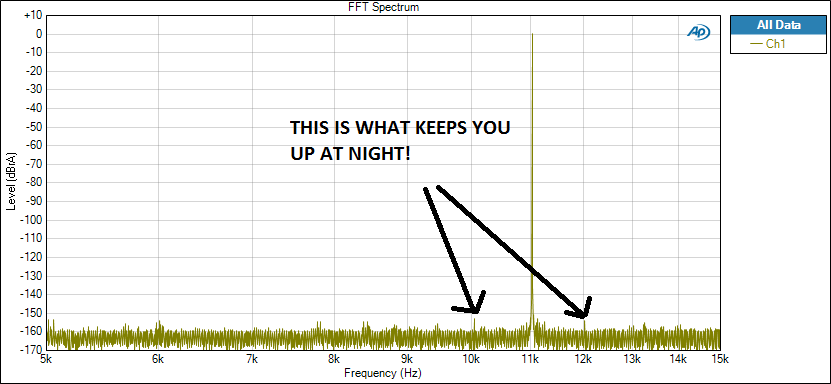

I'm going to toss two things out there:
1. Hopefully everyone realizes that the jitter artifacts we're talking about reducing are already manifested at roughly -150dB in the analog domain. This is with a standard 9018 DAC - nothing fancy. In this regard, I agree with Russ in saying "if it ain't broke, don't' fix it.". There are probably bigger gremlins in your playback chain.
2. The things Russ says seem to carry an incredible amount of weight given that they are seldom (if ever) backed up by measurements or any other form of proof. The following quote should have alarm bells going off in your head:
"After a while I noticed that the sound was actually worse… less precise, kinda murky. It sounded like jitter… ouch."
It's like something straight from the pages of your favorite audiophile rag.
I can't believe advanced digital design is still being evaluated like this... it makes me shake my head in shame for audiophiles everywhere.
I'll report back when I've got some actual data to backup my guesses...
Owen

Owen, my 2 channel fully tricked out fifo may be laying idle for a while at some point in the near future, would you be interested to test this also? Ian has got some very nice digital logic and jitter analyzer that proved the jitter is ridiculously low, but his analogue gear and FFT ability is not up to snuff for the gear we are playing with. It would be great to have a datapoint from you also, that included the harmonic and temporal content of the signal. So testing the output of the ESS with and without. thats if Ian agrees to that too, but I would think he would be interested also.
it would require you set up proper termination and of course sync connections on the dac for best results.
as far as the noise floor, sure i'm aware of how low the noise floor is, but its my feeling that this is more a temporal AND frequency based difference that may not show up so well with averaging, if you know what I mean (if that even makes sense).
None of this keeps me awake at night, no more than squeezing the last few dB out of your amps that are already orders of magnitude better than the dacs and speakers/headphones they connect to, does for yourself. Flirting with the unattainable perfection can be fun and interesting.
however I really have found that Synchronous clocking with ESS with fifo (even without the galvanic isolator) is preferable, I dont know why, but I dont feel bad because it is also technically superior. I would be interested to see that 'gut' feeling tested.

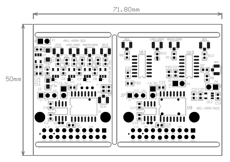

All in fab now, layout being inspected. If no issues then ~7-10 days to complete.
Panelizing of board is now complete and confirmed for fabrication process. Final boards as in pic. There are now 2 boards S01 and S02 (Pot chip version). However fab guys have now advised shipment from factory in China will be delayed until 22nd Feb due the Lunar New Year holidays. So 2-3 days after that I can start shipping to you all. Hope you could hang in there for a while and sorry for any inconvenience. Let me know if anyone has concerns. In the meantime I will continue with the support.

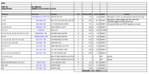

A parts list in the meantime would be very helpful, thank you.
