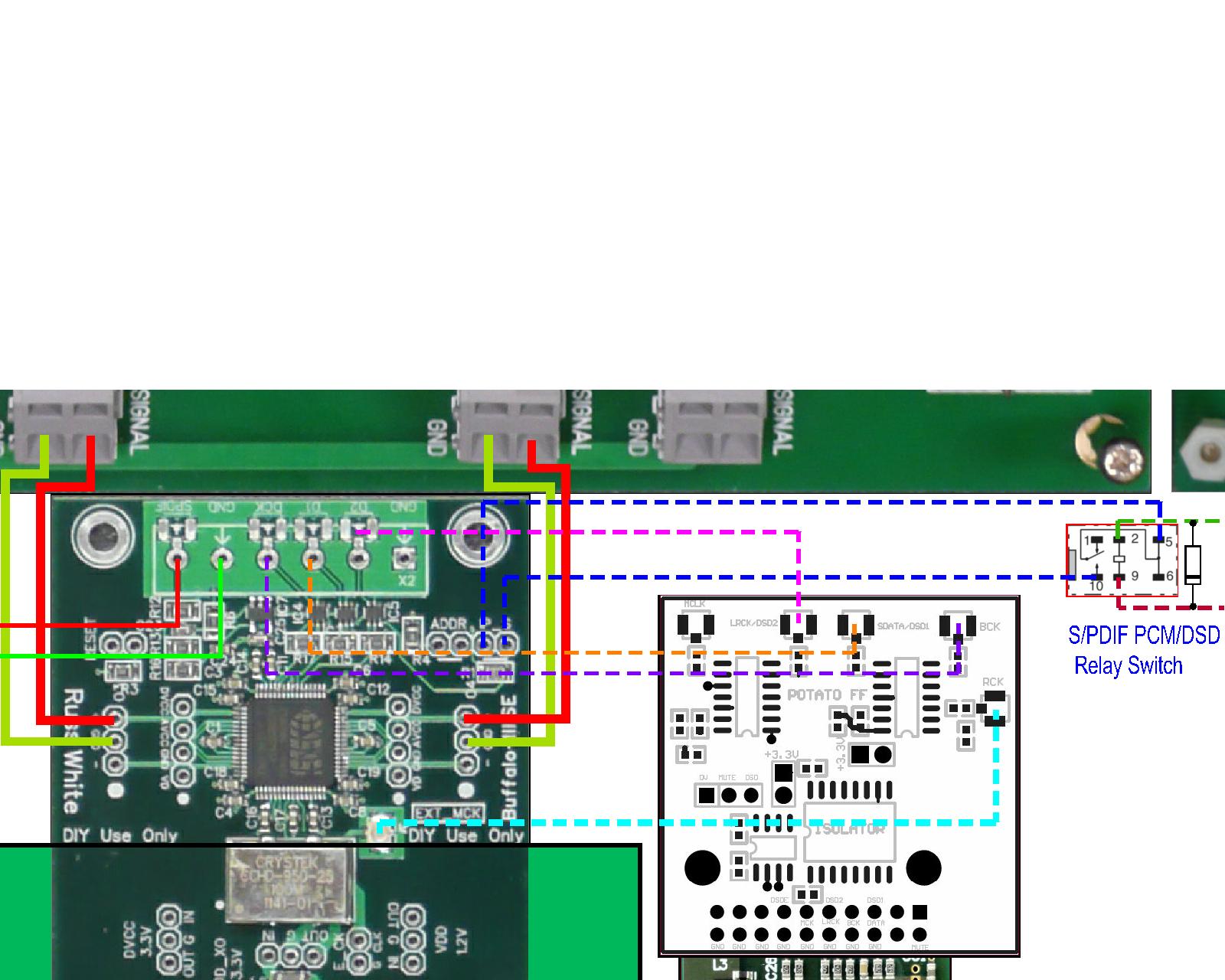

Given I'm electronics challenged, I'd very much appreciate you confirming the connections to the BIIISE if possible. This is what I was thinking, see below
Also I assume it needs a separate 3.3v supply (although it seems to have 2 * 3.3v inputs :confused:) does anyone know the best way to do this can it be taken from the BIIISE?

If you are planning to use a BIII/BIIISE DAC with the AKL re-clocker, please note that there appears to be some sort of re-clocker already on board the BIII. Not sure what those chips are (or if they can be disabled/bypassed) but any benefit of the PotatoChips on the AKL unit is negated by the ones on the BIII. You may be better of taking the outputs from the isolator only and connect these to the BIII inputs.
Also, if you not using the on-board LDO of the AKL (not shown in the preview) then both the 3.3V inputs need to be connected to a suitable 3.3V external supply-just the way the PotChip package is.

Other than that the connections are correct. 'MCLK' from AKL doing another 're-clocking' on the BIII needs further investigtion.
No similar issues with BIIs or DACs without re-clockers built-in.
3.3V supplies can be taken from DAC DVCC but if you do not wish to disturb the DAC supplies then get a separate 3.3V source for the AKL board.

So I stand corrected. There is no Re-Clocker function on-board the BIIISE (or any of the BUFFs) and so you can use it with the external Re-Clocker (AKL) for full benefits
... confirming the connections to the BIIISE if possible.

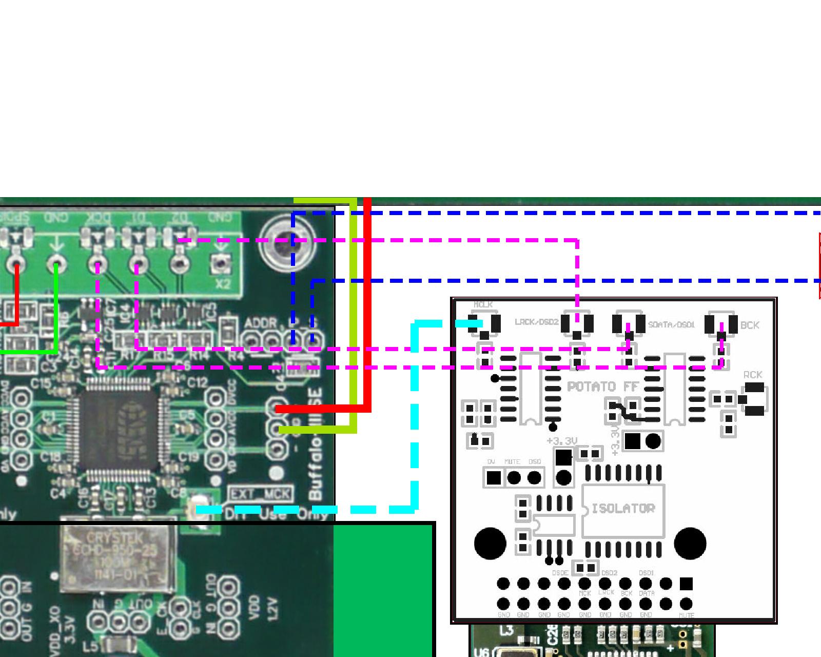

All connections are correct as you have shown. MCLK of the AKL board can drive the EXT_MCK if the BIIISE XO is disabled (unpowered- as TPA advice).
This assumes the AKL itself if clocked by an external source at RCK inputs (>50MHz). You will get true synchronous operation this way but MCLK output from AKL is 24.576Mhz max as produced by the transport (Amanero) and high fs audio capability may be limited
Alternatively EXT_MCK (100MHz with BIIISE XO powered) from the BIIISE (nice U.FL connector) can drive the RCK inputs of the AKL board. You can go up to 384KHz this way. As the DAC and the Re-clocker are tied to the same clock, some form of synchronous operation could happen but we need to test and see later.

Like this ?
PS: Thanks for your tireless work on this issue.
