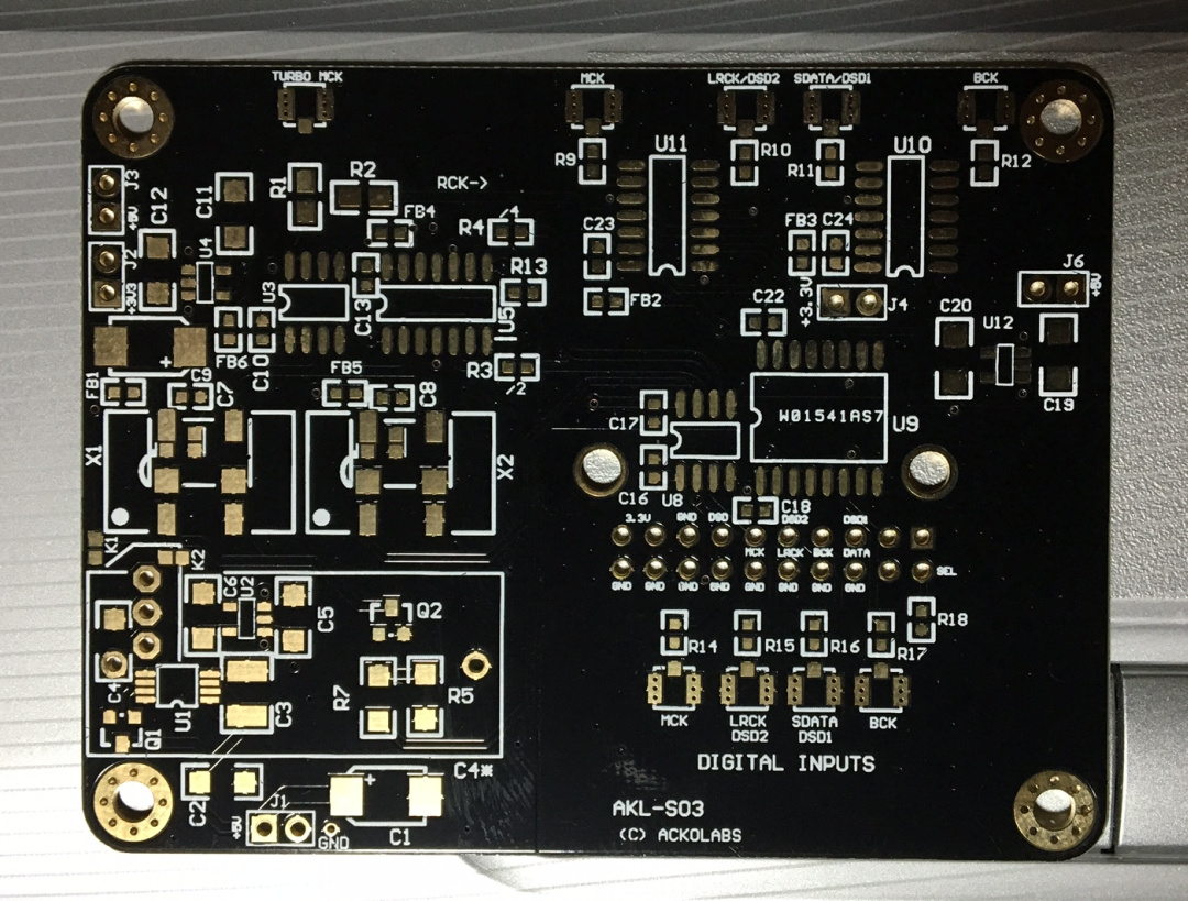

S04 Reclocker
New S04 board. Can Sync-Multiplex up to 2 compatible digital sources plus fanouts.
Will be rolled out as premium audiophile grade products!
Interesting Acko!
How will be the transit btw the two digital sources?
What type of digital sources are compatible with that, only i2s or i2s and spdif?
Finally, what is "fanouts"
The Source (SRC) J9 jumper/switch allows you to select the I2S sources
So you can conveniently hook up, say, Amanero USB and a Network Media Renderer like EDEL or BBB, select between them and gets Sync-Reclocked by the S04 accordingly. In this way no external MUX arrangement needed.
There are only I2S/DSD inputs. For Spdif there will be a special module that converts to I2S and will be Sync-Reclocked by the S04. ETA early 2016. I know Robert is also interested ...
The re-clocker board only works with i2s signal, and needs a source with cksel output to tell which clocks the samplerate is. So you would need a spdif reciever with i2s converter to make it work. I have requested this to acko before, but i think he have prioritised other things instead.
/Robert
"Fanouts" of the output signals - convenient for connecting to dual mono DACs

Hi Acko
You're planning to sell, the new S04 PCBs?
S04 will be available as assembled unit only.
I'm sorry, but what is "premium audiophile grade product"? Aren't those blank pcbs made by cheap Chinese budged fabs?
I was wondering how much is the minimum distance of any clock from a dac-chip. Is there any safety distance between them?
No min or safety distance as such but I would keep this under 5cm max
I don't think Acko said these were premium grade PCBs, though I do know some of his products do utilise premium quality PCBs.
What he said was that they would be used to rollout premium audiophile grade products, defined by the components that will populate the boards, such as low noise power supplies, high accuracy clocks etc.
