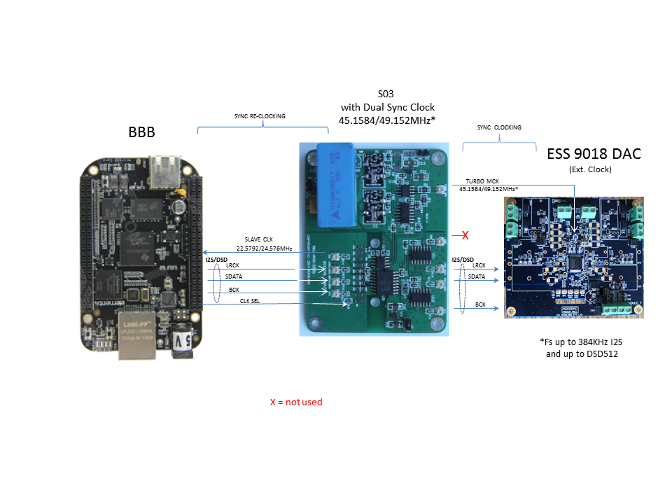

Reclocker to DAC can work in different ways. It can supply the master clock to DAC or you can use the on-board clocks of your DAC. See the App notes.
What is your Spdif Fs max?

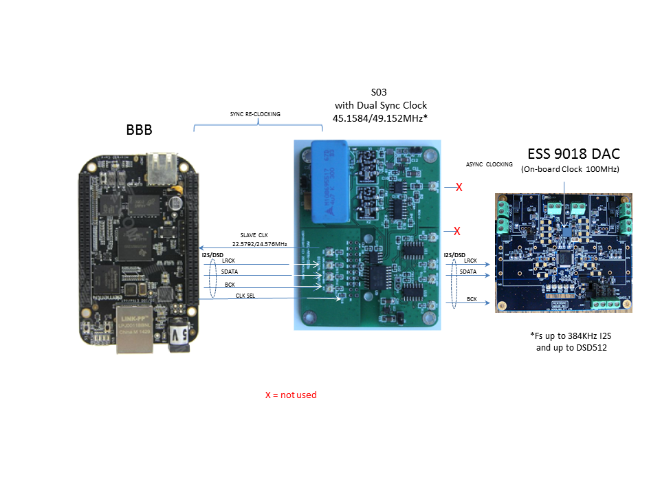

I studied the AKL-S03 Digital Isolator/Re-clocker PDF you sent me but it mainly seemed to revolve around using the reclocker with a BBB or Rpi, which I'm not using.
As I will be connecting the Amanero to the BIIISE via your Reclocker I will have to connect the Reclocker MCK (adjacent to R1) to the BIIISE EXT_MCK input and for that to work I understand I have to disable the BIIISE clock by cutting off it's power supply, but if I do that the coax SPDIF input's wont work.
With the coax SPDIF it's unusual for me to play anything over 96khz but with the Amanero I was wanting it to play DSD & right up to the 384khz PCM.
Is there another APP Note I should read.

The concept is the same, just replace BBB with Amanero or any other compatible sources. See pics for the possible connections. In both cases spdif can be handled the same way as you are currently using. No need to switch clocks between I2S and Spdif operation. Since S03 clock for your build is 50M the Fs max for Spdif in the "Sync Mode" setup will be limited to 96kHz

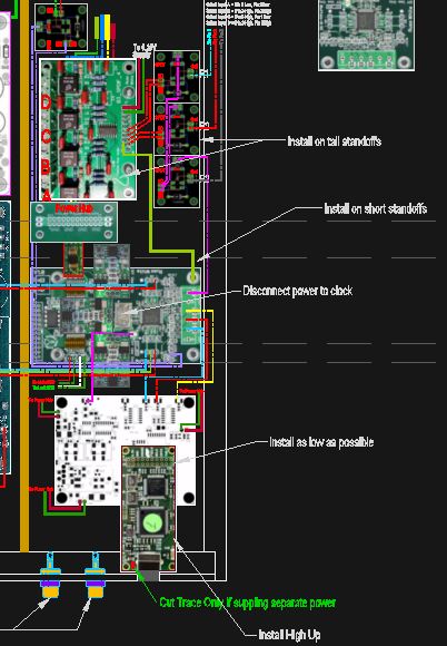

Well this is my plan;
I assume the power for the Amanero side of the isolator will be supplied by the Amanero, or do I need a separate supply?

I haven't tried powering the Amanero separately but guess there will be not much difference since all gets isolated and reclocked on the clean side.
Mounting Amanero on the S03 is fine but I would think it is best to try out by simply wiring-in initially. This also gives the option to suspend the S03 as indicated here =>
Try separate power supply anyway. But try decent one with dedicated ftransformer. For me there is a difference. And don't forget to cut pcb wire.Excellent![]()
In my two previous DAC's I've done just that and run the power through a very good regulator but have not compared that setup to just powering via the PC
