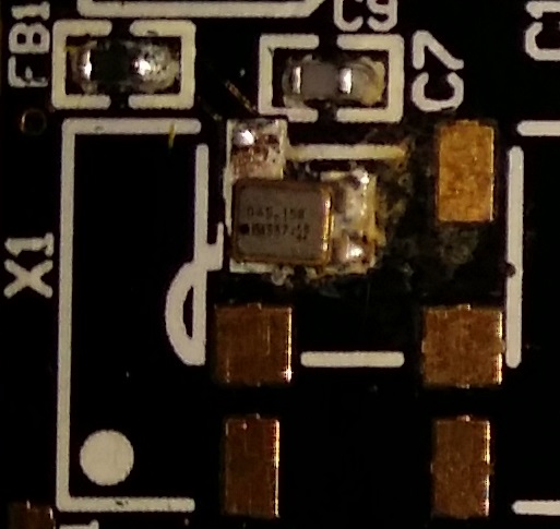

It's major PITA to solder but you got it right.Sorry for stupid question, but can anyone confirm if I got the orientation of the NDK clock correct? Thought I had it figured out, then not so sure😕

almost done
I have done the smt parts. Used paste and toaster oven. Came out pretty good for a first effort. Too much paste resulted in a couple of solder bridges that I have to fix. Clock PS has a bridge and a short to sort out. Overall I have continuity in all the right places.
So, did you finished soldering s03?
Turned out prety decent. Photo is not extremely detailed but I would double check pins on U1 ref. voltage. Also did you decide which capacitor for C4?
Agreed. Had a bridge. May still be shorted. For c4 I have the smt cap. If all works plan to put a 4.7u BG N ND a small one right on the pin as experiment. If it seems I have messed up ps too much my backup is to use a 3 pin rev by Ian Canada in place. It is optimized for clack and should be ok.
