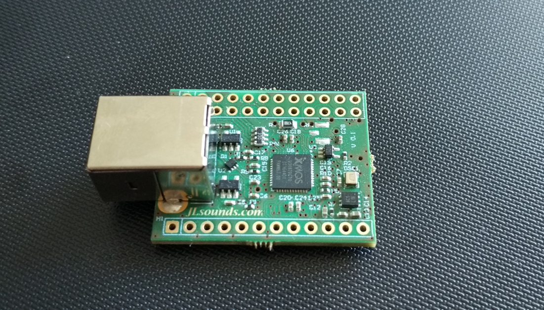

Alternative USB module
JLSounds has come up with nice modules.
Their oem module looks like a perfect match for the S03:
OEM board - I2S over USB Audio
Many thanks to Ray (Nautibuoy) for bringing this to my attention.
Also, the SDTrans384 is compatible
There are other similar products out there and the flexible interface of the S03 means you can hook up easily - just follow the wiring concepts.

Yes, this one is very convinient.JLSounds has come up with nice modules.
