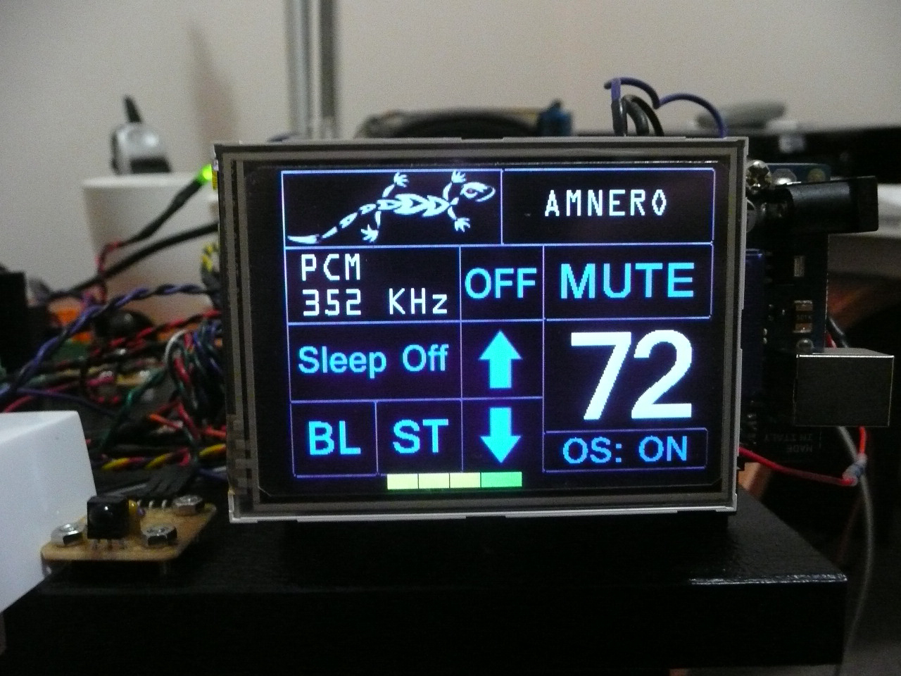

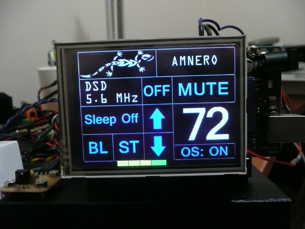

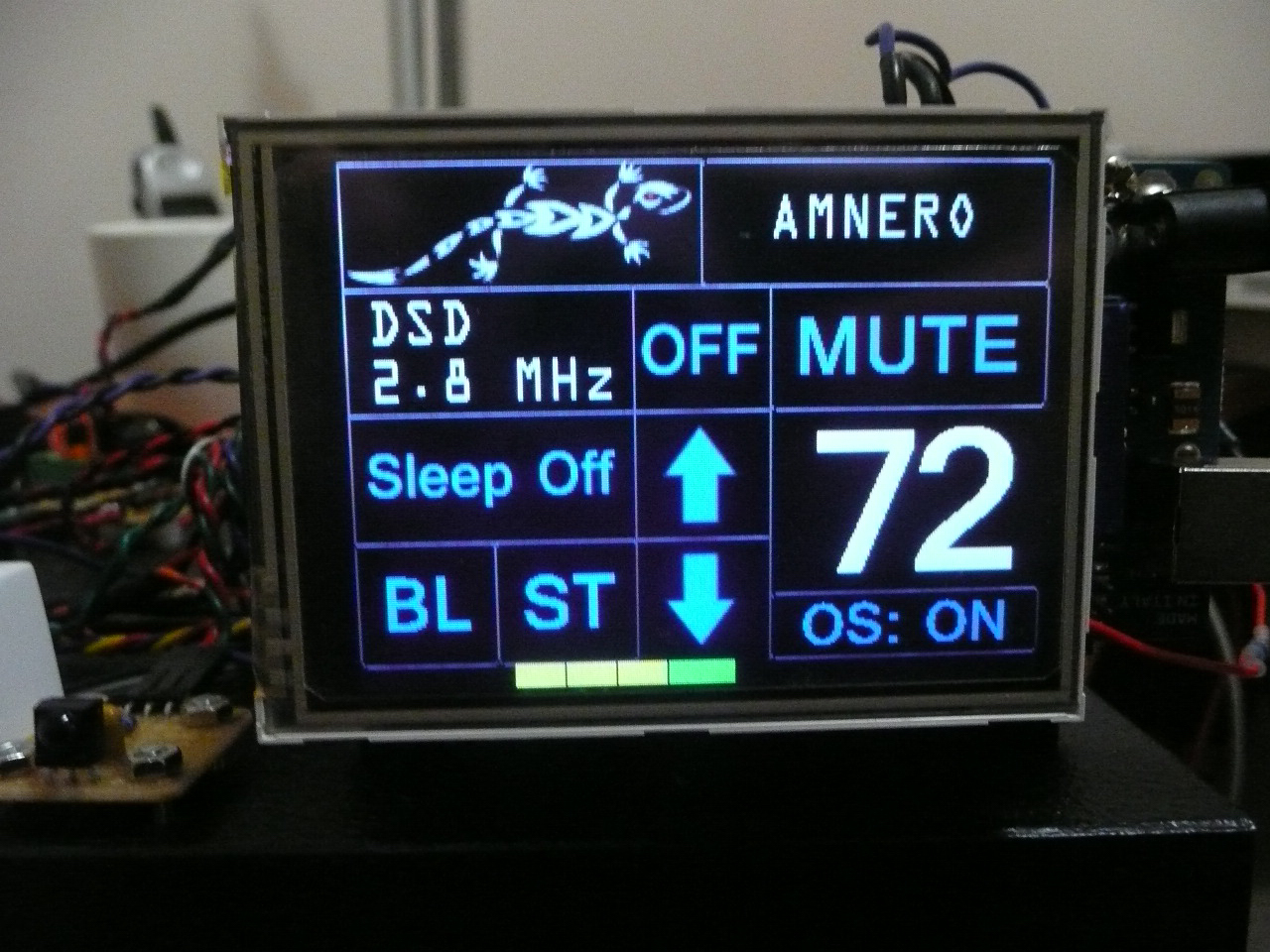

DSD64 -> DoP -> PCM 176k4
DSD128 -> DoP -> PCM 352k8
Thanks Clivem, much as I thought! I am sure the 9018 DAC will process and report as such.
there is no way this adapter board with allow DSD transmission on its output if the DSD led is not ON - so all PCM for DoP as processed by BBB/Botic and this is what the 9018 DAC will see and handle. In any case the de-encapsulation of DoP to DSD should be done at the driver(Botic) side but this is not obviously happening from your test resultsI was under the impression that the ES9018 DAC chip identified and de-encapsulated DoP? Will check.
Ray
Again, I am trying to instigate here with my limited knowledge but I reckon this DoP stuff is mainly to allow DACs without DSD capability to play 'DSD' music. For the average Joe using a lifestyle AV system this does not really matter as it plays everything but for us looking for the ultra pure capabilty of native DSD, DoP will not cut!
The challenge here now is for an end point display to correctly resolve PCM, DSD and DoP music.
Like this?
Like this?
Yes, exactly that but now we need to detect and display DoP also at the end point 🙂
