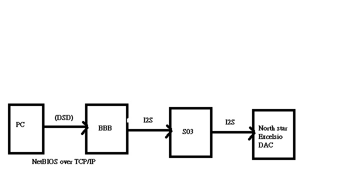

How do you know what the data is being transcoded to wav DoP if the data does not transcoded by USB?
Why does not stream native DSD files from Asset V5 to Botic if the data is being transcoded to DAC via I2S as the attached file?
Advanced I2S port of my DAC, North Star Design Excelsio ,supports PCM until 384-32 and native DSD

In my knowledge, it transmits a file between PC and BBB via TCP/IP, and this is not about streaming.
Is it like first copying a file to local disk on BBB and then playing it?
BBB receives a long stream of data from PC using the streaming protocol.
The streaming protocol — TCP/IP has a long stream of data that is transmitted from one end of the connection to the other end, and another long stream of data flowing in the opposite direction. The TCP/IP stack at one end is responsible for breaking the stream of data into packets and sending those packets, while the stack at the other end is responsible for reassembling the packets into a data stream using information in the packet headers.
Network streaming for LAN optimized protocols like DLNA, use UDP (connectionless) as supossed to TCP. TCP (connection oriented) uses things like, handshakes, sliding window mechanisme/error detection to "garantee" delivery, which creates additional latency etc, which is not what you want when streaming media. USB has much less overheads as it's designed for point-2-point & short distance. The BBB will buffer data going from Ethernet to USB, there is inherent latency here in the order of a few ms minimum. MPD and sorts will allow for manually setting bigger play-out buffer sizes to counteract upstream (network) latency and such..
