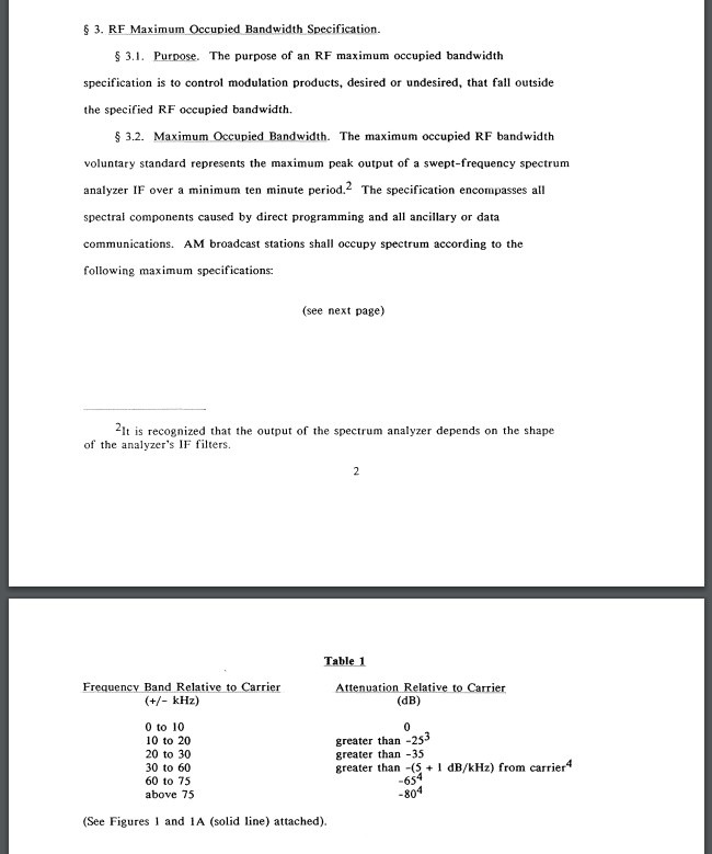

Likewise. Page 2 of NRSC-2 under "RF Maximum Occupied Bandwidth Specification". +/- 10 kHz deviation from carrier at 0 dB attenuation relative to carrier. 20 kHz total occupied bandwidth, 10 kHz audio bandwidth. Out-of-band attenuation table also included below.I am talking about Classical Amplitude Modulation
