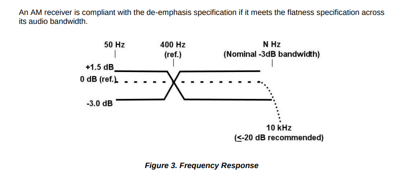

As an example Heathkit's 1950s BC1A receiver is capable of at least double that with a 10 kHz notch. Every Canadian AM in my professional experience broadcasts to 10 kHz with the one exception of a station with a first adjacency 10 kHz away.
I think you are mixing audio bandwidth with channel separation.
AM Audio bandwidth (musical program we hear and what we are talking here) is 5kHz, channel separation/RF bandwidth is 10 kHz.
Not the same, sadly same word is used for both.

Could be, but that remark about audio bandwidth and output transformers came right in the middle of a discussion about the 2 kHz audio bandwidth of modern AM receivers.
Not in North America. It's 10 kHz with an emphasis/de-emphasis curve receiver manufacturers with few exceptions ignore.
https://www.nrscstandards.org/standards-and-guidelines/documents/standards/nrsc-1-c.pdf
Interesting, I have worked on radios for years without knowing that there was a voluntary AM emphasis-deemphasis standard. Do I understand correctly that this was introduced in 1988 or later to solve the dull sound of the AM radios that were then on the market?
Not surprising. The one tuner I believe implemented it was the Denon TU-680NAB from the early 1990s. Lack of a 10 kHz notch filter limits its nighttime utility unfortunately. No AM broadcaster to my knowledge doesn't adhere to the NRSC standard.
