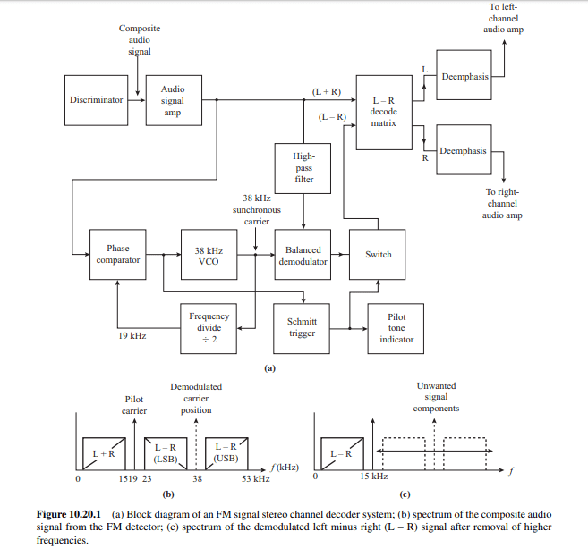

AM was the start, then Mono FM.
I remember my dad's separate optional FM tuner in his 1947 Magnavox. In the mid 50s and early 60s, a local station broadcast both AM and FM mono.
Occasionally the AM and FM was simulcast for music programs. There was even an AM IF bandwidth switch.
The FM broadcast was so very much better from the same music source than from the simulcast AM, whether live or recorded. No surprise here.
Some other station's clear channel broadcasts were very good too.
After 78s, along came 45s and 33 LPs; then LP stereo. Some got Stereo Tape recorders, and prerecorded 7-1/2 inch tapes.
The key was to enjoy the music, with the system you had at the time.
There were some improvements (3 steps forward, 2 steps back)
Stereo FM reduced the signal to noise, and had more Harm. and IM distortion, and also multi-path.
I never cared for 8 track, and did not like 1/8 inch cassette tapes.
CDs took off.
Then along came some early horrible MP3s, at a 15k sample rate, with brick wall fall-off at 7.5kHz.
