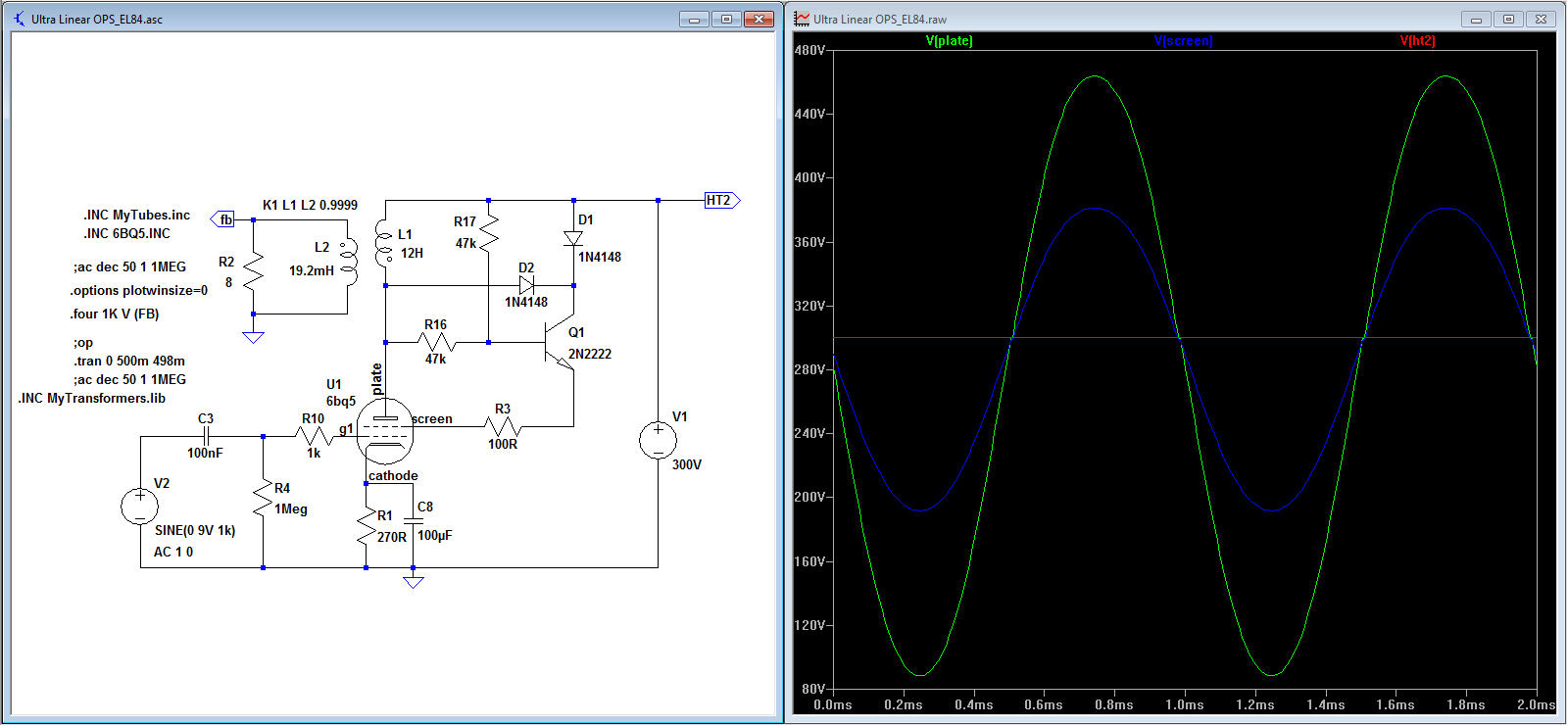

Diode in series with ultra-linear screen tap?
A certain Mr. Dennis R. Grimwood has some interesting comments about operation of tetrode and pentode output stages on his website.
In particular, he states here:
Further, regarding ultra-linear output stages in particular, he states:
Something about this configuration is off-putting to me, but I cannot put my finger on it. Has anyone tried it? Is there anything about it that would cause issues, in theory? Thanks!

By inserting a standard half-wave silicon rectifier diode in series with the Grid Stopper resistor, an electronic control circuit is created whereby the Screen Grid will be able to be energised at DC potential attracting and accelerating electrons towards the Plate - still electrostatically controlling current flow in the normal way - but blocking the flow of AC current from the Screen Grid back to the DC source - ie "one way traffic" [...] Thus then there is no output circuit formed between the Screen-grid and the load so no current can flow in the usual direction. [...] This arrangement offers huge benefits, because it prevents the Screen Grids from collecting electrons - thereby diverting all the signal output to the Plates, increasing tube efficiency, reducing distortion and increasing frequency response, as well as eliminating the usual effects [of] changes in Screen Grid voltage on Plate Current - therefore improving transient response.
[This technique] is very helpful in ultra-linear connection. AC signal output voltage from the Screen-Grids is prevented from conducting through to the output transformer, which means that the ultra-linear output stage operates as a negative feedback system only - ie Plate voltage is fed back to the Screen Grids via the transformer taps but not the other way around. This method ensures all the electron flow goes to the Plates, with all the advantages described previously.

No need for an external series diode since you already have one there: the screen IS an anode, relative to the cathode, and current can flow one way only, no matter what.

Not such an AC current, and definitely NO current flow from screen towards the DC supply.
I think the idea was that it would prevent the flow of electrons absorbed by the screen to the DC supply, which is situated at AC ground (bypassed to ground with capacitor). Since the screen is an anode, it does absorb a portion of the electron stream from cathode to plate, dissipating a portion of the total current flowing in the tube. This does make some sense to me; perhaps I am misunderstanding where that current goes?
The AC component of screen grid current is added to a DC component that keeps the sum always positive. So putting a (conducting) diode in series does none of the things claimed, except drop 0.6V.
Besides...., getting the AC component of screen current back into the OT -IS- most helpful, just that it needs to go to the 100% plate tap instead of the UL tap for best distortion reduction.
There is one scenario where the series screen grid diode may be helpful. When the screen grid becomes overloaded sufficiently to cause the grid wires to glow (ie, from extended maximum signal output) the diode prevents the screen grid from thermionically emitting electrons to the plate when the plate swings to 2 x B+. (so preventing instant tube melt-down). No sonic benefits however, except continued operation.
That makes sense. Thanks!

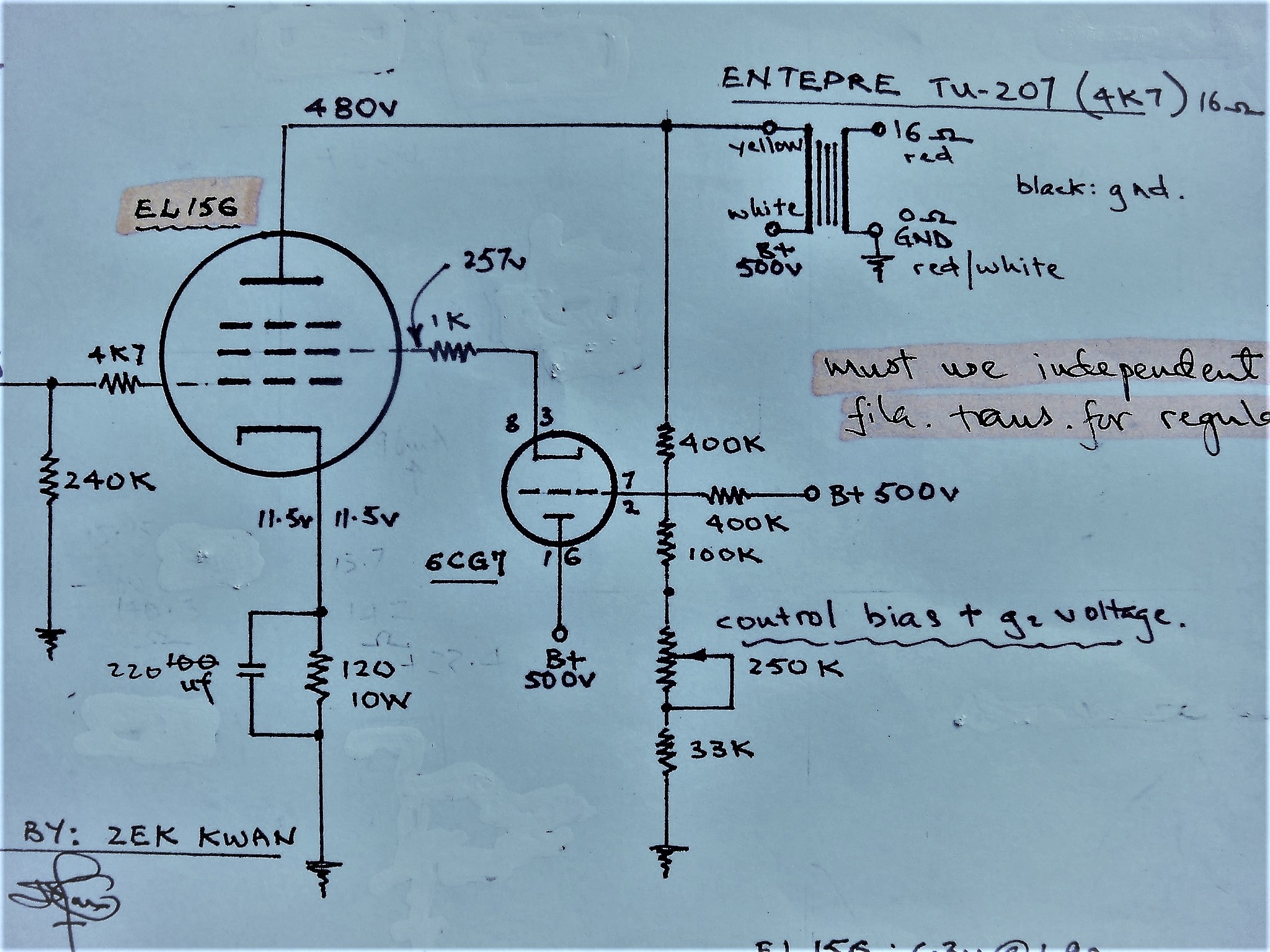

It is clearly related to UL mode, but has some differences in detail. More like what would be seen for "UL" mode with a TV Sweep tube (low Vg2 rating). The screen voltage is being kept below the plate voltage by the divider resistor chain, and the screen current is not being returned to the OT at either a UL tap or the plate tap like tapped UL. The cathode follower tube buffers the divider from screen current pulling of the divider voltage, but by using a triode for the buffer, it cannot return current to the OT due to minimum voltage limitations of the triode's operation. A Mosfet follower might be able to do that, depending on the setting ratio of the R divider.
Odd to see this for an EL156, since it has a 450V rating for Vg2. Maybe just used because the OT did not have a UL tap.
To a newbie, it's all about experimental and the satisfaction one gets when it works regardless, is a joy! No idea if that's odd or not, but was trying to runs it in ClassA where g2 is 280v@17mA.
