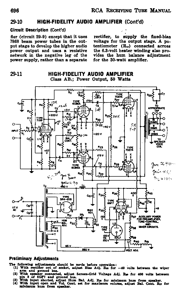

For someone who is stuck with an OT with no UL tap, I would just use an LTP -triode- driver stage (could be a pentode on the actual drive side for more loop gain), with N Fdbk from the output tube plate back to the unused LTP triode plate. So using the inverse Mu of the LTP triode as the N Fdbk attenuator. That makes the output tube (presumably a pentode) into a power triode with the Mu of the driver tube and the -full- power of the pentode tube. (unlike UL)
For P-P one would use a pentode LTP driver with the N Fdbks taken back to the screens (via R dividers) of the LTP. (and crossed over for phase) The driver pentode tubes then need to be quite linear (when tested in triode mode). And the N Fdbk needs to be scaled so that the screens draw current proportional to screen V (driver Vscrn proportional to driver Vplate, so looking like resistive loads). Otherwise Mosfet followers are needed for the screens.

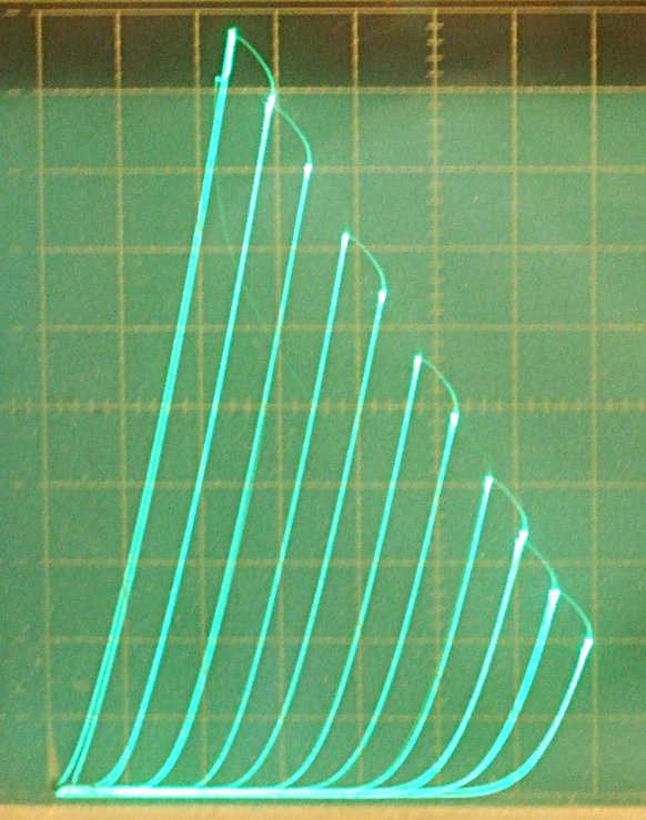

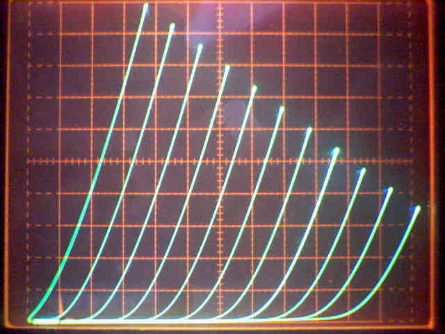

Best (most linear) pentode driver tube (in triode) I have seen is the 12HL7, Mu 25 to 30 depending on brand (curves below for a selected 12HL7, frame grid tubes must be curve tracer selected) ( Easily outclassing a 300B using just $4 TV sweep tubes for the outputs ) An alternative driver is the direct heater 1E7G, Mu 10 (2nd curves below)
Alternatively, the P-P N Fdbks can be taken back to the driver cathodes, similar to the RCA 50 Watt handbook amplifier (the shunt "Schade" loops optional). No longer any pretension of emulating power triodes for the outputs then, just high "local" (no OT in loop) N-Fdbk.
