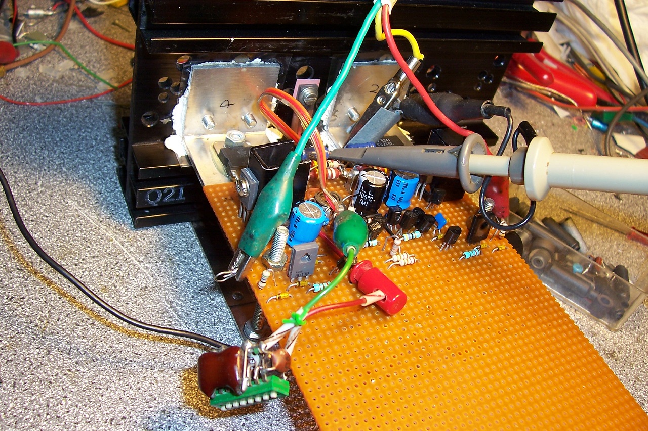

I have begun some tests on a real prototype.
There are some discrepancies compared with the sim, essentially stability/compensation issues, but the first results look promising.
Most of the transistor types are different though, which could be an explanation.
By somewhat increasing the compensation caps, I can get a clean squarewave.
Linearity assessment will be a difficult task and will require some creativity. It could be some time before I can report results on that aspect.

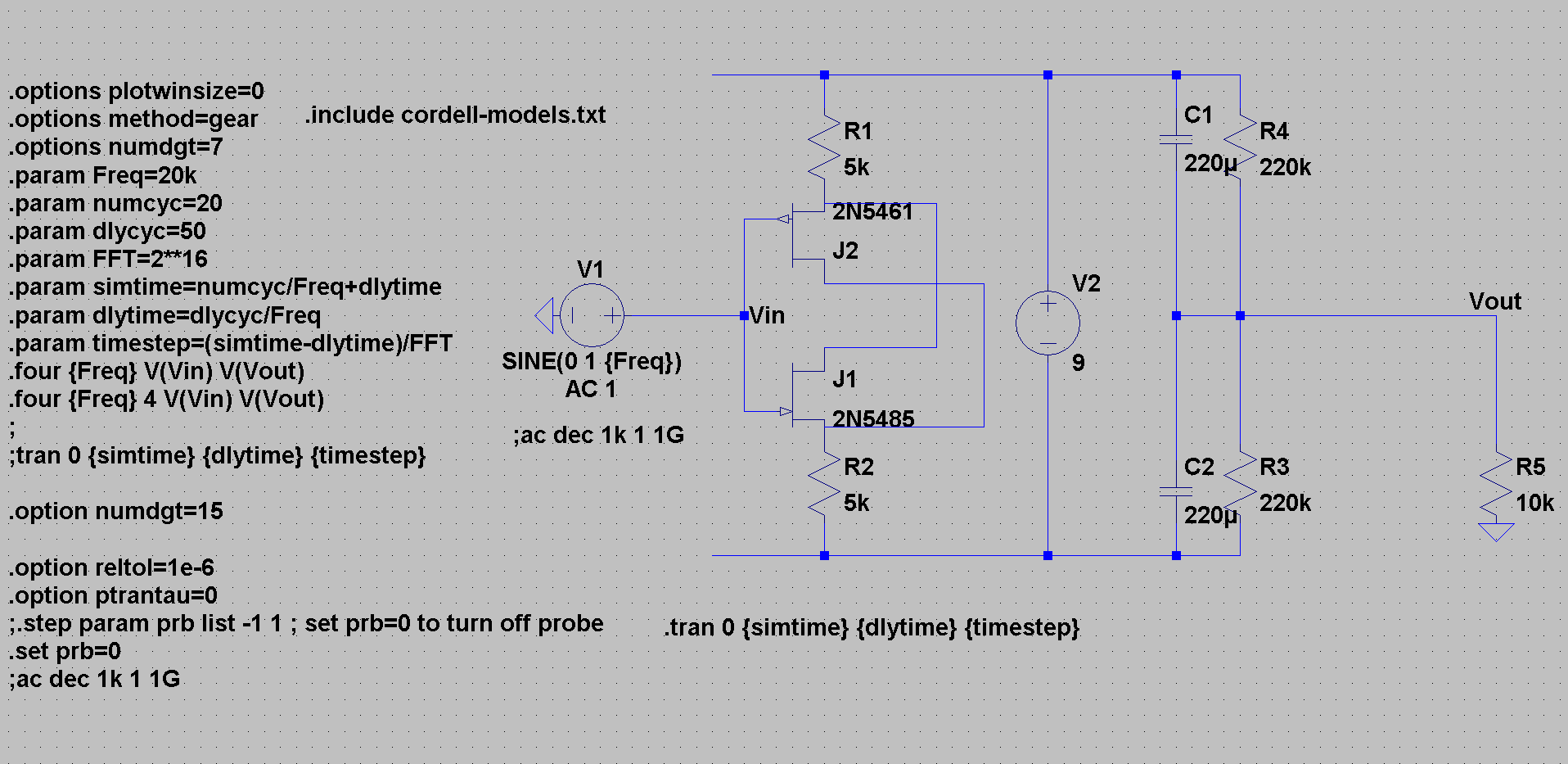

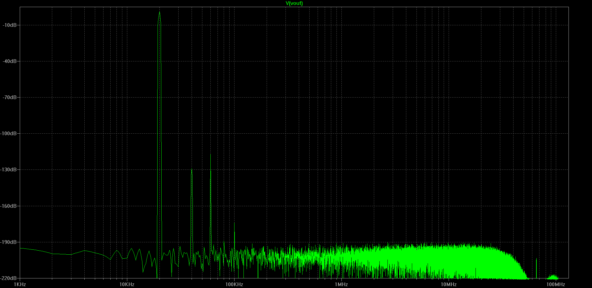

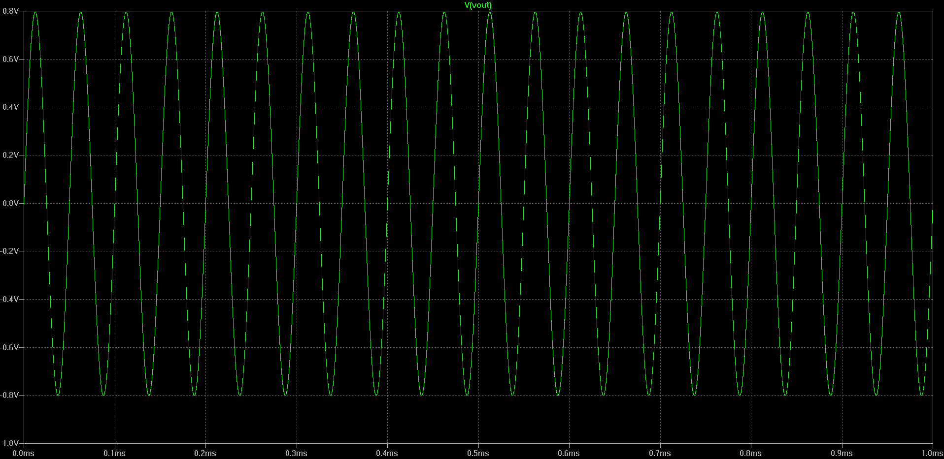

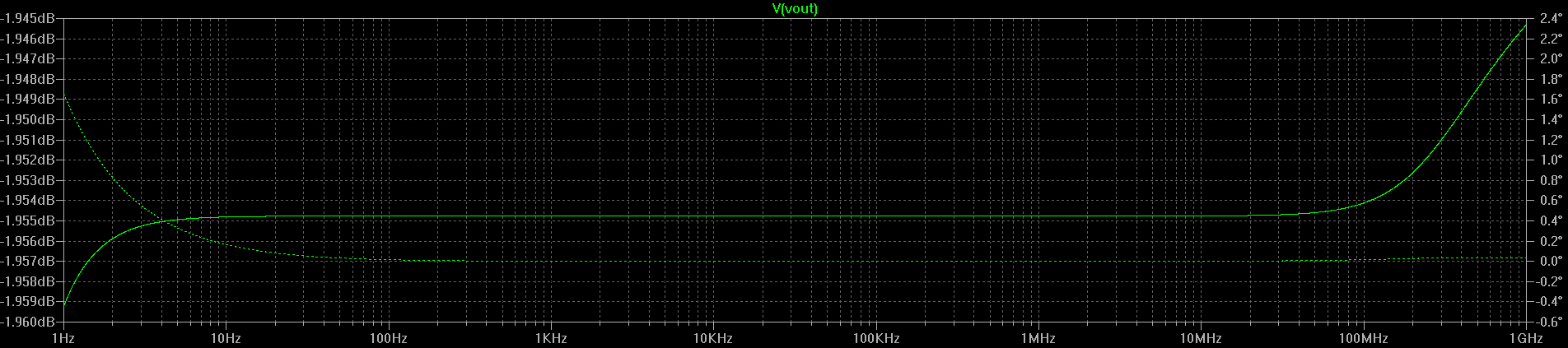

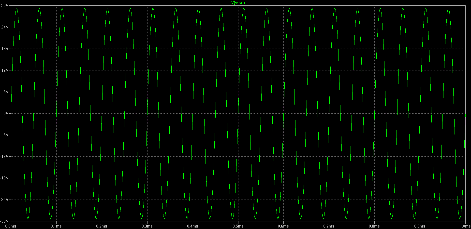

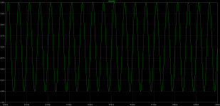

guitar/line buffer proposition
Hi
this time I have the idea of small signal pp source follower buffer with floating power supply.
the results are for 1Vpp at the input, the load is 10k.
for guitar the loads are much higher, 220k-10Meg which means lower distortion.
the circuit is easy for mounting inside the guitar together with the battery.
remember about hf blocking circuits.
  • inv foll guit buff jfet.asc
Hi

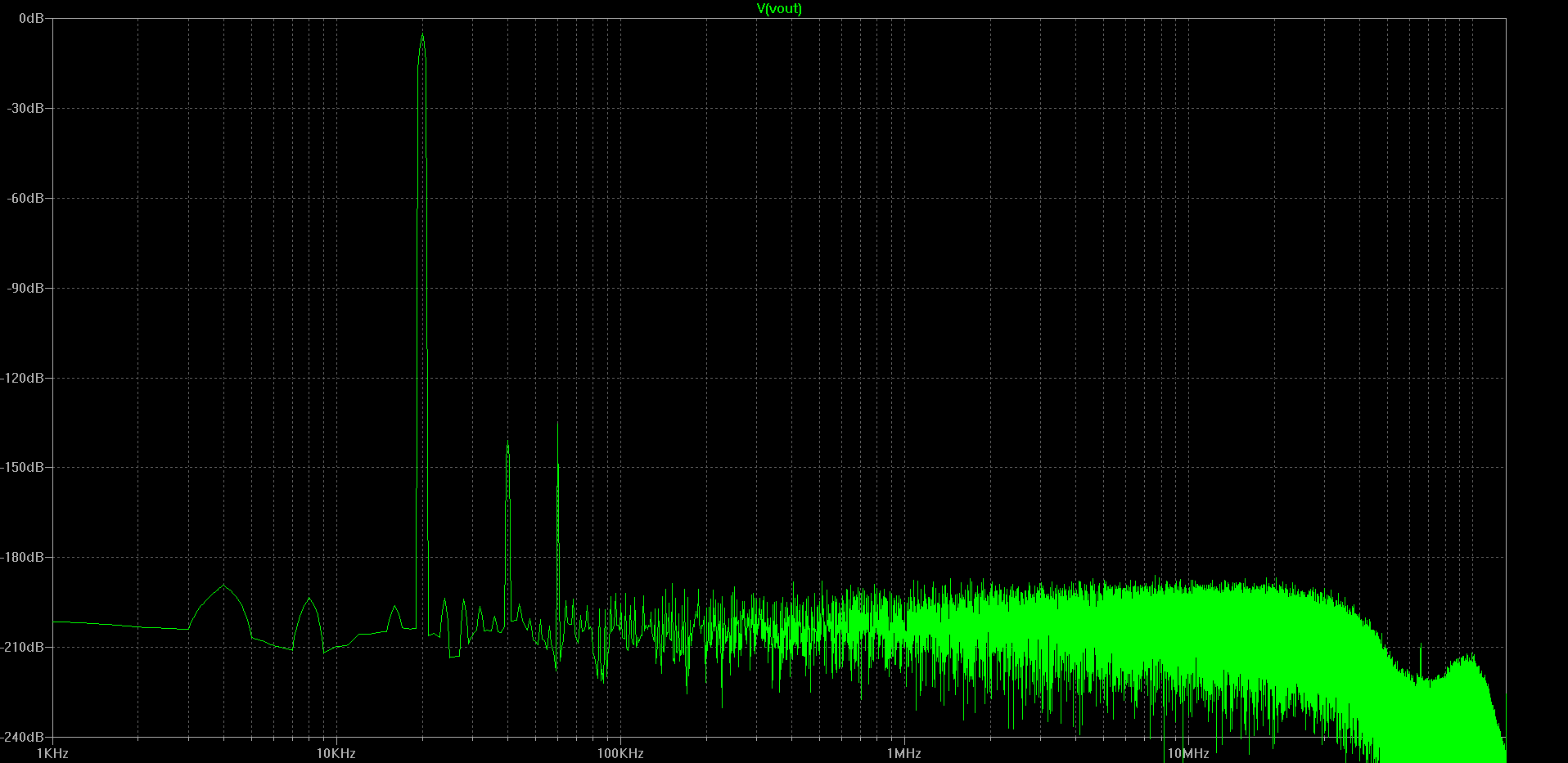

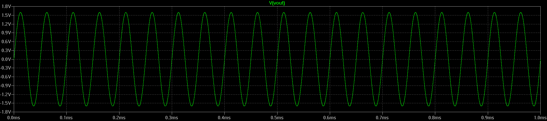

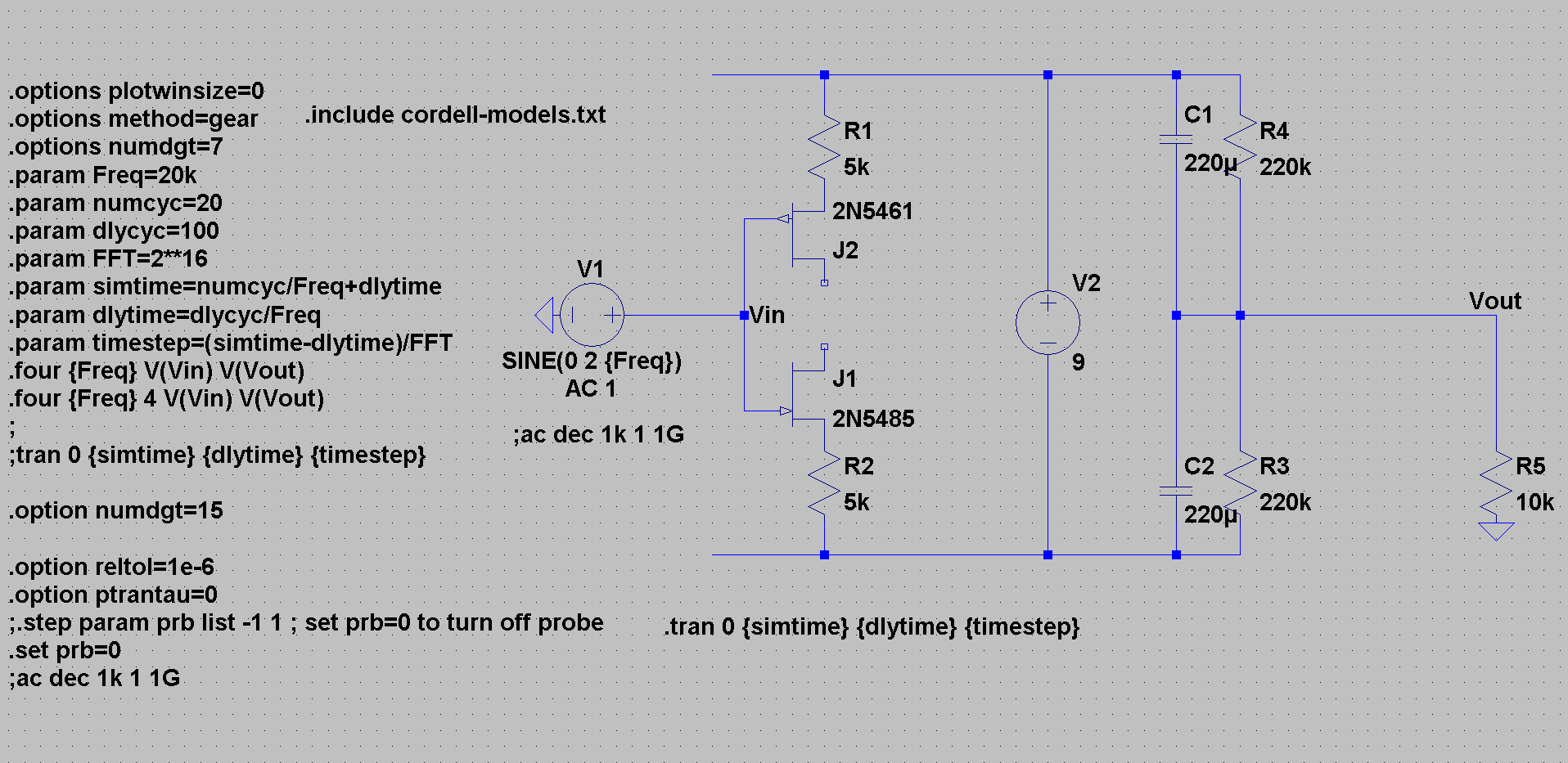

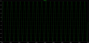

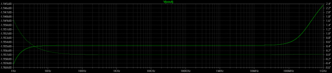

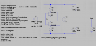

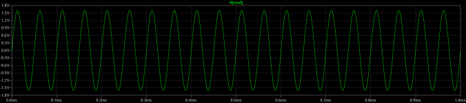

to be clear:
this probably cannot be true: it works without drains connection, anybody could explain?:
Harmonic Frequency Fourier Normalized Phase Normalized
Number [Hz] Component Component [degree] Phase [deg]
1 2.000e+04 1.597e+00 1.000e+00 0.00° 0.00°
2 4.000e+04 5.066e-07 3.172e-07 89.96° 89.96°
3 6.000e+04 1.912e-06 1.197e-06 -0.01° -0.01°
4 8.000e+04 6.322e-10 3.959e-10 -70.72° -70.72°
5 1.000e+05 2.499e-09 1.565e-09 175.66° 175.66°
6 1.200e+05 7.395e-10 4.631e-10 79.83° 79.83°
7 1.400e+05 5.937e-10 3.718e-10 -60.34° -60.34°
8 1.600e+05 2.264e-10 1.418e-10 109.61° 109.61°
9 1.800e+05 7.347e-10 4.601e-10 -126.81° -126.81°
Total Harmonic Distortion: 0.000124%

to be clear:
Quite simple:
The main quality of this circuit is its wire-like behavior;unfortunately, it is also its main deficiency....
When I said that, I actually meant it: there is no way power can be taken from the DC source and be transferred to the load.
This means that all of the load current is supplied by the input source: in short, it buffers nothing, and the role of the DC supply is to forward-bias the gate junctions of the FETs.
I thought it was immediately apparent, but it seems it wasn't after all....
Quite simple:
Elvee
you are great:cheers:
