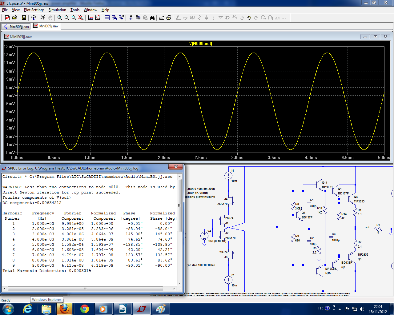

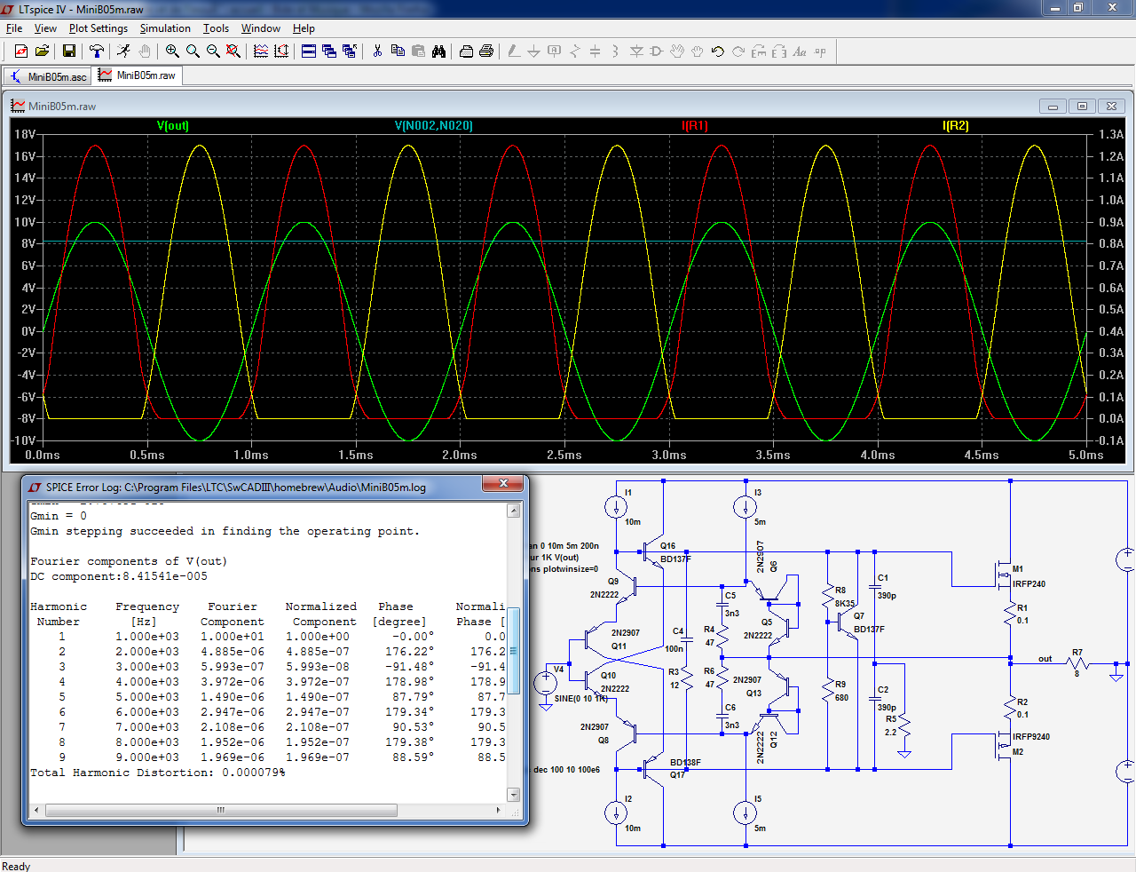

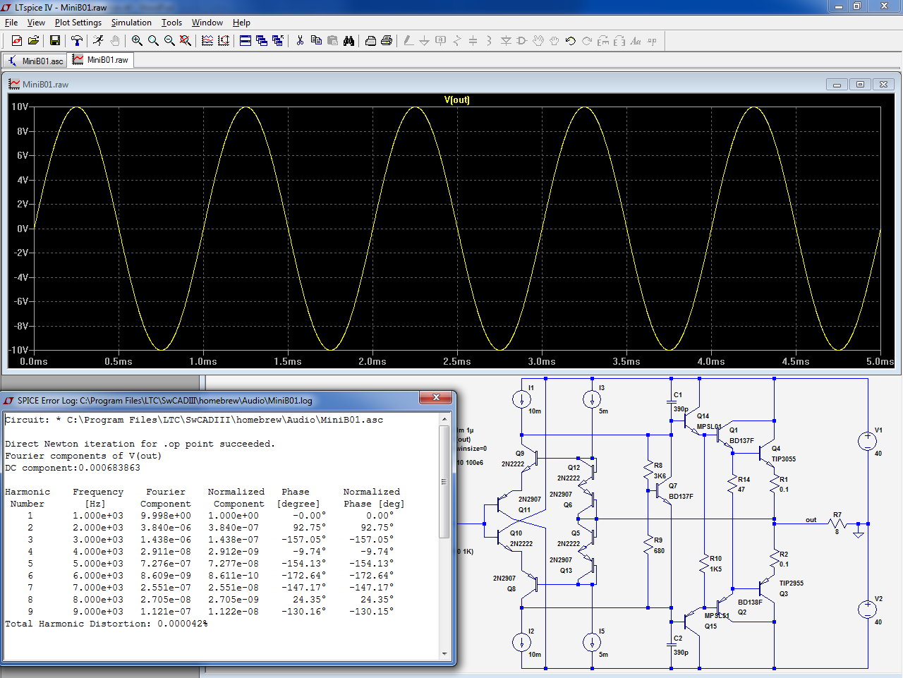

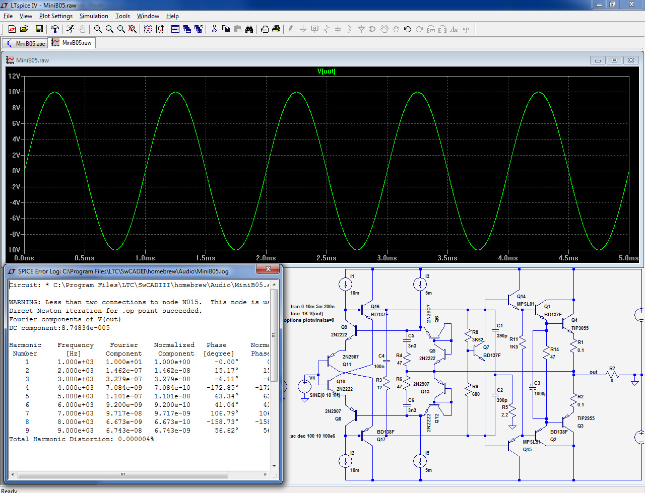

Elvee, we clearly both have been busy over the past month and work on this came to a hold on my side during that time. I'd like to proceed however and discuss an earlier design of yours: the same circuit using BJT's. Mind to take a look at some of the progress I made last week?
Don't expect design revolutions of some sort, I'm building on your earlier work.

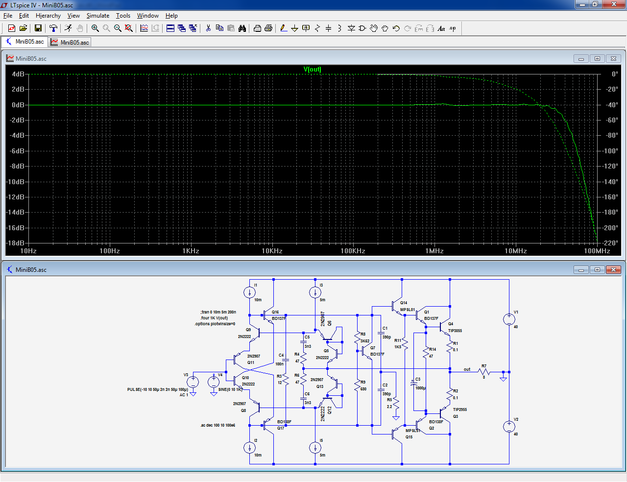

The attached design seems to be stable and fast, although I'm far from 500 V/uS. -3 dB bandwidth is approx. 3.5 mHz. With the 1K input potmeter turned all the way up that is. Input impedance could probably be improved, but is high enough for my application.
Not sure about how to further improve the design. Seems pretty good as it is right now, though it lacks a limiter for input voltage/clip warning and over current protection for the output transistors. I've seen some designs for all, but there seems to be quite some debate about it. Need to read more on that.
What bothers me most right now, is that I can't control the DC offset. Is there any way I can? Should I match on each side of the rail to minimise offset?
Anyway, I made some PCB designs, based on the Nmos350 layout. I borrowed Quasi's DC protection. Why this layout? I can't find complaints about it and it seems to meet general rules about PCB design. Moreover, it can be mounted on an 2U heatsink. Ccs transistors are coupled thermally by a 25 mm wide aluminium u-profile. Suggestions welcome as always!

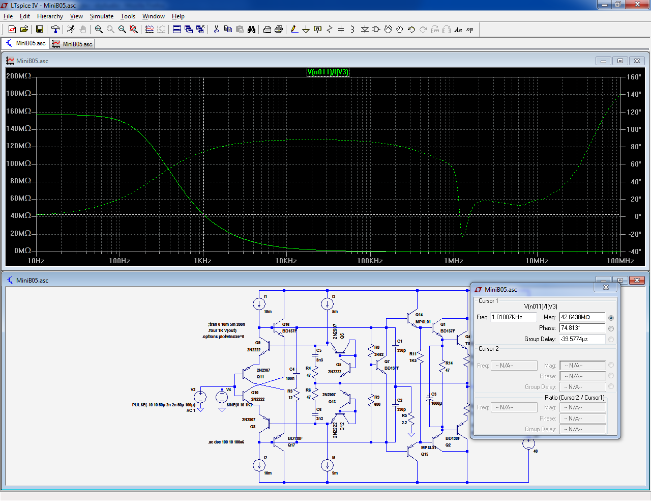

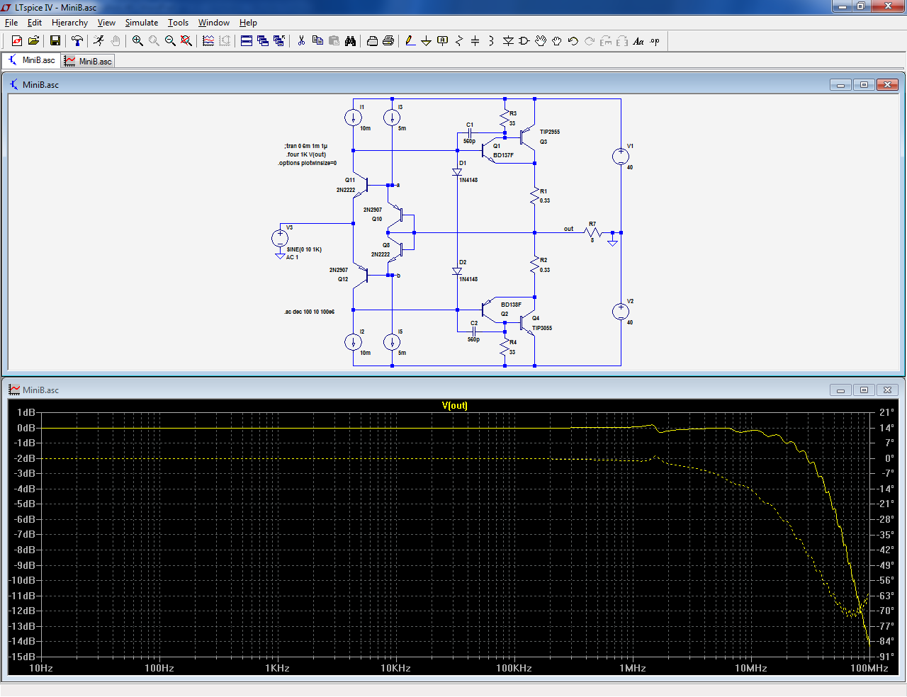

500V/µs is a nice figure, but it is not actually needed, and it would probably bring more problems than benefits.
You seem to have arrived at a perfect tradeoff with 150V/µs, which should be ample enough
Since the clipping behavior is very clean, I don't think a limiter is required.
A clip warning should be relatively easy to add, standard schemes should work here.
For the Circlophone, I have described such a circuit that could probably be adapted here.
You could add a protection, the topology allows it, but it is also a field where difficult choices are to be made: ensuring a completely bullet-proof protection without intruding into the normal operation of the amp is quite difficult.
Perhaps some form of latching protection: it is brutal, but at least it spares you the loop stability issues when the protection becomes active
The offset shouldn't be a problem in practice: it will be intrisically good thanks to the mock translinear loops formed by Q11,9,6,5 and Q8,10,12,13.
All these transistors compensate each other and the vertical symetry provides a second layer of compensation, which means that even without any matching you will be under 10mV. Much less if you care to match them or use transistor arrays.

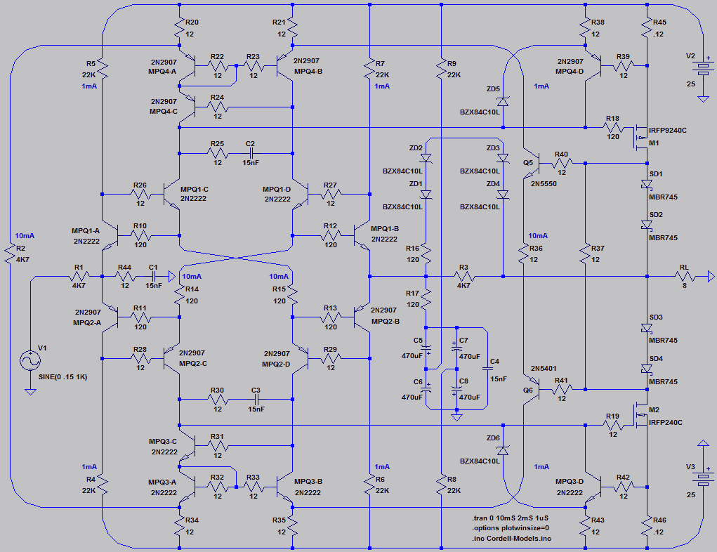

This looks like an excellent and robust design

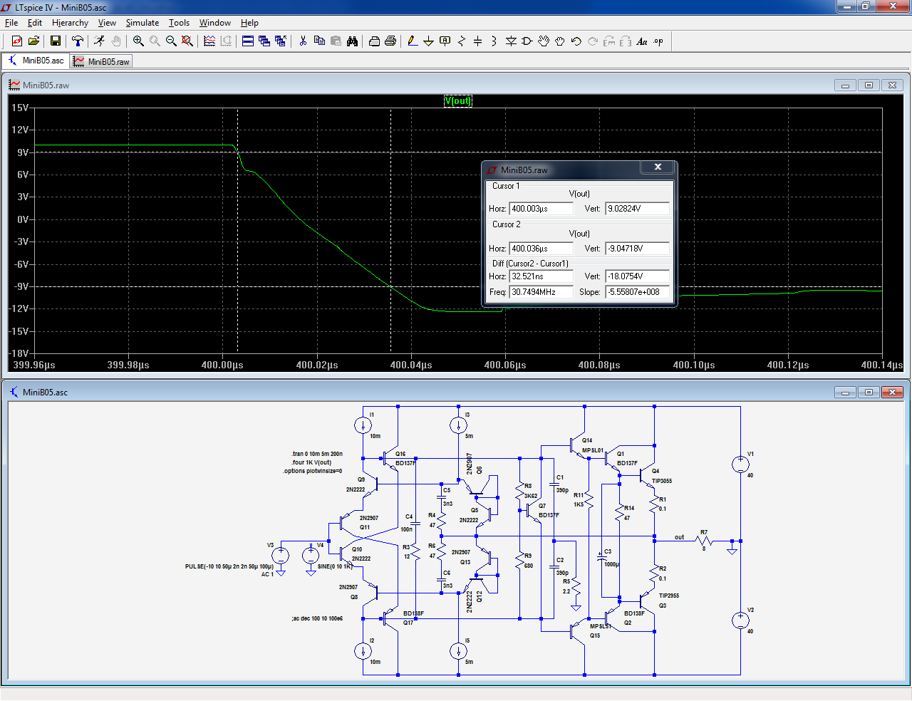

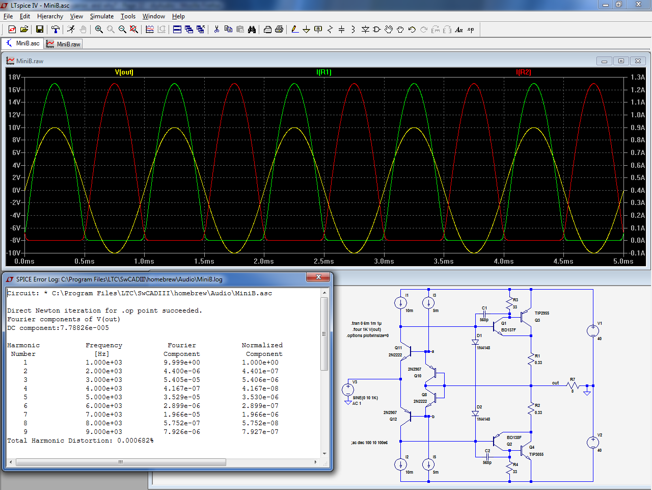

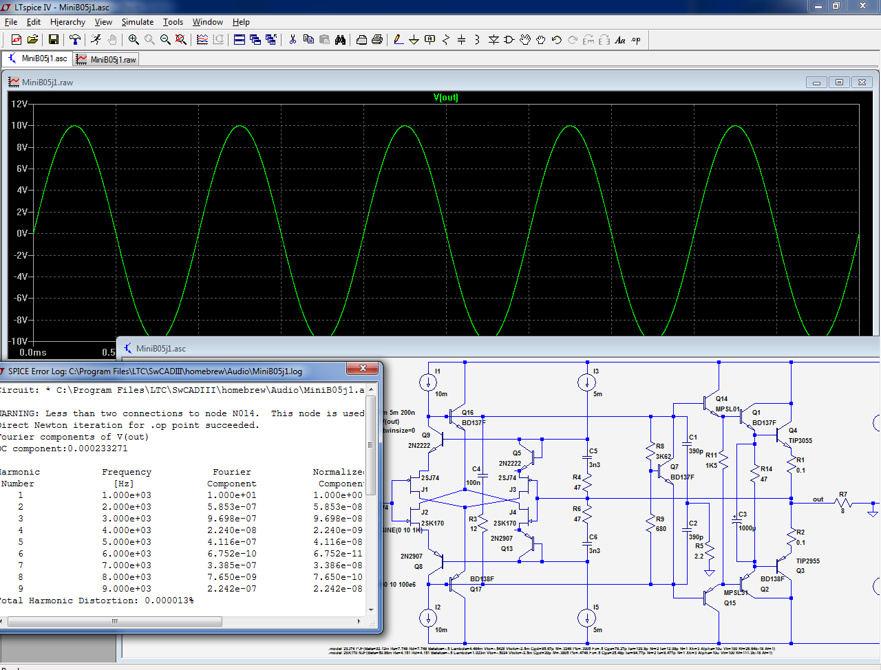

I noticed the slew rate is asymmetric. Is that normal? d(V(out)) shows the positive side being twice as fast as the negative side. Overshoot on larger signal swings confirms this.
I wrestled through most of the Circlophone topics entirely. I saw more clipping circuits; at the input and output, using zeners and/or ldr/leds. One of them seemed to compare input to output at the LTP. Not sure how that would apply in this buffer. Any leads of me on this?
About the DC offset again: if I insert a coupling cap between source and input of the buffer, DC offset is way of. I'm not sure yet if I want a high voltage coupling cap (can be safer if the source - a tube guitar amp at full power through a load - fails because of a faulty output transformer), but it seems good measure.
Design wise this seems like a go from your part. I intend to use a 2x35V PSU of 200VA with 10.000uF per side. Should be sufficient for 100 Watts if I'm not mistaken. Will maybe swap the BD139/140's for MJE340/350. Can't find Philips parts for a reasonable price even in Holland and the MJE's seem to work evenly well.
Since the circuit is completely symetrical, any difference between + and - behavior is entirely caused by different parameters of the P and N transistors chosen.
Some complementary pairs will be better than others in this respect, and low power/drivers pairs could be selected to have a behavior inverse of the OP.
